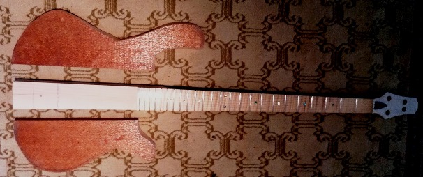

I'm building the bass for a friend, he's a Vic Wooten fan and loves to slap so this is tailored for that.
Neck - 24 fret 14" radius medium jumbo frets hard rock maple w/ flame maple fretboard
Body . Flame maple top and back lacewood / curly douglas fir core
Pickups EMG "Vic Wooten" set
Gold HW

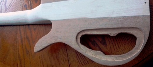

top on and routed
top on and routed
control cavity
control cavity
asymmetric heel
asymmetric heel

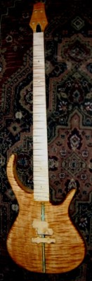

James Tonguet
Posts: 121
Joined: Thu Jul 19, 2012 1:13 pm
Location: Duluth,Ga
Re: Flame Maple bass
Post by James Tonguet »
so far no , the lacewood core is lightweight.
applied some vintage lemonade stain to bring out the figure, I"ll be backsanding the top to get back to a more natural look
James Tonguet
Posts: 121
Location: Duluth,Ga
finished the stain, back sanded .. (shown wet) I'm pleased

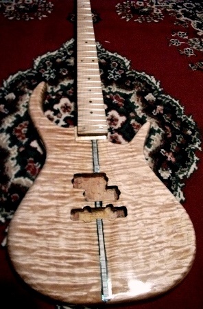

fitted the flame maple headstock overlay , and added curly maple/ paua abalone inlay to accent the neck dots and knobs

James Tonguet
Posts: 121
Location: Duluth,Ga
6 coats of french polish , sanded down to 600 (wet/dry) then 4 coats of lacquer , 1 more round before the buff out

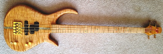

James Tonguet
Posts: 121
Location: Duluth,Ga
Finally finished , put on the 24K gold plated Optima strings and wired it up , beautiful crystal clear tone.
Volume/Volume / Master Tone all stock EMG per request.
all done
all done

PS , in regards to the neck , I plane the body portion to allow for the top thickness . on some instruments the back may get the same treatment
