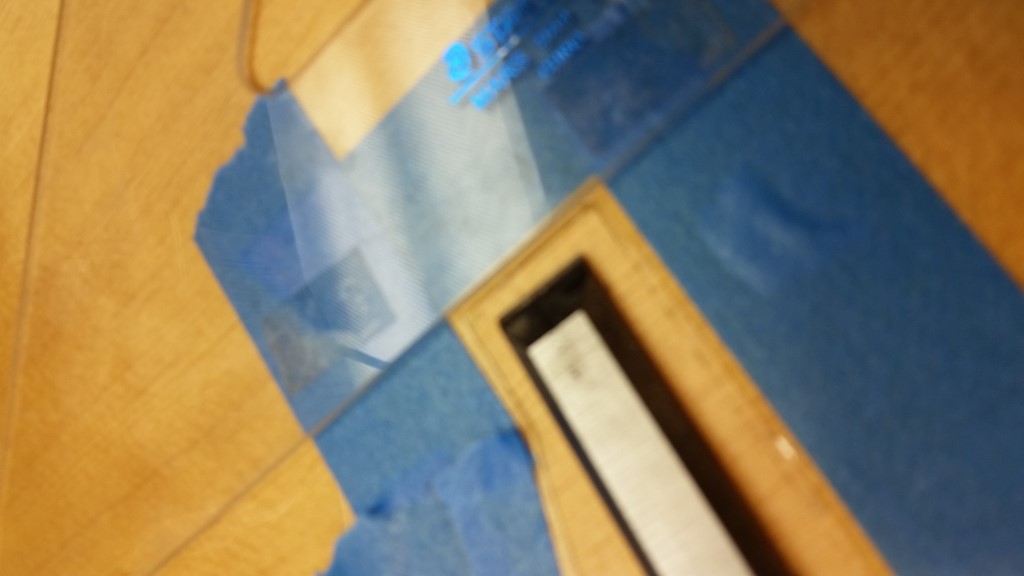

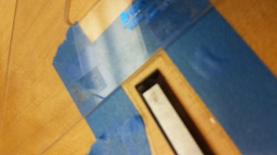

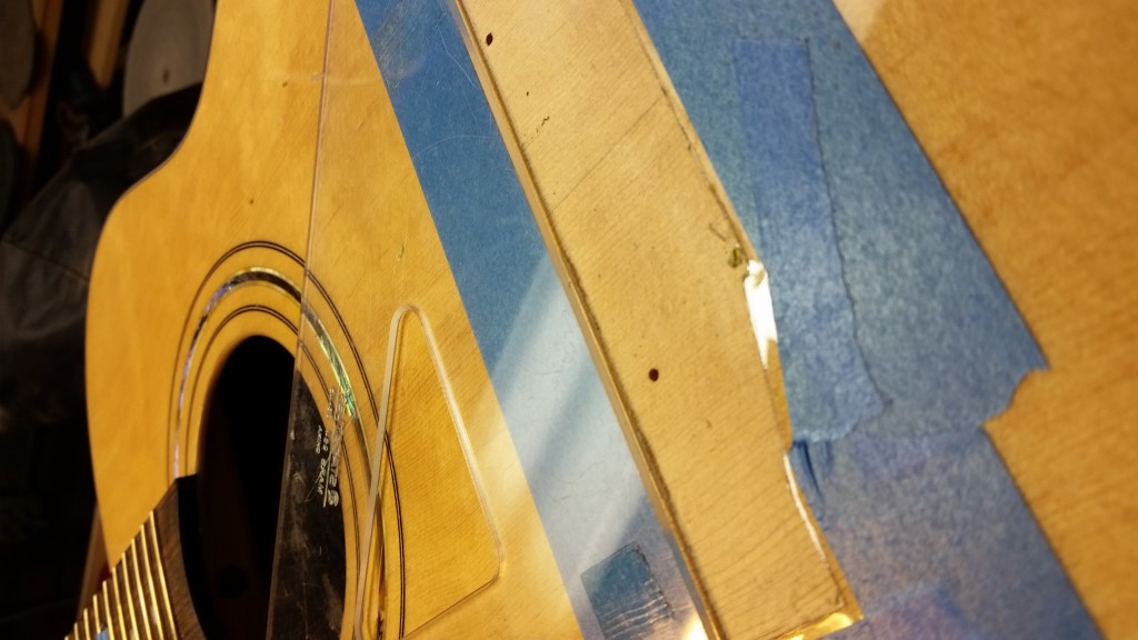

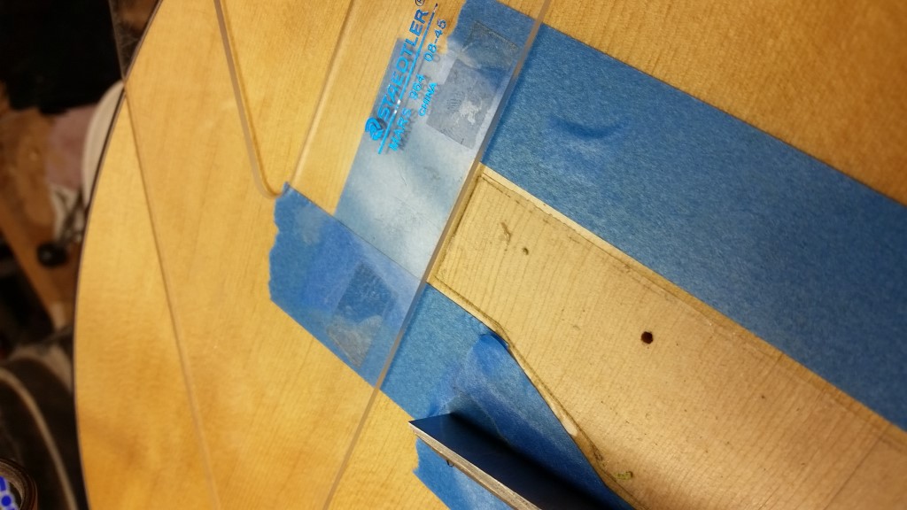

I have always had trouble scoring em6000 lacquer without chipping it badly or wandering all over the place.
Always wanted to get closer to the actual bridge outline but was afraid to do so.
I tried something different this time and got good success.
I tried using some blue tape around the outline and some thin fastcap double stick tape (very very thin double sided tape) to hold a plastic draftsman's triangle. Worked great. the draftsman's triangle seemst to keep the lacquer from pulling up.
Also got a bent chisel from woodcraft which made the chiseling of the cut lacquer go well.

Maybe do the router thing at another time. I only build 3 guitars a year and this last technique I used produced no marking of the wood while scoring the lacquer. I actually don't score the lacquer very deep and it still pulls off fine with the tape.
Have built about 15 so far and still learning, learning, learning but seem to be improving. I don't do it for a living and don't plan to so I can do anything however I want to and can listed to myself as well as you more experienced luthiers. It has to be fun and engaging or I don't want to build instruments. If I try to adopt too many new techniques over too short a period of time I just make a mess. Also, simpler if better for me as I have said.
Thanks for all the discussion though. I find this forum helpful don't want it to be too helpful.

Re: cutting lacquer for gluing on a bridge
Mike is right.
You don't cut through the lacquer, you just score it well. The lacquer comes away at the score line when you peel up the tape.
Joel
