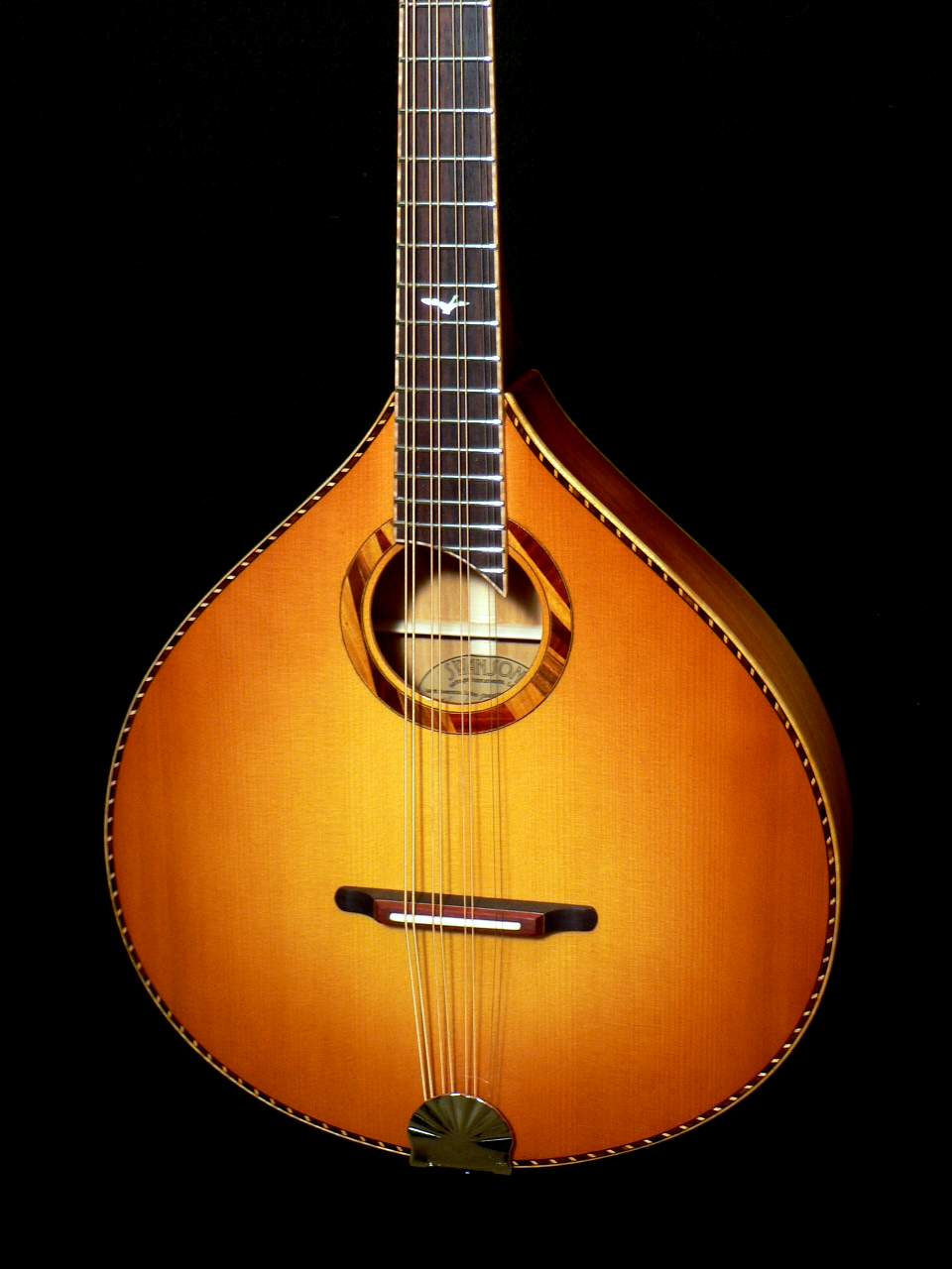

Hello Alan...yes, I build these and I use pickups that I make myself, but they are very much the same as commercially-made pickups of the undersaddle piezo type. So, you can use a regular guitar undersaddle pickup, get one that has a strip of material that is sensitive along its entire length- Baggs makes nice ones- and try to avoid a pickup element that has six sensitive spots on it for the six guitar strings because that won't line up very well with the bouzouki strings.
Now, this depends on the bridge you are using of course. I use a bridge with a slot routed in it for a bone saddle, just like a guitar has. If you use some kind of mandolin-type bridge then of course you can't use an undersaddle pickup because there is no saddle.
Then, if you have an undersaddle pickup, you need to get the wire from the pickup itself into the mandolin....I do it the same way a guitar does it, drill a hole right through the top. The only difference is the mandolin has a floating bridge, and the guitar has a fixed bridge but in reality the mandolin bridge needs to stay in the same place anyway, right? So I very carefully locate the correct spot for the bridge, and then drill a hole through the top at the same spot where the cable from the pickup exits the base of the bridge. My mandolins have a small bridge plate beneath the bridge, and that helps reinforce the hole from the inside also. Here's a photo for you.
