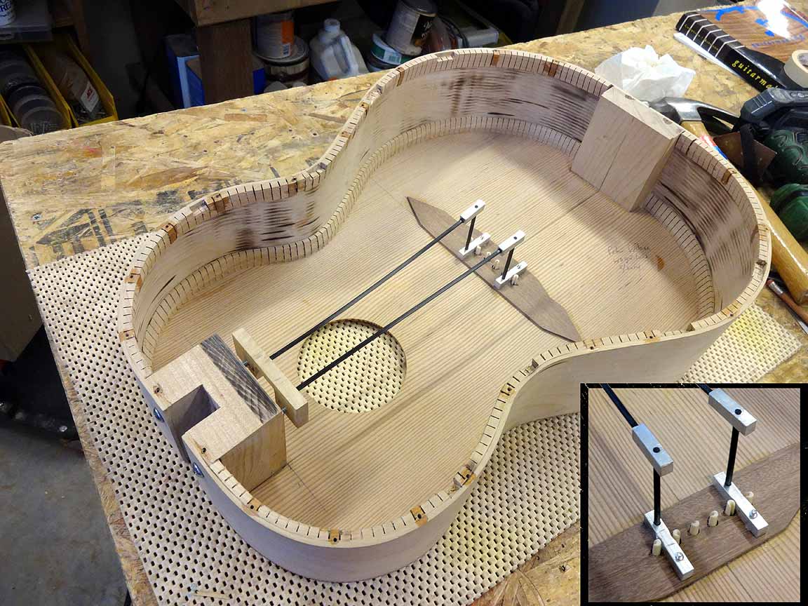

So, you have a carbon rod that connects the top to the back under the bridge? If so, that is pretty much a "soundpost" just like in a violin, and that has been tried many times but is generally seen as a tone killer because it will couple the top to the back and deaden and hamper the top.

Mark Swanson wrote:So, you have a carbon rod that connects the top to the back under the bridge? If so, that is pretty much a "soundpost" just like in a violin, and that has been tried many times but is generally seen as a tone killer because it will couple the top to the back and deaden and hamper the top.

The soundpost idea may well be a tone killer in certain circumstances but why does it work in a violin, then? Perhaps it was used in relation to a normally braced guitar top, when I can imagine it would add to the deadening effect of the x bracing, because that effect does happen. In fact I now believe the cleverest part of the Martin x bracing was in the way it evened out the wide range of frequencies produced by a guitar defining each one, but in my opinion for the loss of harmonics/ complementary vibrations. You would have to try a free floating top to see the difference in volume and tone/harmonics. If anyone who reads this is not sure about trying an experimental guitar then Boulder Creek have produced a range of suspended bracing guitars that are proving very successful indeed. I quote from their website. "It seemed that if the bridge could be secured without using traditional X-type wood bracing, the top would vibrate more freely. This would allow greater sustain, volume, and an overall richer tone." The designers were right.
I wasn't aware of their products when I began my experimentation, which is why I use entirely different materials and suspension methods.
The soundpost is one idea, and far from being a sound deadener, because of design reasons and changes in back bracing it adds a deeper bass, partly because the section of the back which the soundpost is attached to is the part which is free of the body when playing.
What no one seems to have mentioned in this thread is integral strength. Past developments were entirely based around the then available materials and their strengths and weaknesses. Modern materials offer greater strength to weight ratios when used properly and I believe offer the opportunity to improve the tone of guitars at reasonable cost without employing expensive and increasingly rare tonewoods. The first two guitars I built with floating tops (after quite a few standard guitars) used pre formed laminate back and sides for cost effectiveness, yet sound almosty as good, and perhaps slightly better, than standard braced guitars. Certainly they hold their own in the company of guitars costing in the thousands, and you can believe me when I say that I take them out for other guitarists to try, some of whom own some very desirable guitars indeed. The new guitar has solid tonewood back and sides, and so far is proving to be a worthwhile investment in time and money. I wish Peter the very best in his ideas...he can always make standard guitars alongside the experimental ones, and people should remember that at one time the X bracing system was revolutionary and I expect it was condemned by those with a vested interest in the ladder bracing technology they understood. Developments in new materials will bring changes, and those that make it through to the production lines will rapidly become the norm. Who knows when Martin, or Taylor, or Collings or Gibson or Fender will anounce a new carbon braced guitar with a fuller tonal range....tomorrow perhaps, whereupon they will become the new norm.

Which reminds me, Mark Swanson mentioned the soundpost idea, which I have used in my new guitar, but no one has pinted out the fundamental difference between playing a violin and playing a guitar which is the reason for the effectiveness of a soundpost in a violin. The violin is bowed, and the bow continually puts new energy into the violin through the strings, thus the soundpost does not 'deaden' the tone it continually renews it. I'm surprised nobody pointed that out before. In a guitar with a specially braced back the soundpost amplifies the bass particularly at the moment of initial attack, when the plectrum or fingers move the strings and put new energy into them. The soundpost then contributes to the overall bass sound for that short period, and also every time the string is struck. This bass response is quite precise and certainly different from a 'booming' bass. The guitar is still less than a fortnight old but no one has found the sound unpleasant, quite the opposite. I will need to play it, and let others play it some more before I can properly put into words what the difference is. In fact, I might have to build another guitar of exactly the same materials but put in a removeable tone bar so that it can be compared with and without tone bar.....and that, I suppose, is the only drawback with experimenting.... there may be no end to it.

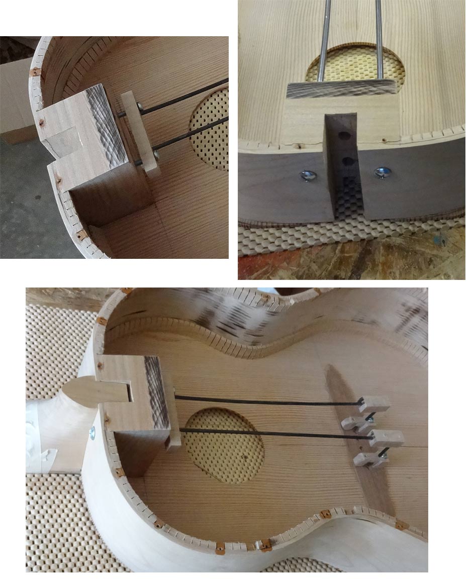

Peter, in your picture "strut torqued" posted June 9, it looks like the component failing under the rotation of the bridge is the blocks holding the carbon fiber, not the carbon fiber. Sort of like trying to hold a fishing pole with your fingertips. If the extra couple CF tubes are helping, it's probably because the load is distributed in the blocks better.
Since what you're doing is sort of a backwards Bridge Doctor (as I think someone mentioned before), you might as well take a tip from their construction: the bridge attachment component is basically a single, solid piece of wood. If you used CF bars and attached them directly to the bridge blocks (you could even splay them out to avoid the soundhole and anchor them somewhere in the upper bout), you'd have a stronger structure that is less prone to deformation.

Jason, thanks for your suggestions. You are right that the failure at the bridge was in the maple blocks, not the carbon fiber. I just had them tightly press fit in the holes. The double ones are epoxied in, after treating the holes themselves with CA, and seem to be holding fine.
However, I think they are too stiff and inhibit the motion of the bridge too much. Maybe by using aluminum I could get back to the single rod, which might give more vibrational flexibility but be strong enough to hold the top flat. I considered using a single block like the Bridge Doctor does, but I wanted to see if adjusting the tension separately on the treble and bass rods would make a difference in the frequency response of the top. I've still to evaluate that.
Jason Rodgers wrote:If you used CF bars and attached them directly to the bridge blocks (you could even splay them out to avoid the soundhole and anchor them somewhere in the upper bout), you'd have a stronger structure that is less prone to deformation.
If I'm understanding you correctly, I think this would lose most of the torque counteracting that of the strings to keep the top flat.
So my next step is to string with medium gauge strings (ordered but not arrived) and compare the output against the lights. Then try some thin, short braces on the treble side of the lower bout to see if this helps the treble response, such as this:
I should be able to evaluate that with the spectrograms and Chladni patterns, not to mention my own ears.
Next, I will make a new bridge with the lowest mass possible, and try to attach low mass but slightly flexible struts. The current bridge and saddle weigh 40g - way too much.

Peter Wilcox wrote:If I'm understanding you correctly, I think this would lose most of the torque counteracting that of the strings to keep the top flat.
Maybe. I dunno. I was thinking something like this...
The rectangular CF bars (3/8" x 1/8") would anchor somewhere on the sides of the upper bout (requiring some blocks be glued in), and the bridge anchor blocks would be lower in profile to give them more strength to hold the CF bars.
If I'm understanding the mechanics of this sort of setup, the Bridge Doctor uses compression to hold the bridge flat (front edge of the bridge rotating down, Bridge Doctor bridge anchor presses against rod, rod presses against tail block), while your solution uses tension (back edge of the bridge rotating up, Wilcox Doctor bridge anchor pulls against rod, rod is glued into head block). No qualitative analysis there, just observation.

I didn't realize your idea raised the height of the bridge block as in the Bridge Doctor, which would give it adequate torque. I'll try that if my other methods aren't strong enough, though making it a solid block might add to the mass of the bridge, which I think I need to minimize as much as possible.
The long CF rods are not glued to the heel block, but are attached to a wooden cross member which has bolts that go through holes in the block on each side of the heel. These are adjusted by sex screws (hollow screws with an inside thread like a nut) from the outside of the guitar to vary the tension of the pull on the CF rods and thence on the bridge. I'm hoping that by varying the treble and bass tensions I can modify the sound of the guitar to some degree.

I'm still working on my instrument, though with lots of interruptions. I tried nylon strings - a complete bust, unable to drive the top. Medium gauge steel strings made some improvement in volume. I've now made a lighter bridge, and a new strut system. I wanted to try to make the top more flexible at the bridge, so reverted to a single vertical strut on each side. I've used aluminum blocks to keep the weight down, and to keep the struts from digging in to the block, as they were doing in the maple ones.
The volume has improved, but the CF is too flexible in the length I have it, and can't keep the top flat. So the next step is to start shortening them until the top stays flat, but will hopefully be flexible enough not to kill the sound - a fine balance. After that I'll try the short braces on the treble side of the bridge.
Posts: 955
Re: Acoustic steel string guitar
Postby Peter Wilcox » Tue Sep 02, 2014 5:39 pm
Turns out the struts weren't necessarily too flexible - but definitely not strong enough, and the CF was cracking.
So I doubled the struts. I'll see how this holds up, and how it sounds.
