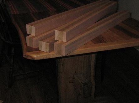

I stumbled up a number of big leaf maple planks at Lowes (Home Center) that had awesome flame. I purchased all that they had and probably made at least a dozen Fender style necks from the purchased lumber. Not one of these flat sawn necks has had issues. The picture below is of neck blanks that I created for Rickenbacker style necks using the Lowes maple and something I found at a lumber yard they called Lyptus. The resulting necks are now about three years old on sold guitars and none of the clients have reported any issues. One of them has a maple center with Honduran mahogany. I kept one for myself and the neck is quite stable with only a very minor tweek of the trussrod twice a year. ...and yea, that's my kitchen table from flamed birch and ash on a base made from a Norway maple base from my back yard.

Correction,... The outer wood of these blanks is actually the Lyptus and not the wood from Lowes.
