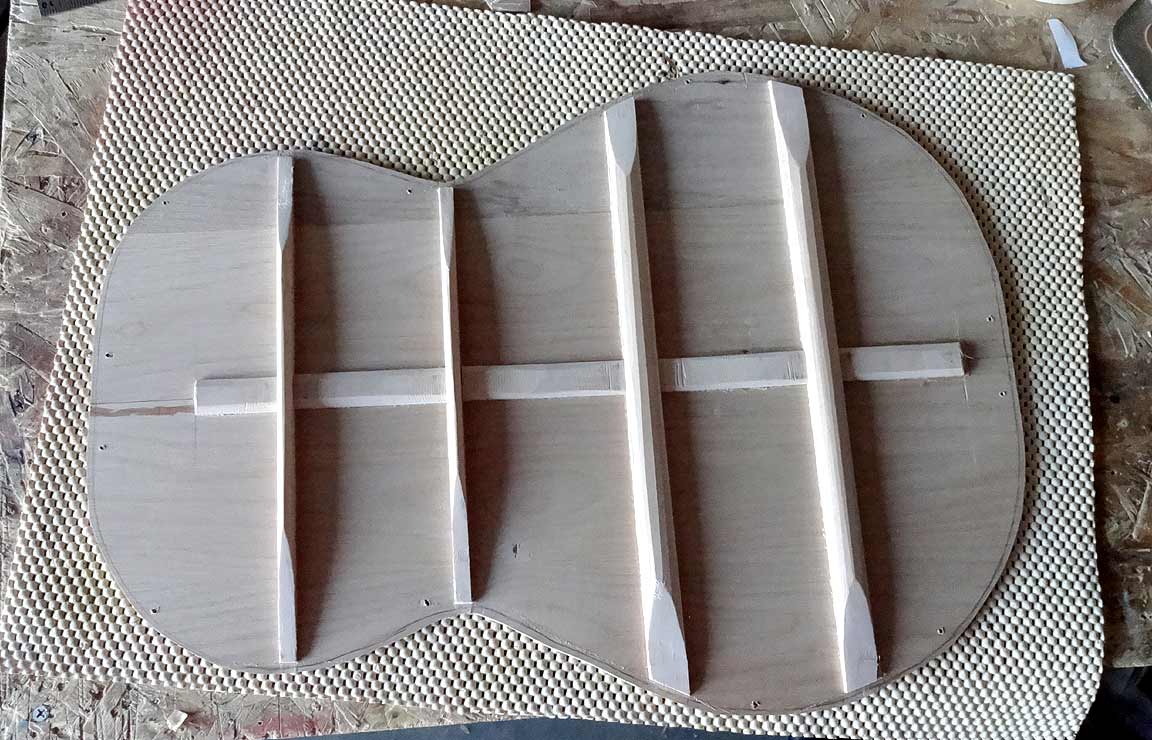

Some more progress this last week. I made the back with the usual bracing, but flat transversely instead of domed. Since I'll be taking the back off and on, I wanted to make it as simple as possible. It will be screwed on until I settle on a final configuration for the struts. Of course the top is also flat, since it has no bracing to hold it in a domed shape.

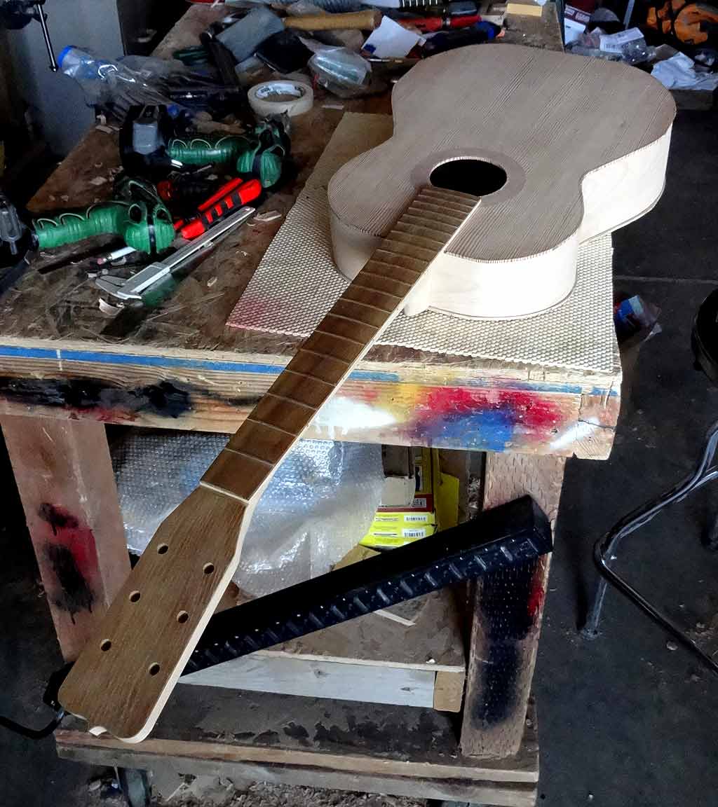

I shaped and sanded the neck, and fretted it. Still needs a heel cap.
I'm not routing the top and back yet for the binding. The back will have more screws in it. Maybe I'll try purfling for the first time.

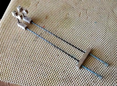

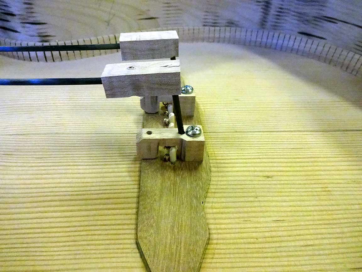

My idea for the struts derives from opposing the torque of the strings on the bridge/saddle with an opposing torque from the bottom of the bridge. I realize that much of the sound of a guitar is felt to be generated by the bridge rocking the soundboard, and that this would stifle that action. But then, the Bridge Doctor has this same effect, albeit using compression instead of tension, and at least some folks don't think this has a deleterious effect on the sound. So I thought it would be worth at try, particularly if the soundboard were unbraced or very lightly braced to compensate. Anyway, I am finding I have a huge amount of ignorance regarding bracing and its effect on a guitar's sound, but I'm certainly enjoying climbing up the learning curve (though I'm still very near the bottom).
So here's the first iteration of the struts. I used 3/16" cold rolled steel that I was using for truss rods. They were fastened to the bridge and the heel block using sex bolts so the tension could be adjusted from the outside. Too stiff, too much mass, producing a low volume tinny sound.
So I took them off, and strung up the guitar with no bracing. It tolerated this well because the top was too thick (0.135"), and although the volume increased by several dB, it still sounded very thin. Leaving it strung up overnight, bellying of the lower bout and caving around the sound hole was becoming apparent by the next morning.

Postby Peter Wilcox » Thu May 29, 2014 7:04 pm

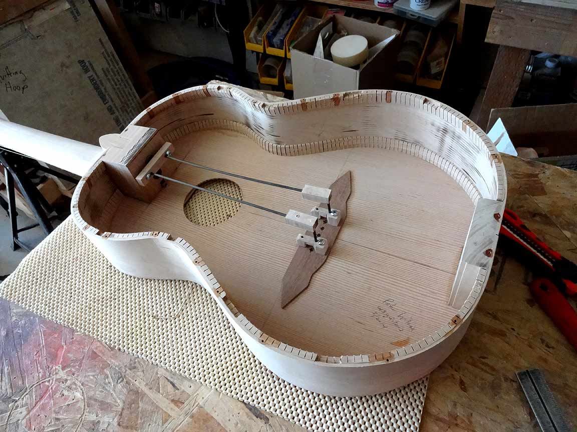

So my next step was to thin the top. I got out the old belt sander and took it down to 3/32" (0.095) in the lower bout, with a gradual increase to 1/8" from the mid sound hole area to the heel. I then built a new set of struts from 1/8" carbon fiber rod and maple.(The extra holes were in case I needed to double the short CF rod.)
The volume and tone have both improved considerably. The volume is comparable to a cheap Aria dreadnought I have, but the tone on the bass side is lacking in higher frequency harmonics (I think that's what it is.)

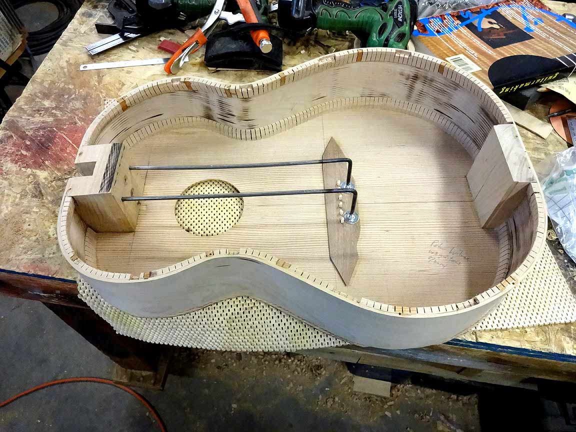

Here are a couple of shots of the installed struts.

Postby Peter Wilcox » Thu May 29, 2014 7:12 pm
So the next step might be to thin the top some more, maybe to 0.08". I can also thin the elbow pieces of the struts to take a little mass off and use aluminum sex bolts on the bridge instead of steel. For now, I am trying to read through Howard Wright's PhD thesis on the acoustics of the guitar, and maybe see if some judicious use of light braces may improve the tone. I guess I'll have to look into Chladni testing too.
Any suggestions, critiques and comments welcome.

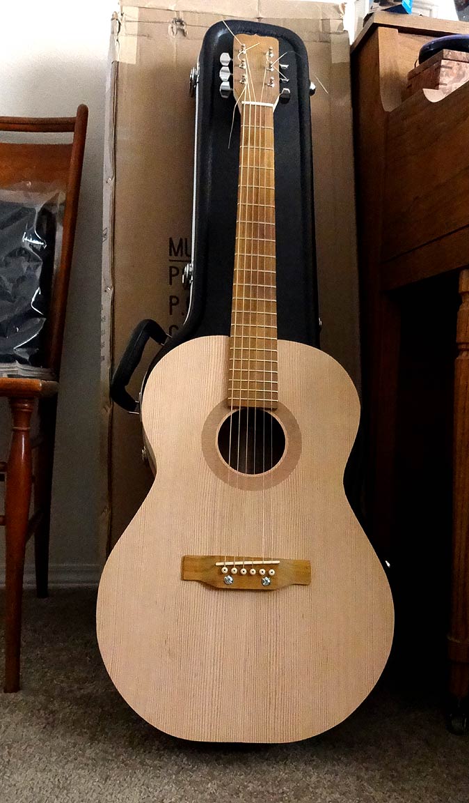

Here is a pic of the guitar as it now stands.

Postby Peter Wilcox » Mon Jun 09, 2014 7:56 pm
The single vertical strut version maxed out on tension - turns out they were leaning, not strong enough for the force they were subjected to
So I added another strut in the holes I'd already drilled for this possibility.
I thinned the top toward the edges to about 0.07", and put it back together. To my tin ear it sounds much better, and so far there's no bellying or caving.

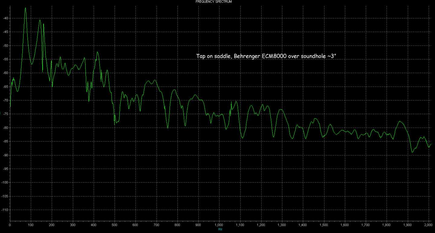

Of course, these spectra are probably meaningless. I tried a tap spectrum, but I don't know how to compare it to the plate spectra discussed elsewhere. This guitar has to be tested strung to pitch (strings muted), and with the back on, as those are major components of the bracing.

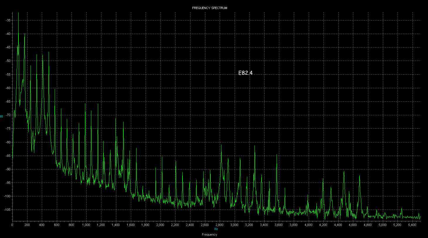

I made spectrograms of each string, plucked between the bridge and sound hole, and recorded over the sound hole. Here is low E - I don't know how to use these to evaluate the guitar's sound - maybe I'll need to record some other guitars and compare.

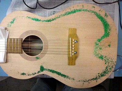

Then on to Chladni patterns. I put an old 4" speaker into a flower pot, and found a function generator I made about 40 years ago, and hooked it up to an amp and oscilloscope (to determine frequency). My computer is about 300 feet away, so I couldn't use it for this, and if I tried to do the patterns where the computer is, the dog and cats might want to get involved.
So here's the set up.
Posts: 900
Re: Acoustic steel string guitar

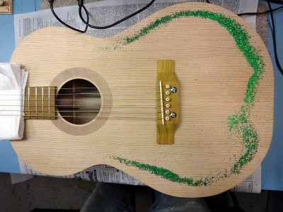

Postby Peter Wilcox » Thu Jun 19, 2014 3:40 pm
So just messing around, I got these patterns.
200Hz
230Hz (Oops -didn't have any sparkle on the upper bout)
1140Hz
I really don't know what to do with these. I guess placing weights on the soundboard, or temporarily attaching braces to see how that changes things. The crux of the matter is how the guitar sounds.
