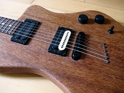

Mark and David, thank you for your replies. I misunderstood what David had asked about the string touching the pickup cover. I did test that just now and there is no cut out of sound. I touched the string to one of the polepieces.
David you are correct about these pickups not having covers. I will ground the pickup cavities and check the wiring again, especially the ground wire. When I say that I added wire to the neck pickup, I meant that I just added extra wire so it would be long enough to reach the electronics cavitiy. Sorry that that wasn't clear.
By the way, here's a picture of the guitar showing the pickups.
