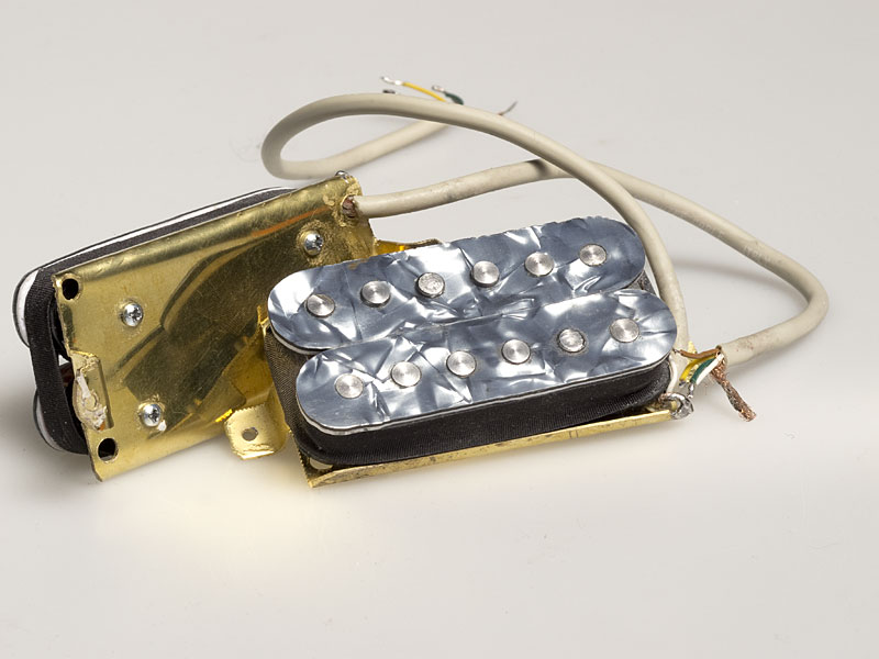

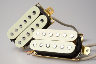

It has been a while since I've posted anything here. I finished a couple of new guitars last summer, but since that I have concentrated on my early guitars by thinning their necks (used to have a tendency to make them too thick) and replacing cheapo pickups with ones I've wound myself. I wound a pretty standard set of AlNiCo5 Tele pickups and three sets of humbuckers of my own design. They're made most of scrap and recycled materials. They are wired with 4-conductor wire and can be split to single coils. I call them Slumbuckers.
I wound the first pair of these in the summer of 2012. I was trying to participate in the MIMF $100 Local Materials Challenge, but I missed the deadline and didn't submit my work. I did finish the guitar, which I sold to my guitar instructor. He loved the pickups. Trying to keep the budget I made as much as possible out of material I had got for free or very cheap, so the pickups were made with no other manufactured parts than the plastic spacers under the bobbins. I made the base plates of copper sheet, the bobbins of 5 mm steel bar & forbon sheet and used neodymium button office magnets, one for each steel slug. Ok, I didn't make the AWG42 magnet wire myself, but practically everything else I did.
Later I made a new version of the pickups with manufactured bobbins and base plates. They turned out nice too but not quite the same. The originals had a bit taller bobbins and sounded different. So I decided to return to the original design, just replacing the soft copper sheet of the base plates with a more rigid brass sheet. I call the later version with standard parts Scumbuckers. What I have wound during this autumn is Slumbuckers.

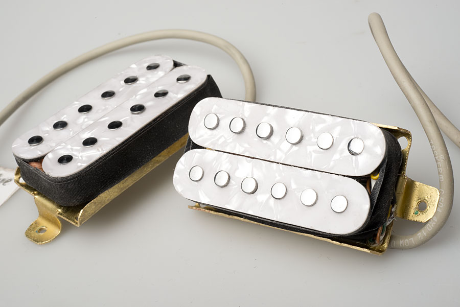

I have often seen pickups with really nice tops such as pearloid, so I decided to wind my own. The first pair was with black pearl tops and machined steel slugs. I leveled the ends of each steel slug by attaching it into a power drill, running the drill at top speed and and pressing a file against it. Once the pickups were assembled I felt a little discontent with how they looked and decided to polish the top ends of the slugs for the next pickups. It took me 90 seconds more per slug, but it certainly paid off. After filing the slug end I polished it with 320, 800, 1200 and 2000 grit wet sanding papers with oil and polishing wax in a piece of felt. I don't mind the extra time and work going into the pickups if they look nicer.
Here come the portraits:
The Slumbucker is a high output pickup. The number of windings and the DC resistance are moderate, but the neodymium magnets give the pickup quite a bit of output. I usually wind the coils of the neck pickup up to 6000-6300 turns and the bridge pickup coils somewhere close to 7000 turns. You'll get the same volume from a 10 kΩ pickup that you'd expect to hear from a 16 kΩ bucker. The moderate number of turns enables to keep the high end of the sound nice and clear while the basses and the mids get a powerful growl when overdriven. Played through the clean channel they sound smooth and clean. I posted links to a sound gallery back in 2012 when i introduced the Circulatrix guitar. I can post links to new sound clips when I have recorded them, if the Circulatrix topic isn't available any longer.

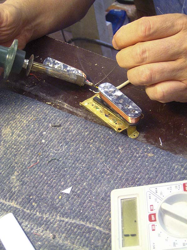

I usually take work-in-progress photos at the workshop. Here come some of them.

Good work! If you look at many commercial pickups, the slugs have a bevel on the visible edge..you could easily do that with your file too. I think it looks nice. And you could also make a little handle that would hold the small plywood jigs while you are routing them- it makes me nervous to get my fingers that close to the router!
- Posts: 301
- Location: Helsinki, Finland
Re: Slumbucker pickups
Thank you for your endorsement and for your concern, Mark. When trimming the rough edges of flatwork flush I do use handles. I put two-inch pieces of steel bar into the two outer holes of the jigs and hold them with pliers, so my fingers don't go anywhere near the spinning trim bit. I don't rout without pliers until finishing the rounded ends of the bobbins, then holding the jig at the other end. I didn't get a good picture of the earlier stage of routing and the one I posted is of finishing the ends. I respect and awe all machinery that poses a threat of injury. I like playing the guitar too and kind of like all my fingers where they are.
I bevel the lower ends of the slugs to facilitate the bobbin assembly. My eyesight isn't what it used to be and I have occasionally installed one slug in a bobbin the wrong way. Once it's glued into place and I have wound the coil, there's no turning it around. If all the slugs were upside down, it might look fine, but one odd slug doesn't. Sometimes I have tried sanding the slug flat, but haven't been happy with the outcome. Polishing the visible ends gives the slugs the look I'm after and prevents me from installing them the wrong way. Of course I could use a magnifying glass to inspect the bobbin before adding glue. I should have thought of that earlier.
At the moment I have three guitar projects with my own pickups in progress. One will have a vintage AlNiCo5 Strat set, the other will be equipped with retro style AlNiCo2 humbuckers and the third gets a pair of Slumbuckers. I just hope that I won't have to move my shop. The owner of the house it's in (the City of Raseborg) is planning to sell the house to the local Pentecostal congregation and a real estate agency is presenting the building to the potential buyer next Sunday. If the house gets sold, I may have to find a new space for my workshop. I may be able to share the shop of a friend and take my stuff there, but I'd rather have my own shop where I can work in my own way without bothering anyone else. I love my workshop and I really would like to stay.
