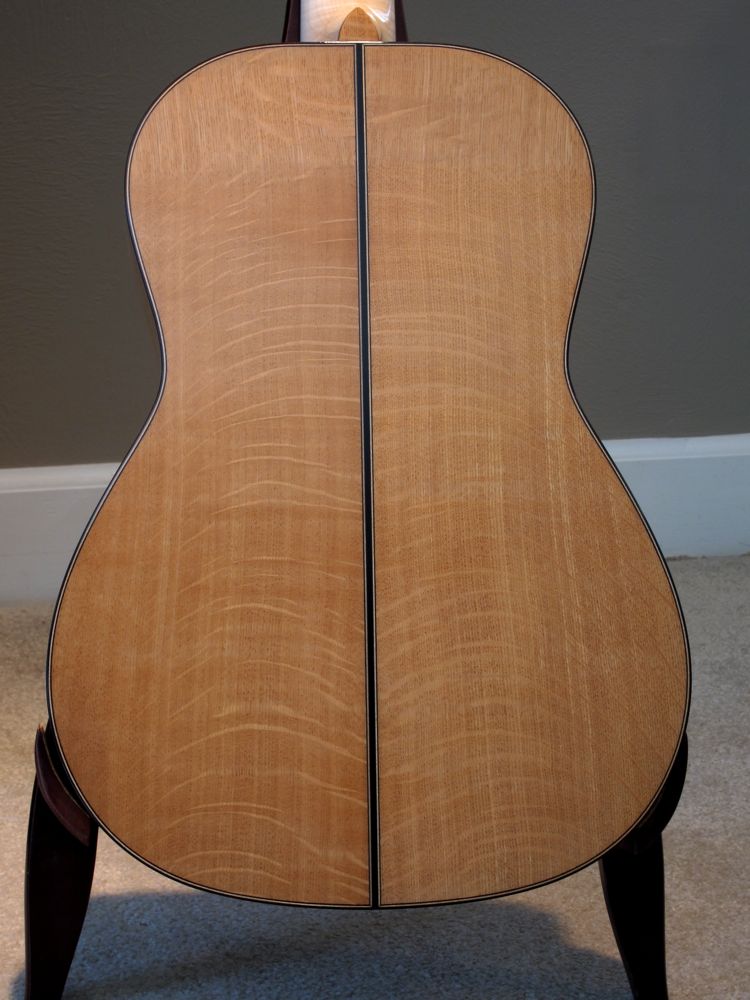

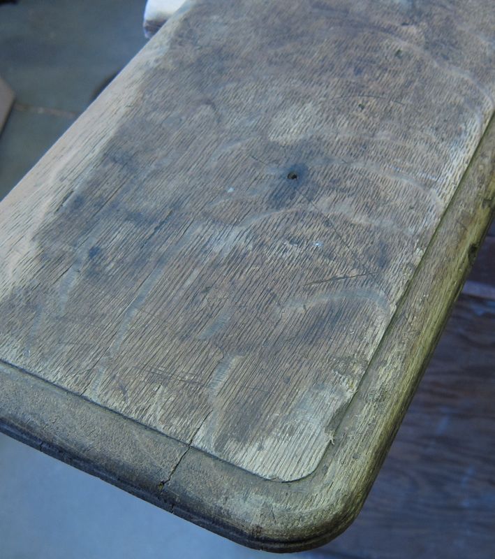

While I don't usually use antiques to build my guitars, I did make one from this old oak dresser that had been left out in the weather. It sounded very good and I'd do it again if the situation was right. One of the challenges is finding wood that is wide enough for the back. This is a smaller guitar so it wasn't as hard.

Ken, that looks fantastic. Looking the weathered surface I for one would never have guessed what was underneath. Beautiful.

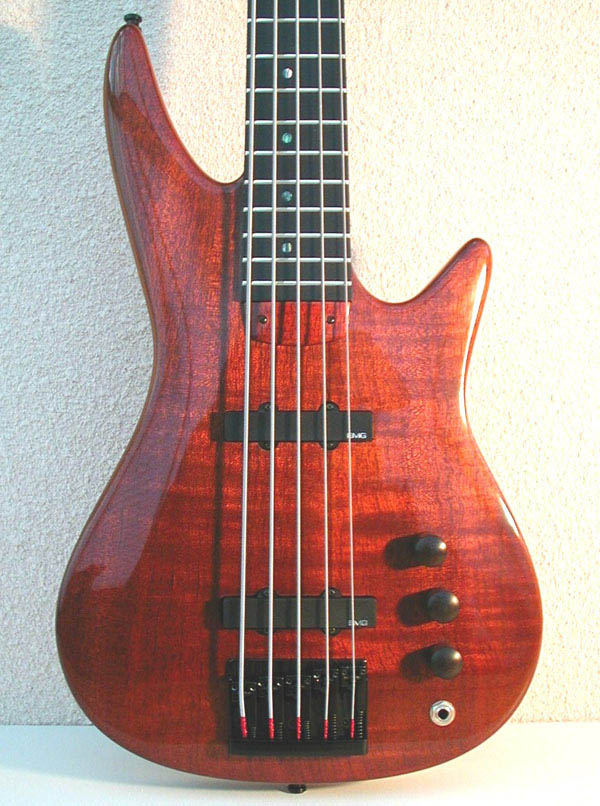

I know you’re talking about acoustic instruments, but this (my first) bass used to be a very plain antique chest of drawers. Two drawers were missing, one was badly broken and my ex-boss had put it out to be burnt. I rescued it, dismantled it and found it was all solid mahogany. The nicest wood was the drawer bottoms. A timber merchant told me that carpenters don’t like curly grained wood; it’s a nuisance to work. I used it for the front.

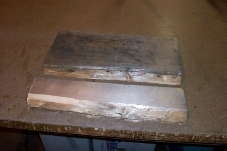

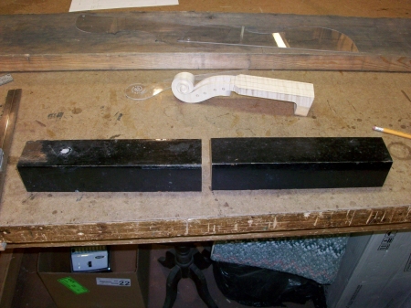

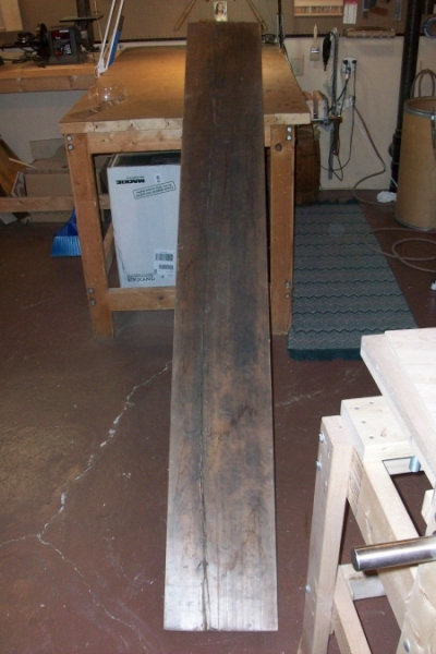

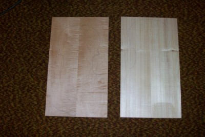

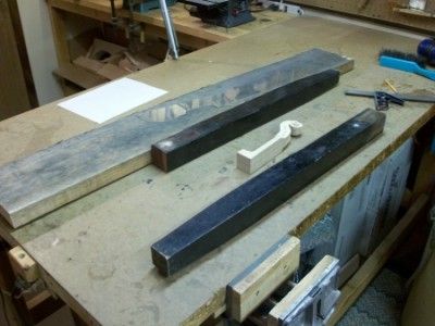

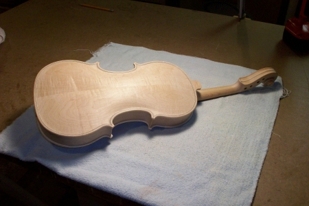

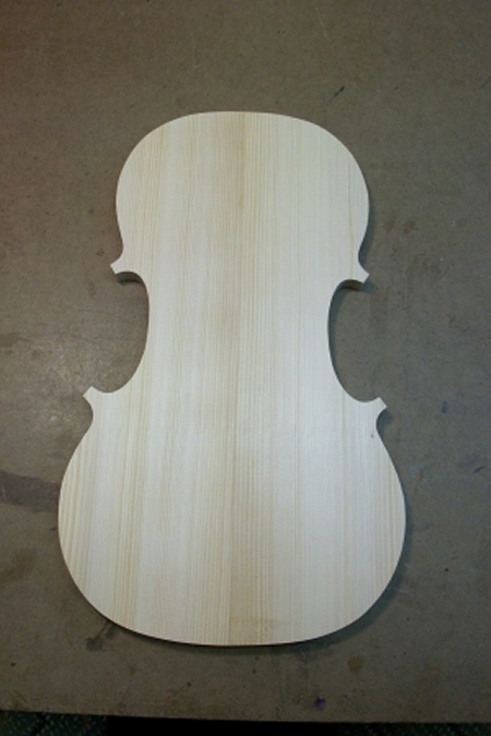

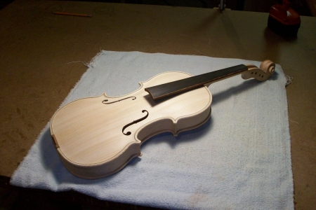

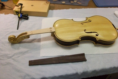

Nearly all the violins I make are from "antique" wood. I've made them from old table tops and legs, an old piano top and soundboard, bed slats, a fence post, and one of my favorites --- I found a 2X10 in the parking lot where I was working at the time. They used it outdoors for supporting a tow motor and other equipment. It was perfectly quartered.
In addition to just a few pictures here, (all of which have backs, fronts, and necks from the mentioned wood). Several more of these are described at
http://www.mimf.com/phpbb/viewtopic.php?f=6&t=1467
http://www.mimf.com/phpbb/viewtopic.php?f=16&t=1119 (at post No 13)
John E Giarrizzo
Posts: 140
Re: Using wood from antiques?
Post by John E Giarrizzo »
John E Giarrizzo
Posts: 140
