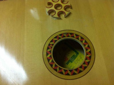

Originally, where the sound hole is this instrument had seven dime sized sound holes. I used my CNC machine to open up the sound hole to what you see.

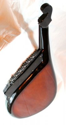

Here's some in process shots:

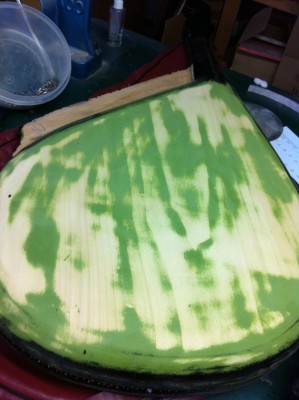

The back with the green goop starting to come off:

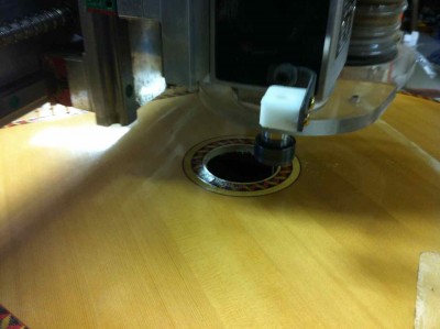

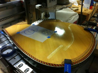

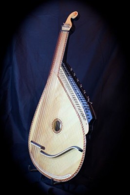

Using a pen to align the CNC machine to cut the sound hole. I made a program that increased the diameter by a few thou every time I pressed go to sneak up on the right size. Wanted it to be as bit as possible while still having a nice border inboard of the rosette.
Cutting the sound hole:

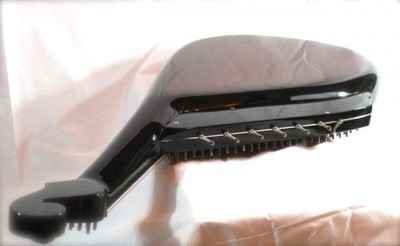

And the finished product:

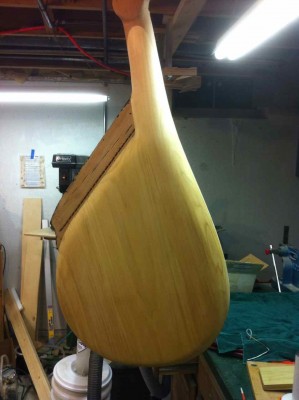

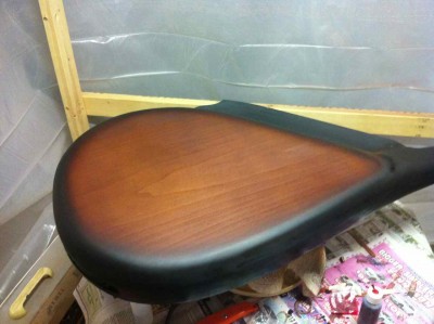

Here's everything ready for finishing:

Was it easy to work with? I'd say "yes" with some asterisks. The only nitro I've sprayed before was rattle can like a decade ago or maybe even more. I followed the instructions on the LMII site except that I finished all of my vinyl sealer coats clear and sprayed the color in the lacquer itself. The biggest nozzle I have for my spray gun is a 1.2mm and it turned out that it was a little too small for the lacquer. It worked fine for the sealer but I was getting some pebbling with the lacquer so I thinned it down maybe 10% with the Cardinal thinner and that fixed it. I think a 1.4mm nozzle would have worked better and I'll probably have to buy a nozzle/needle set in that size. Cardinal states that this stuff is pre-thinned and can be sprayed right out of the can and I believe them, just not with the small needle I had. Perhaps in other guns it would work fine.
The down side is of course the solvent. It was getting cold outside when I sprayed it so I built a little shanty in the garage (you can see part of it in the burst picture) which I heated to spray. The stench was pretty terrible but it didn't get in the house much so it was bearable. The respirator did a good job of filtering out the nastiness as I couldn't smell any solvent when wearing the mask until the last bit of spraying I did which was the bridge. I threw away those cartridges so I'm not tempted to re-use them.

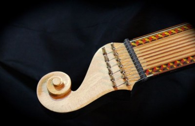

With the nozzle issue solved, it went down great. For the most part, I was getting very smooth coats with little orange peel. Bandura bodies are obviously pretty big so there were some spots where I'd get over spray near the spot I was spraying that left a so-so finish but over all it was good. I've never had success buffing a scroll without burning through so I actually did no leveling or sanding of any type on the actual scroll itself. What you see in the picture is straight off the gun.
