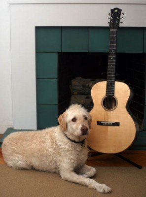

I would also recommend building a kit first. I am close to finishing my third guitar. My first two guitars were built from scratch, with a hybrid body shape I designed, combining 000 and L5 shapes. The bracing and other elements I also designed, combining suggestions from different plans, posts, and memories. My first guitar was just OK, my second is pretty good if you don't look too closely at the binding, etc. etc.. But it sounds good and plays well. So why am I agreeing that it would be best to build a kit first if my own from-scratch efforts turned out OK?
Well, even though I had a lot of woodworking experience, it was mostly on things like storage units and speaker cabinets--basic, square, plywood. While I enjoyed the new challenge of making a complex shape out of solid wood, mostly thin, it was way tougher than I had expected. And, since I was combining a lot of ideas about what to build and how to build it, I found they didn't all fit with each other. The order of operations is trickier than you might think. I finally decided to use Cumpiano as a default, and relied on the Cumpiano book guitar plans from MIMF as a sort of guide. In any case, I made many, many mistakes along the way, especially on the first guitar. I ruined some wood (most notably, a Honduras mahogany neck blank, which I screwed up following Cumpiano's instructions to carve with a chisel; if you're a beginner, use a rasp). I had to do many steps two or more times, trying to get it right. The process of teaching myself at every stage took effing forever.
I really believe that, had I started out with a Stew Mac kit, and then built my own design, I would have produced two guitars in the same amount of time I produced one. And the second one would have been better than the first one I finally did produce.
Generally, beginners are advised to start with something standard and innovate later. That's the sensible thing to do. Of course, there's a quixotic element to most guitar building. One could argue that it's more sensible to buy guitars rather than build them. So if you really really want to build a baritone guitar first, for which there are no plans, and that's what's motivating you, maybe you should go for it. I am near to completing my third guitar, which is a baritone, and I my experience so far indicates that it would have been more sensible to try to improve on my first two by building a very similar guitar. But, I wanted a baritone, and I have to say that, whatever the final product, I have learned a lot from this effort.
Back to a kit: I would recommend a Stew-Mac kit or another kit that is standardized and comes with step-by-step instructions. You can get a custom "kit" with some prepared parts from other vendors, but that is not the learning guide the way a standardized kit is.
Whether it's a kit or a unique new project, the important thing is to get started and create something, and then to learn from that experience and move forward. Good luck!

Thanks for your advice and insight Tim. Aside from all the guitar stuff I've also learned a new word, "quixotic"! That's a nice looking guitar in the photo (nice dog to). Is that one of your "from scratch" guitars or from a kit?

Tim Allen
Posts: 27
Joined: Sat Jan 07, 2012 3:30 am
Re: First Build - Building from a kit vs building from Scratch?
Post by Tim Allen »
Claran, thanks for the compliments on the dog and the guitar. Neither are from kits, though both are hybrids. The dog is a cross between two similar breeds (Labrador Retriever and Standard Poodle), both intelligent mid-sized dogs originally bred to be water retrievers and now mainly used as pets. The idea was to combine some of the best characteristics of both. The guitar is a hybrid between the J-185 and the 000 (with a 15.5 lower bout width, and a nod toward dreadnought depth; it's designed to fit in a D-size case). I hoped to have some of the good points of all these guitars. I call this my "Labradoodle" shape. This is a silly name, but does conform to the tradition of naming this shape after an animal.
