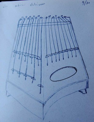

In 2006 I first sketched plans for an idea that intrigued me.
The Zimbabwean mbira (thumb piano) is laid out with bass and tenor octaves ascending from the center to the left, and a treble octave ascending from the center to the right.
I thought, if this layout could be adapted to a hammered dulcimer configuration, it might open up some interesting compositional and performance opportunities for an experimental musician! So I sketched it a few times over the years:
Sketch 1
Sketch 1
Sketch 2
Sketch 2

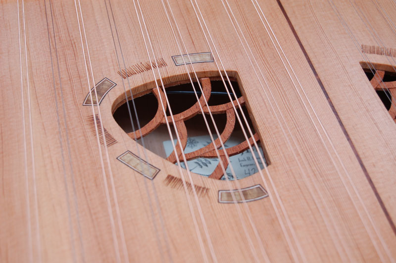

The rosette(s) are inlaid figured myrtle with a shop-made purfling (BRW/maple/mahog) alternated with woodburning:
Rosette
Rosette
