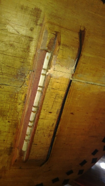

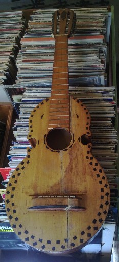

This showed up at a local shop this weekend. I only had a few minutes to look at it, but it sure is curious.
The main feature of this instrument is the sadly 'repaired' crack running deep and wide from the side of the neck to the heel. Just inside the sound hole, the crack has been reinforced with what appears to be a paint stir stick; the repairman's C-clamp left a dimple in the top, just visible at the upper left of the picture below.
In this picture you get a better look at the rough putty smeared into the crack. Examining the bridge, we realized it had been carved out in one piece with the top.

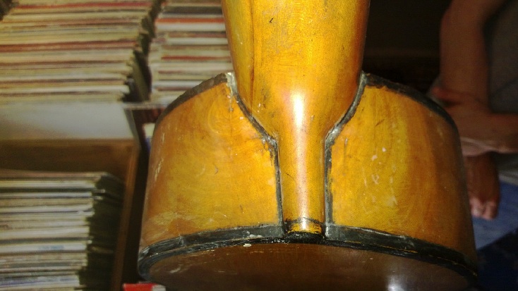

Looking closer, we saw that it wasn't just the bridge and top that were a single entity - the entire thing was hollowed out of one piece of wood. Neck, top and sides had been carved from a solid chunk. The growth rings are visible both at the neck at at the lower bout. The block was cut chiseled out of this piece as well. The back of the instrument is a separate plate from all appearances, but perhaps came from the same wood. It was hard to follow the grain lines. The sides and top had been thicknessed by hand, so far as we could tell. It was a fairly consistent 1/8 inch.
The tuners had been scavenged from some other instrument. The black inlay is roughly fit, but consistentwe suspected it to be piano keys. That made us think the saddle could be ivory from the same source. Grooves for the strings are clearly in five double courses, but oddly spaced. The headstock inlay is plastic chopped down from ...? The binding is painted on, with an engraved edge. The frets (also salvaged) are spaced unevenly.
Obviously some amount of care was put into the building of this thing. Thing that impressed us most was that the piece showed no signs of power tool work on it. This fellow knew *something* about working wood. However, this fellow did not know instruments. Did someone string this up and feel proud or terribly disappointed? It seems far too much work to have been a wall-hanger for tourists, but who knows. I find oddballs like this fascinating.

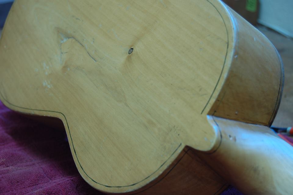

Interesting! I did some repair on a jarana Veracruzana the other day, all carved from a single bock but with the top glued on. It was striking to me indeed.
jarana Veracruzana front
Here you can clearly see the grain continue around from the back through into the sides and neck:
Rear
Rear
