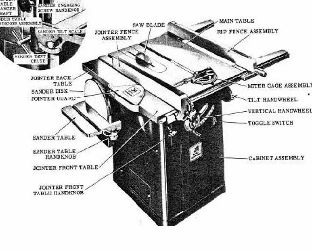

On CL, I found a 1956 Yates American M1701 left-tilt 8" saw/10" sander/4"jointer machine for $200. The 4" jointer is not useful (the beds are warped), but the sander works fine. The saw itself is very nice - the arbor is in excellent shape and cuts 2-3/8" deep, and the original 3/4HP totally enclosed motor runs very nice. These saws were made for highschool training shops, and for use on Navy ships, I've been told, because they were sturdily built (it is battleship quality) and compact. The only annoyance is that the miter slots are 5/16" deep.

here's a pic. The wings on the far right of the table accept a panel to install a router that can be used with the saw's fence. I wonder if I could straighten/align the jointer's beds by shimming them where they attach to the top. Any thoughts on that idea?

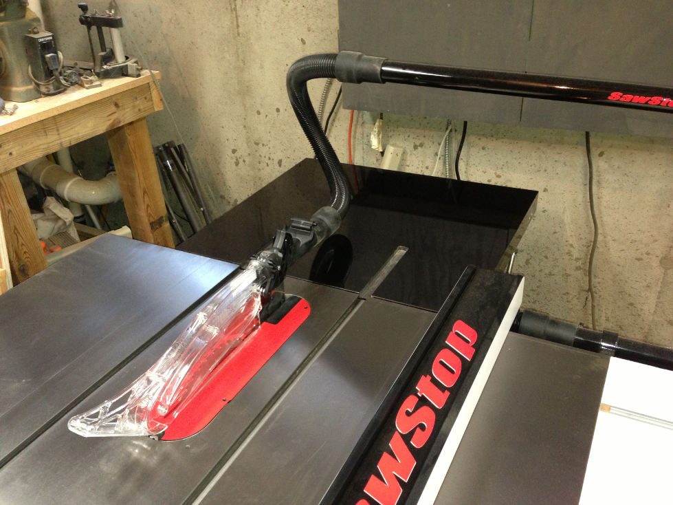

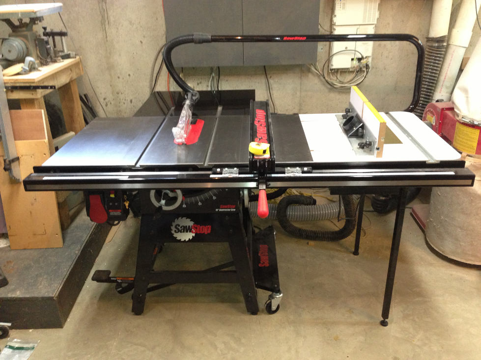

I was off on vacation this week. Decided to buy myself a present!
Sawstop contractors saw with the upgraded Biesemeyer style fence. I replaced the extension table with a router table from MLCS. It worked out nice. Since I had that leftover extension table with no where to put it I fashioned a bracket and support legs for the back of the saw, routed a couple of slots for the miter gauge bars and turned it into an out feed table!
Can't wait to get this thing dusty.
Extension table converted to an out feed table
