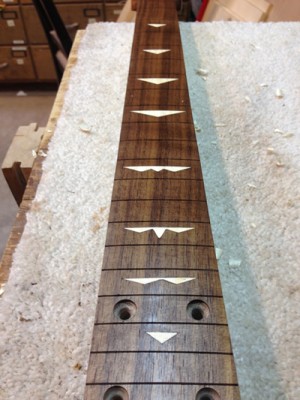

I've used walnut in quite a few fretboards and have not experienced the softness mentioned by others. On fretboard is now 10+ years old and gets regular use by an aggressive player and it is fairing better than some rosewood fingerboards I've seen. I'll post a picture later this evening.

Here's that picture of the walnut fretboard. Curly maple Inlays give it plenty of contrast. Gave it a Tru Oil wash before radiusing, then a liberal application of orange oil after all inlay and finish sanding was completed. This shot is a just after the orange oil was applied. After a week the color is stil deep but the finish is matte.

Thanks for posting that, John. Very pretty fretboard. Good to know your walnut has held up.
