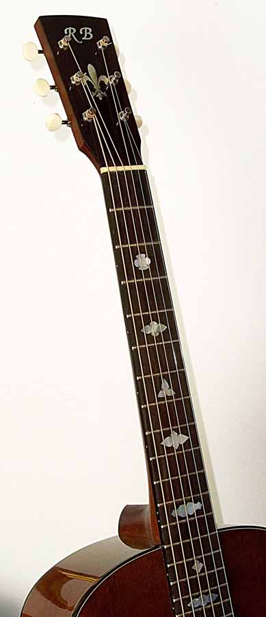

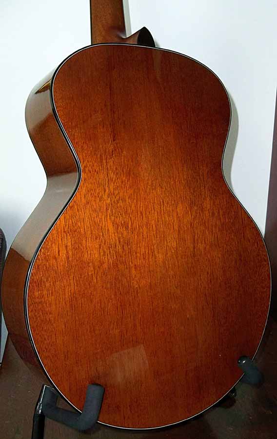

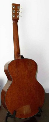

Just completed this 1928 style Nick Lucas. It is gone to a good friend/customer who is in the hospital on the list for a heart transplant.
Back and sides - Honduran Mahogany
Top - Red Spruce
Neck - 3 piece Mahogany
Inlay - MOP Nick Lucas from Andy DePaule
Headstock veneer, fingerboard, bridge - ebony
Rosette - spalted birch with MOP & BWB rings
Finish - body - KTM SV over system 3 epoxy filler.
- neck - Waterlox
- headstock veneer- FP
Scale length 24 1/4 inches
Lower bout 14 inche
Lower bout depth 4 5/8 inches
Upper bout 10 1/8 inches
heel depth 4 1/8 inches
It is very responsive - Has a rich bottom end and great mids and highs. I like it a lot and will definitely add it to my repertoire.

Re: 1928 style Nick Lucas finished
That's very pretty Ron! I bet it sounds great.
I noticed the 24-1/4" scale, is that standard for the older Nick Lucas guitars? I didn't know that...it is the same scale as the fatboy guitars that I like to build.
- Posts: 153
That scale length seems standard for 1927 and 1928. In 1929 it changed to 24 3/4. I used medium strings and it is very easy to play.
Yes I like medium strings on the Fatboy too...lights a little too loose at that scale. Good job Ron! Is the finish color hand rubbed in?
- Posts: 153
I use the stewmac dyes in alcohol and I spray the burst and the tints for the side and back. I mask the purfling and the rosette before I spray the dye and then spray a couple of coats of shellac before I fill with system 3 epoxy.
