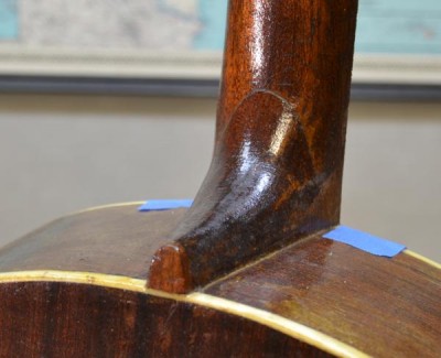

Okay, I figured out what a "button" is, or at least I think I have, it's an extension of the back glued to the underside of the heel, right" More of a violin terminology, though I have seen some French guitars done this way as well. I don't think this guitar has a button, see picture below. There is a mahogany heel cap, but this does not appear to be part of the back as the white plastic binding runs under it.
Another thing notable in the picture is the joint between the neck shaft and the lower heel block. This appears to have come loose at some point and was reglued, it feels solid enough now, though not real pretty. The neck heel block is quite rough anyway, so one option might be to cut the heel away and chisel out the remainder in the pocket. This would leave just the neck shaft which could probably be worked out with some hot water and a hot spatula from the top and under side, as well as along the edges. Then a new heel block made, glued to the shaft and the whole thing reinstalled ala the original. Would this be judged a valid repair?

Re: Neck removal, unusual joint
You're right about what an end button is. This guitar doesn't have one, so removing the back probably wouldn't help. Ah well.

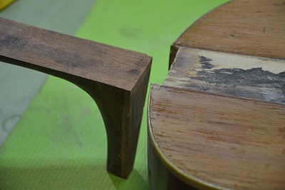

Just a quick one to say I got the neck off in one piece. Used a combination of Alan's violin neck block method, Mario's 1/16" drill and heat. I cut along side the heel to the base of the pocket with a .005" thick razor saw. Drilled some holes down through the base of the pocket and kept working away with a hot spatula. Took about three hours of persuasion, but came apart clean and reusable. An oscillating saw would have been helpful for the first inch or so, but I didn't have one handy. The glue turned out to be hide glue which probably helped.
