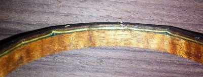

I find that when the side purflings buckle it sometimes helps to press that edge of the binding down on the flat top of my bending iron, using something like a flat piece of wood to apply pressure. This bends the buckles out to some extent, and softens the glue. Then press it down on a flat piece of cool wood or metal until the glue hardens up again.

Another way to accomplish Alan's suggestion is to press the tight curve with a clothes iron. I have one I bought at Goodwill for $3.00 that works great for shop stuff, and saves me the grief of using my wife's iron.
