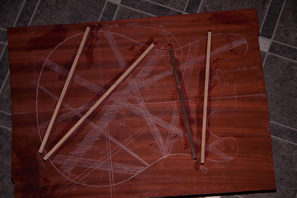

Anyway, the body is padauk with 3/4" routed channels inlaid with maple or walnut.

The following images are self explanatory and essentially show the inlaying of the stripes and a roughly bandsawn body.
Initial outline of stripe placement

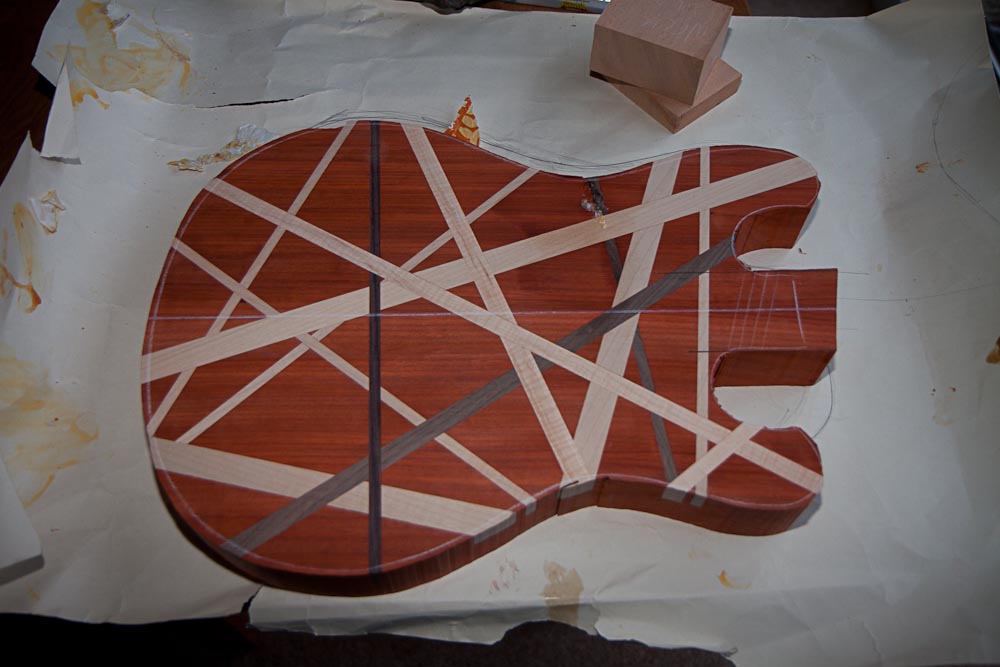

All stripes in, drum sanded top
Rough bandsawn body
Rough bandsawn body
I appreciate any comments and suggestions.

After several problems, queries, fantastic advice and a little bit of luck, I have just about finished my first build. The specs are as follows :
Body - padauk inlaid with strips of flame maple, sycamore, walnut and an offcut of indian rosewood.
Neck - flame maple, glued in
Fingerboard - flame maple, 22 frets
Headstock - simillar to body, but in veneer
Scale - 25"
Controls - standard Les Paul arrangement with 500k Alpha pots and cheapo disc capacitors.
Pickups - matched Abraxas set from Bareknuckle Pickups (rather fabulous English company)
Finish - somewhere around 12-14 coats Tru-Oil
Bridge/tuners - Gotoh 510
Some pictures :
