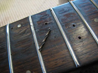

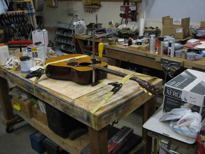

A friend brought me his Yamaha FG-140. He'd fallen on it and cracked the heel, which had been cracked in the same place before and glued by someone with ? He tried to repair it himself this time - first by drilling holes in the fretboard down into the heel to put some screws in. He broke the drill bit off on the 3rd hole and gave that up. Then, he tried cutting through the crack with a hack saw, because he thought the crack was too thin to get the glue into, and it would flow right into the saw kerf. He asked me if I would continue the repair because he didn't have any clamps, and he couldn't get the drill bit out, and he'd hit that metal rod thing in there with the drill and wondered if he'd damaged it.
- Posts: 1327
Re: Cracked/split heel
First, I got the broken bit out without much trouble.

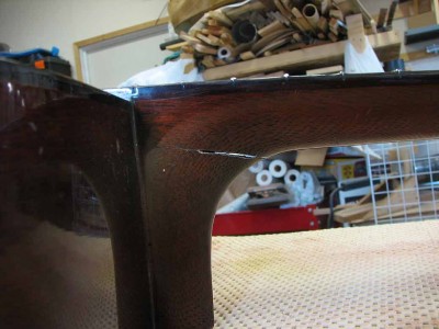

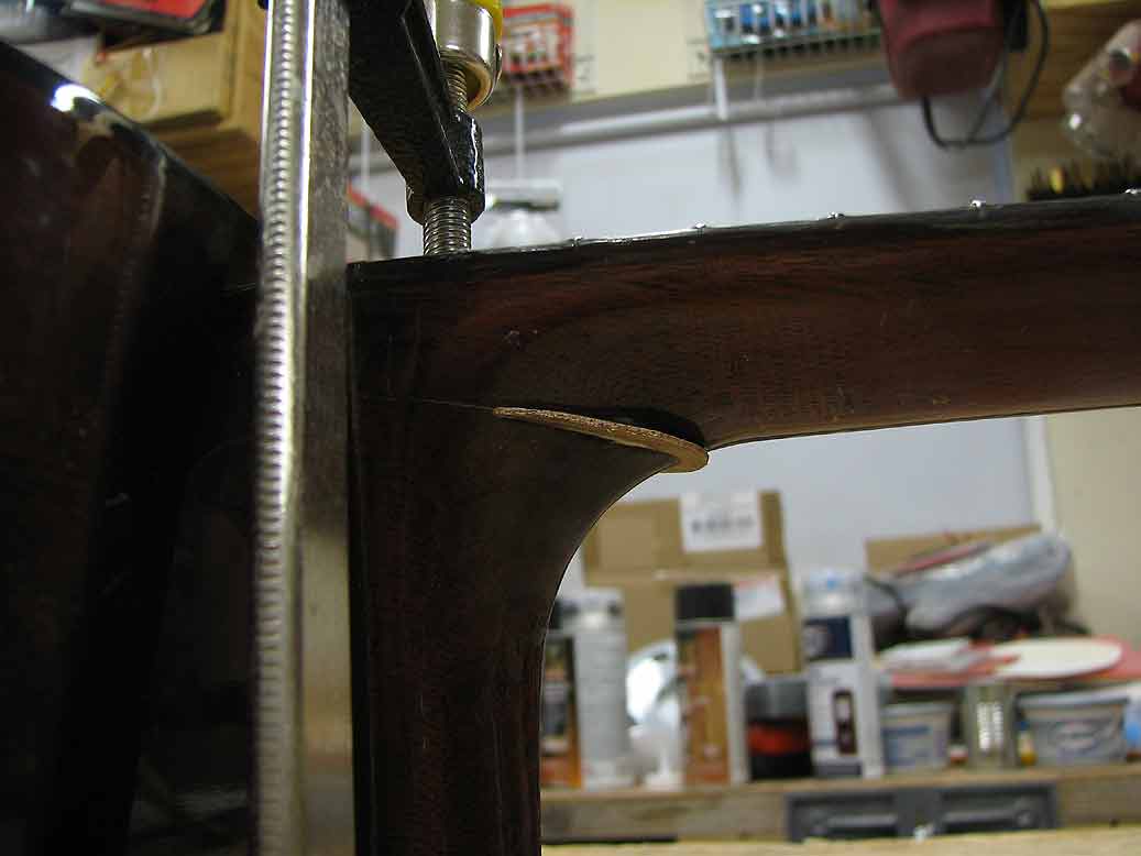

Next, I cut and sanded a thin piece of mahogany. I used an emery board to smooth the inside of the saw kerf, and fit the mahogany piece in, then glued it with Elmer's yellow glue. I was able to wick some glue into the crack also, but since this may have still had old glue in it I don't know how useful this was.
This is where it stands now. In retrospect I probably should have continued the saw cut down to the side and repaired it with a larger piece of mahogany. Next I'll fill the screw holes with epoxy and sanding dust, then sand and finish the heel. The original finish contains stain, which I won't be able to match, but on this guitar that will make little difference.

I think the first thing you needed to do was give your friend 40 lashings.
But after that- I was imagining how I would fix something like this and I think I would have gone about it pretty much the same way. You have to replace the wood cut out by the hacksaw blade, so I would have made a thin piece of mahogany to replace the lost wood too. I was going to say I'd chisel out the sections where the fretboard was drilled and patch in new rosewood there. I'd say that unless he really drilled hard and for a while, that metal thingy in the neck should be just fine.

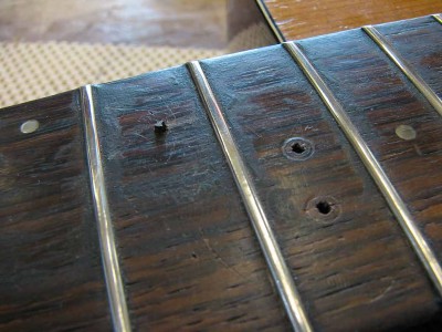

Plug the holes with wood dowels and glue them in place. I would not put glue and dust in them.

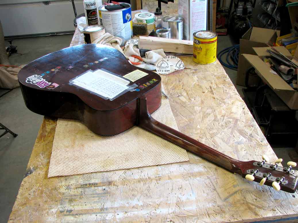

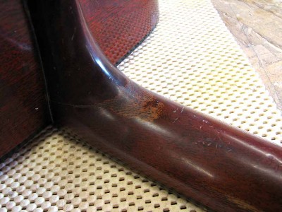

I sanded the repair too deeply and removed some original finish, so I put on some dark stain which stained the end grain well but not the area where I sanded off the original finish. I don't know what finish would be appropriate, nor how to apply it, so I just rubbed in some Danish oil I had on hand. Cosmetics are not a major factor in this repair (as you can see), but I'd like to know how to do it correctly.

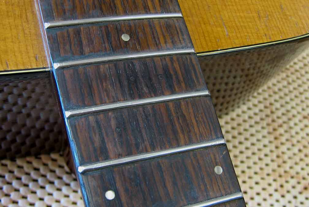

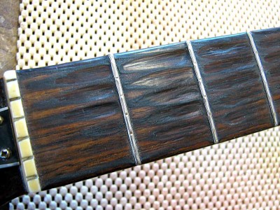

I filled the holes with epoxy and sawdust - they're not too noticeable on this guitar. I post a pic of the fretboard near the nut - this guitar has been played a bit.
Anyway. to have done this right I assume I should have removed the neck, and glued dowels in the drill holes (and leveled the fretboard and refretted). But how would you repair the heel once it is out? There is still the saw kerf to deal with.

The fingerboard holes are not as noticeable as I thought they would be.
The frets need a little attention now.
