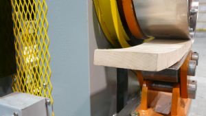

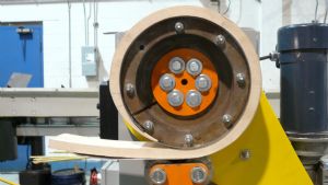

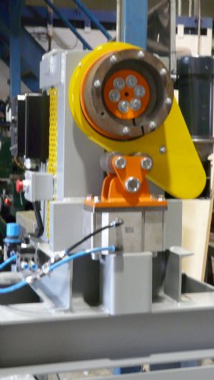

Bill Rickard
Posts: 5
Joined: Wed Oct 31, 2012 1:07 am
Location: Aurora, Ontario, Canada
Re: Bending 1/4" thick banjo rim
Post by Bill Rickard »
Here's some photos of my second rim rolling machine that I built from scrap iron, laying around my metal fabrication shop. Definitely an over kill but it rolled many rims before being retired for the system that I'm in the process of building. You can basically roll 1/4" thick plies with a much simpler wood mandrel. Again the secret is the compression strap. You must compress the wood to get good results.
