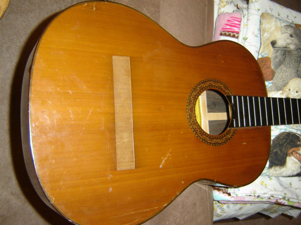

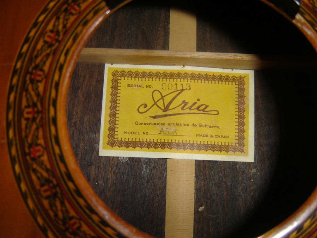

Hobbiest here, non professional.
I purchased a Aria A558 classical guitar in a garage sale that is missing its bridge. There are a few tight cracks in the top and a loose area of the binding. These are repairs I can do with hide glue.
It seems to be a mid 60's - early 70's model from the little bit of information I can find on the internet. I believe it is hand made by Matsumoku, might even be brazilian rosewood back and sides, solid? Solid cedar top, rosewood fingerboard, straight neck, good frets and wood binding.
I don't know much about good quality classical guitars, so I'm speculating until I can take it to the professional in town to look it over.
I'm guessing that maybe it's a mid to upper level model, and if so, I want to get the bridge replaced with a good replication. I have a rosewood bridge that fits the footprint of the original, and the saddle slot position. But it is a plain looking bridge.
Please look over the pictures and if anyone has a picture of the bridge, or any information on this model I would greatly appreciate it.

Wow, never seen a bridge lift of so cleanly! Cool looking Classical, the neck photo looks Brazilian to me, though the dark streaks may be age. I don't have a photo but a "Simple" bridge like the one you have could be aged to match the other wood IF the footprint is right, I wouldn't shortchange a nice guitar like this. Curious about the action, though. If in need of lower relief it could be problematic with the spanish heel and a new bridge could (or could not) be configured to help in this area.

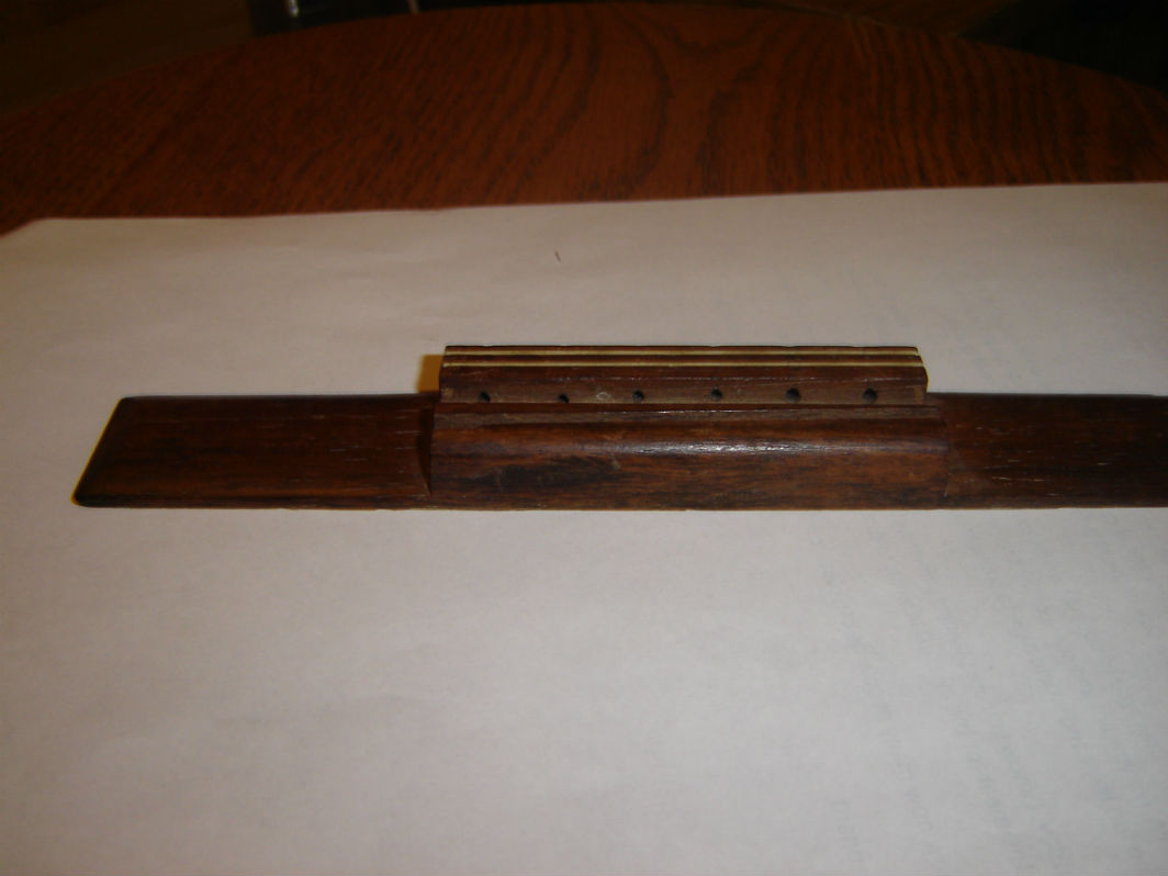

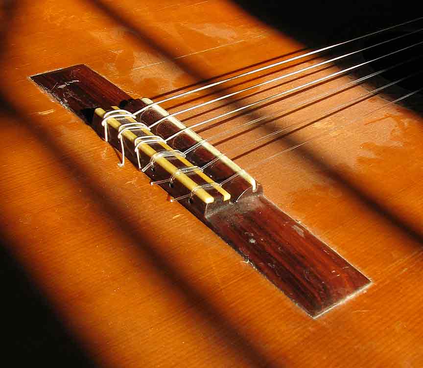

Here are a few pictures of the bridge I have. It is from a Framus donor cadaver.

Looks pretty thick, stiff and heavy to me.
You don't want to try making your own? A bridge can be so much more elegant than that!

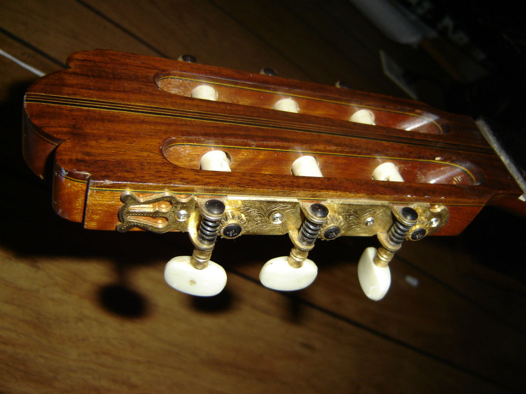

Looks like I've got his flamenco cousin, as it has wood tuning pegs and a golpeador.
- Posts: 1325
Re: Aria A558 Classical Bridge replacement

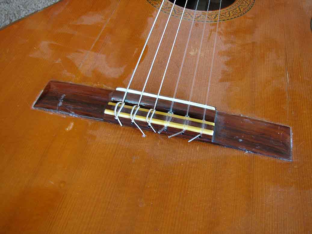

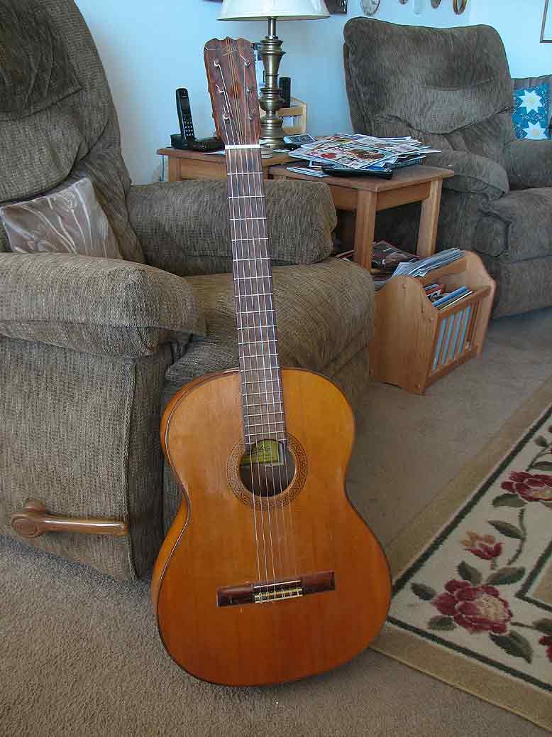

Bridge pics. The bridge is 7 1/4" long, 1 3/16" wide, 3/8" high at the tie side, and maybe 1/32" less at the saddle side. I don't know if there would be differences in the classical and flamenco bridges.
Let me know if you need any other info.

Thanks for the pictures. Is the tie block level on the top, or slightly slanted downward to the saddle?
Rosewood, plastic or bone for the saddle and nut?
I like that 1930's detective movie look on that last picture. I can hear Humphery Bogart threatening to "pull its strings off" if it "dosen't start singing right now".

The tie block slants down.
The nut and the binding on the tie block seem to be relatively soft, as in plastic (worn grooves where the wound strings pass over.)
The saddle is bone, but may not be original. I guess the bridge is rosewood - it seems to be similar to the fretboard and the headstock veneer.

The rosewood Framus bridge I've pictured above weighs 32 grams as is. It would need to have the saddle support lowered to get the saddle into the correct string geometry, about 1/32-3/64. Then the string block could be lowered and slanted forward. I will need to double check to see if the string holes will keep a good string break angle if I lower the saddle support.
