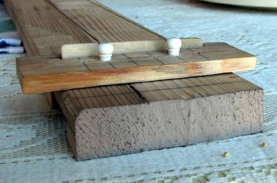

I don't know why one would pull up from the back, as there seems to be no rotational force from that (or any) direction.
You are not seeing the effect of the torque (AKA rotational force) because a 2x4 does not deform (strain) enough to see it.
A guitar top - however - does.
The torque is there and it is significant.
What you have shown is that the "sandwiching" force of the stings overcomes the tipping force of the torque for rigid bodies. That is not surprising (at least to me - not trying to be obnoxious there).
On a guitar top, the torque causes the top to potato-chip, and the back edge of the bridge peels off the top. This deformation gets worse and worse over time since wood will creep with constant force.

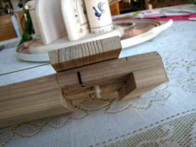

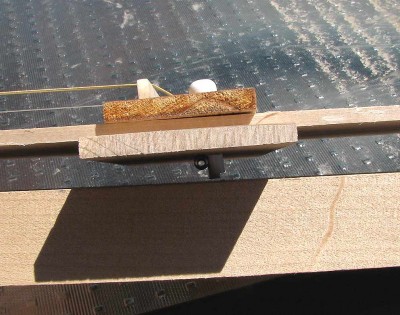

I know the torque is there - so basically it is the torque on the guitar top that causes the glue joint to fail, not any torque on the bridge. Optimally then, the glued-down bridge is another brace that attempts to keep the top from doming behind it, and when the glue joint fails the bridge pulls forward and tips forward following the line of string tension between the pin hole exiting from the top, and the saddle. I would think then that the pins could also play an important part, at least in a failing (or non existent) glue joint, in keeping the bridge from pulling forward toward the nut.
So possibly the pins could replace the screw stops in my model - I'll give it a try.

Re: Purpose of bridge pins?

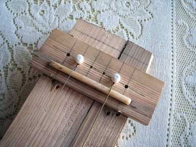

FWIW, I inserted bridge pins and removed the screws. There was a slight shift forward, and a slight rotation of the rear of the bridge upwards, both in the 0.5mm range. I think most if not all of this is due to the loose fit of the pins in the lower holes, as the pins are tapered and the holes are not. The apparent side gap is not real - it is due to mismatch of the lower bridge surface to the upper plank surface, which is not very flat on that edge - the bridge is firmly affixed at its anterior aspect over most of its width. So it looks like the pins themselves act as stops against the bridge sliding forward.
I'm trying to understand the vector analysis of David Malicky, but it will take awhile - it's been about 45 years. Anyway, thanks for that and all the interesting comments.

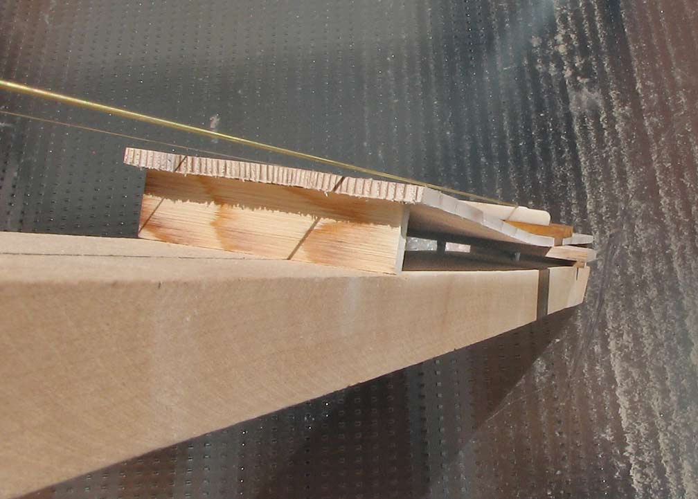

From what I've seen, if the top were flexible but not stretchy (say, something like Mylar) what you'd tend to see would be the string trying to make a straight line between the nut and the upper edge of the lower block. The bridge would form a 'kink' in the string, with the afore mentioned up and down forces on the bridge and saddle working against the tension/stiffness of the top.
Peter: try using a thin piece of wood for the 'top', and gluing a 'bridge' onto it partway up. That will be more realistic.
As for doing a listening test with the pins removed: I'd cover the holes with tape to cut down on the air flow. Admittedly, this would probably be a small affect on the sound, but it could be audible.

Posts: 1325
The take home lesson from this for me is that there will be no catastrophic failure of a pinned bridge. Though it may peel up slightly from the tail side, it will stabilize and not tear off, as would a pinless steel string or classical tied bridge. That is comforting.
And the pins do serve the function of stopping the bridge from moving forward should the glue fail.

Posts: 1325

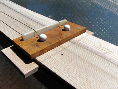

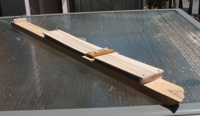

I made a model of a bridge on a thin piece of wood, to emulate the top. Of course, this has nothing to do with a real top, which has width, bracing, a sound hole, fingerboard extension and 6 strings. It does seem to show that the major torque causes a down bow several inches in front of the bridge, without a seeming compensatory up bow behind it, but I'd guess this is due to lack of bracing, which in a guitar top would transfer the force toward the tail. The bridge (which is not glued) does pull off slightly in the rear as before. The bridge plate is glued to the "top."
The pin holes are tapered, and the pins do act as stops to keep the bridge from sliding forward.
Posts: 1325
More pics.
