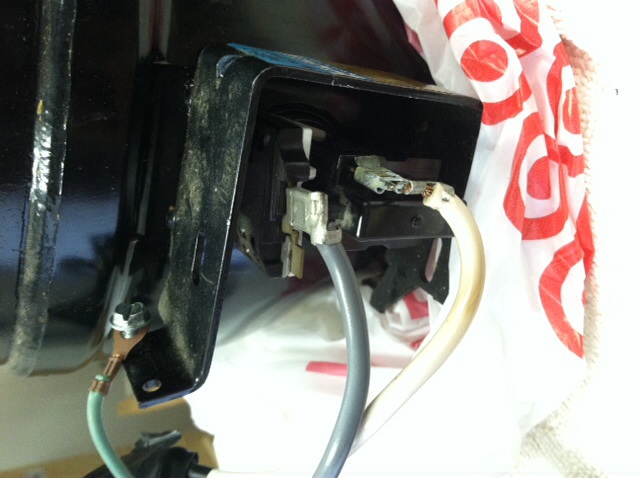

Gaaaaaaaahhhhh!!!! This new one doesn't work, either! It does the same thing: hums for a bit, then the overload trips. I have tried wiring both directly to a plug, the same way the first was wired, and worked, for a couple years. Black into the overload circuit (plugs into the top of the three pins) and white into the #2 lug on the relay (spans the bottom two of the three pins). Searching the interwebs confirms this is correct. WTF?!

Re: Jason Rodgers builds a vacuum clamping system
Is it missing it's start capacitor? It won't start without that. Refrigerator motors have a lot of extra gizmotry to make them failsafe and reliable. Then again when an old fridge stops working it's usually the motor that's gone south so getting a junker isn't going to be a sure bet by any means.
So, this is what I've got. The doo-hickie with the grey (black) hooked in is the overload, connected to the top pin. The thingamabob with the white wire is the relay, which spans the bottom two pins.
EDIT: One of these puppies? http://www.amazon.com/Supco-RCO810-STAR ... B00A8O0E5Y
My original compressor ran just like this. But you're suggesting there is a third component I need? And that's a start capacitor? Sooo, like, for example, this is the third piece of a "3-in-1"?EDIT: One of these puppies? http://www.amazon.com/Supco-RCO810-STAR ... B00A8O0E5Y

That would be the "Hard Start" cap I mentioned above. It needs to be sized for the motor HP. I make no promises that it will work but it just might. I know I have one in my fridge after it failed to run one day.
Ok, I can get one of those easily enough. I'll be sure to double-check the specs to get the right one. I can even get two.
Here's my question, then: why did the original compressor, the one my dad plucked from a fridge in the dump, turn over and work so well from the get-go, but now may need a starter capacitor? Is there some internal start circuitry that fails, and so requires an external nudge to get going? And is that why this second compressor needs help?
Well, on the upside, if a 3-in-1 is the solution for either of these compressors, I'm back in business. If it's the solution for both, I'll plumb them both into my system!
