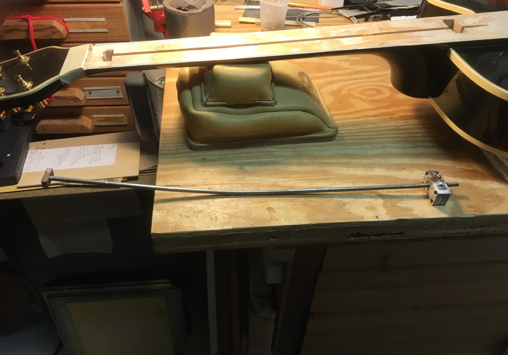

Postby Barry Daniels » Sun Jul 30, 2017 5:01 pm
Here was something I had never seen or heard of before. Its a truss rod installed in some Gretsch archtops in the 1970s that uses a geared adjustment system. I have read that they were problematic. This one, which was installed in a 7-string guitar, was frozen and the adjustment nut was completely stripped. I had to pull the fretboard and pull the rod out after removing the wood spline and some wood in front of the end support to take the pressure off the rod. During removal it bent on me due to the very soft metal rod. This rod is considered a dual action rod.
I am going to replace it with a Blanchard rod, after filling in some of the rather large holes left in the neck.

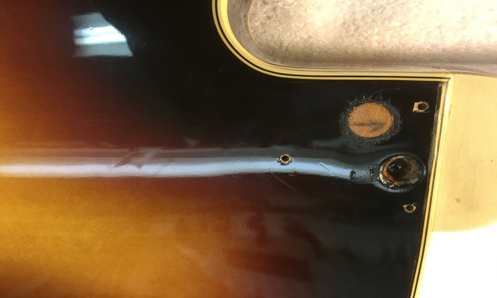

Postby Barry Daniels » Sun Jul 30, 2017 5:03 pm
The truss rod adjuster was accessed through a hole in the back. It is the lower hole and the adjustment nut was several inches deep into the hole. I can't figure out what the second hole is for.

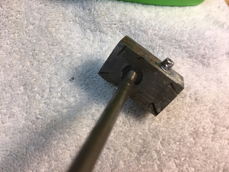

Postby Barry Daniels » Sun Jul 30, 2017 5:04 pm
Here is the gear box on the end of the rod. And the stripped adjustment nut is on top. The nut appeared to be made out of a metal as soft as lead. The adjustment knob looks like it is engaged with a reverse slotted screw driver. But it is so worn I can't be certain of the original configuration of the nut.

Re: Burns Gear-O-Matic Truss Rod

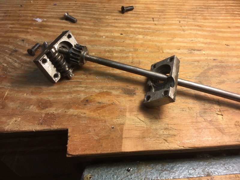

Postby Barry Daniels » Sun Jul 30, 2017 5:07 pm
And here is the gear box opened. I could not get the gear to turn on the rod, even when it was removed and accessible.

Postby Peter Wilcox » Sun Jul 30, 2017 7:08 pm
So it seems the worm gear is a threaded nut, that is supposed to loosen or tighten the rod as the adjusting nut (on the end of the worm) is turned. Assuming the worm turns OK, I'd say the threads on the rod and the worm gear are frozen tight to each other, not surprising if the metal is soft.

Postby Barry Daniels » Sun Jul 30, 2017 9:07 pm
The round gear on the rod is internally threaded and it turns on the threads on the rod. It turns about one half turn in either direction before it freezes up. The gears and the box don't seem all that soft, but the rod and especially the adjuster on the end of the cylindrical gear are very soft. I don't see any stripping of the gears or thread rods, but they are unusually sharp and appear to just dig into each other creating a lot of interference. Pretty weird. Also, the hardened grease doesn't help any. I am certainly NOT going to rebuild the rod and re-install it. The owner wants to modernize the guitar.

Postby Peter Wilcox » Sun Jul 30, 2017 10:19 pm
If the worm gear (the name of the gear with the internal threads) is hard, and the rod is a lot softer, then I'd guess the gear's threads have bunged up the rod's threads, and that's why it won't turn properly, akin to using a steel nut instead of a brass one on a normal truss rod. Looks like an attempt to adjust the truss rod other than from the ends of the neck - guess it wasn't very well implemented.

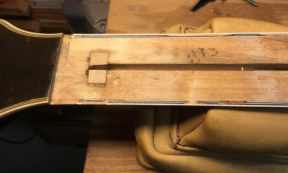

Postby Barry Daniels » Sun Aug 06, 2017 10:15 am
I don't know if anyone is interested but here are some more photos of the Gretsch repair. I filled in the holes left from removal of the geared truss rod, including the 1/2" diameter access hole through the head block. I am currently building a new fretboard and will also be replacing the wiring harness and the pickups. The next step will be re-routing the truss rod slot because the new rod requires a 1/4" wide, flat bottomed slot whereas the old rod was in a 3/16" curved bottom slot.
