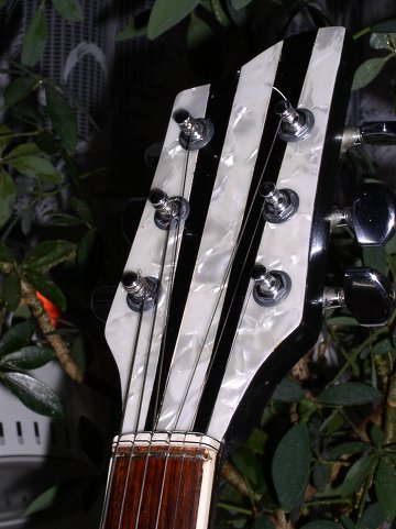

Just to continue with this one: today i succeeded in restoring the headstock. It is not quite identical to the original one, but its optical impression should come really close:
I was lucky and got some old celluloid both in black and in pearl. I think i should use smaller knobs on the tuning machines (old Schaller M6), but a lot more important is of course the work on the body: i need to make a new bridge after the guitar has settled again under string tension, and i need to do some work on the pickup holes. I still like the idea to convert them into sound holes - the guitar sounds so much better if these holes are not closed.
