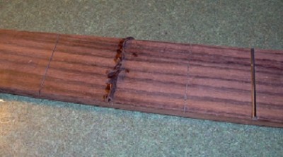

I took a different plane - my wooden rabbet plane - and was a lot more successful. The other - worse - neck is a bit lighter.
still unfinished - after taking that photo i sanded it and try to soak in some fish glue

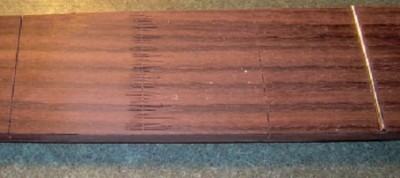

Well, and here the result - in the central part of the slot the glue has sunken in a little bit. As the new slot will cut through it, i'll leave it this way. Thanks for the help.

Just in order to show you my catastrophic result in all its extent...
- Posts: 1121
Re: Cutting fret slots failed. And now?
It looks good. After you sand that, you won’t even be able to see the slots (from 2 meters away). And, anything you can see will probably be hidden by the new frets. Good luck.
