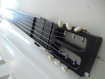

Awhile ago I've made a very simple stick bass.
After a couple of months of playing I tried hanging it around my neck instead of using a stand and this worked out fine, giving me more room to move around.
Recently I've made a six string version of it.
Overview stick quintar.JPG (112.98 KiB) Viewed 16042 times
Building it was a pretty straightforward procedure, it's just a tapered piece of plywood, stained with Indian Ink and finished with floor lacquer.
Building time was under 16h / 2 workdays (drying time excluded).

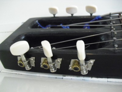

A few other reasons why I came to this design are that I'm always drawn to practical and simple (minimalistic?) designs. Further our home is crowded with (lovely!) people, so stacking piles of instruments is not an option. This design gives room for more instruments (I would love to make an 12 string version...) without taking up too much room.

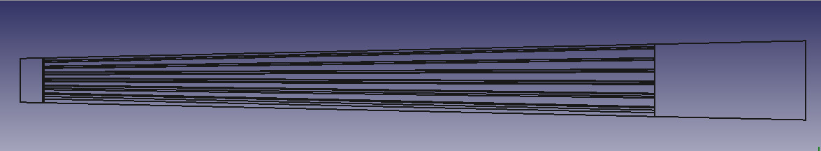

I'm planning to make prototype 1 of the stick quintar (SQ).
It will be similar to prototype 0, only with 12 strings.
The four lowest string pairs will be in octaves (C, G, D and A) and highest to in unison (E and B).
I've made a simple script for FreeCAD to draw the outline and strings of the SQ.
Although I know the approximate width of the nut and bridge (57mm / 2 1/4", 95mm 3 3/4"), I'm still pondering over the string distance between the corsed strings.
Right now I want to start off with a distance of 2mm (0.079") between the two highest strings and then increase the distance up to 3mm (0.118") between the two lowest strings.
I don't have a twelve string guitar around, so I gladly take some advice on this matter.
Hans
@Admin: is it possible to changes the title of this thread into: Stick Quintar: Prototypes
TIA

Posts: 2690
Re: Stick Quintar: prototype 0
Rather than FreeCad, you might start with the very friendly http://www.ekips.org/tools/guitar/fretfind2d/ which outputs to PDF, DXF and will let you play with the numbers to your heart's content.
Hans Bezemer
Posts: 373
Location: The Netherlands
Post by Hans Bezemer »
That's a useful tool indeed David!
I used it as a reference for the script.
I use a different approach for calculating the nut width, which fretfind2d doesn't supplies.
I use the following formula:
Nutwidth = 2*fretboardoverhang + sum(stringgauges) + (number of strings-1)*sidetosidestringspacing.
Because of the big difference in string gauges (a factor 10 between high and low), I want to use an equal spacing between the strings (measured from side to side, instead of measuring from middle to middle).
Further I need to know where I have to cut and file the grooves to place the strings at the side of the nut.
