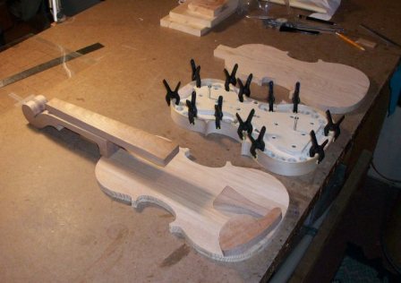

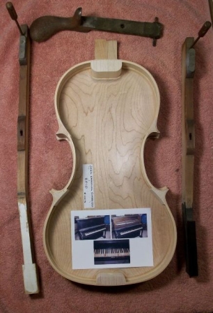

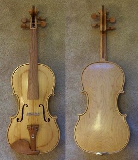

There is a thread on destroying old pianos in the Jam section of MIMF. I posted there about my old piano, which I broke up and made a violin from its wood. This is a continuation and overlap of that post.
Virtually every piece of wood in my violin Number 013, 2010 came from this piano. Except the purfling, corner blocks, neck center strip, and tail piece inlay (ivory and ebony). Even the bridge and sound post are piano wood. The musical soul of it lives on! --- in a new body --- (That reminds me of something else I read somewhere). It is one of my richest sounding violins.

A few more pictures of my Piano Wood Violin

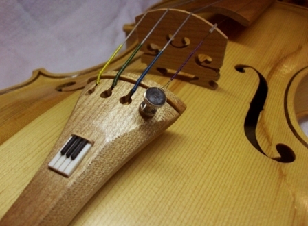

I like the keyboard icon on the tailpiece.
I would be tempted to cover the lamination glue joint around the top perimeter with a sunburst.

Ack! No sunbursts! Looks great as it is, and the lamination line only gives it character. I love it! What a great way to make the best of an undesirable situation.

Clay, Ya --- I loved that piano. I become emotionally attached to all my instruments. Violins 14 and 15 have backs made from the piano, and up to 20 have the linings and bass bars made from the spruce piano soundboard braces. Still have a lot of wood left.Clay Schaeffer wrote:That's a great story John,
So many old pianos have only the key tops saved. That you have made another musical instrument from the one which gave you so much pleasure I'm sure softens the blow a bit.
Barry, I think the piano inlay on the tailpiece sort of describes the violin.Barry Daniels wrote:I like the keyboard icon on the tailpiece.
I had considered inlaying a very wide shallow ebony piece, sort of like a double purling effect, but didn't think I could do it neat enough, and thought it would affect the sound, but I do like the sunburst suggestion. I like to be different, and I think I may sunburst a future violin.
Jim, I agree with the character. In Engineering, I believe that form, fit, function always looked the best.Jim McConkey wrote:Ack! No sunbursts! Looks great as it is, and the lamination line only gives it character. I love it! What a great way to make the best of an undesirable situation.

Nice work. It took me a minute to understand the strange shading in the middle of the instrument.
For your next, have you considered a veneer strip of walnut in between the two pieces?
I love the keyboard motif on the tailpiece.

I really like that idea of the walnut between the two layers. I have enough unsplintered soundboard left for one or two more tops. Perhaps when I finish the latest two I'm working on with standard fronts. Usually, I'm thinking about the next ones halfway through the current.

Really like this thread. Maybe I missed something, but what is the roundish staining all around the top plate maybe an inch in from the edges? Wait! reading this thread again, I see it is from a laminated glue joint? Nice fiddle but that doesn't look right.

Thanks, Doug.Doug Polk wrote:Really like this thread. Maybe I missed something, but what is the roundish staining all around the top plate maybe an inch in from the edges? Wait! reading this thread again, I see it is from a laminated glue joint? Nice fiddle but that doesn't look right.
Yes, that is a laminated top. I like to think of it as not looking "normal" <g> --- gives it personality --- shows that it came from it's "Father". If I ever do another from the piano wood, I think I'll use Steve's suggestion of a walnut veneer between the two halves.

Aside from a certain breed of archtop guitar (the "German carve"), I've never seen a carved top/back instrument with plates laminated in that orientation. Is there any particular risk of separation, or is such a glue joint as good as any other (assuming appropriate joint preparation and glue application)?John E Giarrizzo wrote:Yes, that is a laminated top. I like to think of it as not looking "normal" <g> --- gives it personality --- shows that it came from it's "Father". If I ever do another from the piano wood, I think I'll use Steve's suggestion of a walnut veneer between the two halves.
- Posts: 140
Re: Piano Wood Violin
Jason,Jason Rodgers wrote:Is there any particular risk of separation, or is such a glue joint as good as any other (assuming appropriate joint preparation and glue application)?
I don't know. I sure hope not. I saw a picture once of an instrument, cello I believe, done by a well known maker, don't remember who, that had increased the size by adding material to the upper bout in a similar fashion.
I used hot hide glue. It holds center seams and other structural parts acceptably. Why not this lamination?
If it ever does separate, I'm in big trouble. Perhaps a pro would know how to align for reglue, but I don't.

If you make a plaster mold of the top now while it is in good shape you will have the appropriate form to put it back in alignment if it ever comes apart.
I have been wondering why the dark area along the glue line, is it oxidized or UV darkened wood, or a whole lot of glue? I'm guessing the surfaces of the old soundboard are darkened by the UV it was exposed to. Like I always say, "if you can't fix it, feature it". More layers would form a nice pattern.

The dark area: Again, I don't know. I assume it's a combination of all three, most likely oxodized and glue, though. Soundboard basically in the dark all those years.

I like the visible glue line; put in another vote for "if you can't avoid it, make a feature of it"!
Did you use regular HHG? That could explain why the line is so dark and visible. High clarity hide glue is nearly colorless, so even if the line was relatively thick, I would think it would be barely visible. If you want to try an ounce or two of high clarity hide glue for the next one, drop me a note. I purchased a small barrel of high clarity, 192g hide glue 12 years ago, and still have 3/4 of it left... <bg> It'll last me my career, and then some.

I also kind of like the way the glue line looks. Trying to hide it or cover it would have looked a whole lot worse. I also am a believer in "making a feature of it".
The glue used was Behlen Master, from International Luthiers (now out of business). I think Woodcraft and Stewmac also sell it. I learned that it has a gram strength of 164. Been wanting to try some higher gram weights. I've read hundreds of pages about glue, and some think that 164 is too weak, others, just fine. I'll take you up on your offer of the high clarity stuff. I'll contact you.

The glue may have been really old stock. International Luthiers Supply was not selling much volume for years before they went under. Fresh HHG would be nowhere near that dark.

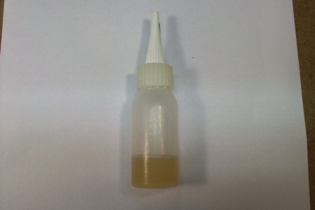

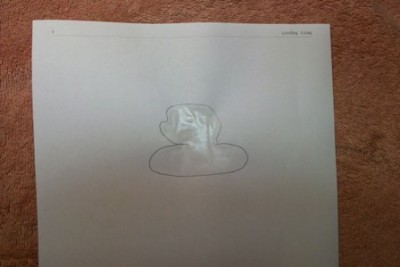

Barry,
Did an experiment. I think the color is from the wood itself.
Cold glue in dispenser: Glue spread on white paper. Glue area circled with pencil: Original color of Soundboard used:
