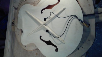

On my arch top I glued the Piezo sensors just as you would on a flatop guitar.
The Volume is a little low even with LR Baggs pre amp.
Would your Optimal placement of the piezo pickup sensors Help this ?[quote][/quote]

I use JJB Prestige 220 piezo sensors, glued to the inside of the front plate in front of where the bridge posts are located. A picture might help: I get plenty of volume, even direct into a channel on an acoustic amp or PA head. A preamp can warm up the tone a bit, but I get by pretty well direct. The signal strength is at least as hot as the neck mounted humbucker pickups.
I use gel superglue to attach the sensors.(You get slightly less volume if using the putty that comes with some pickups). The position of the bass side sensor is intentional - having it further away from the bridge post location helps to balance out the treble and bass volumes. Of course, this may be specific to the X-braced design I am using.
Does this help?
//mike

Thanks Mike this does help. I used the triangle shaped Dazzo pickups. I think my problem is my location not the Dazzo.
It may be a while before I get time to change the location.
