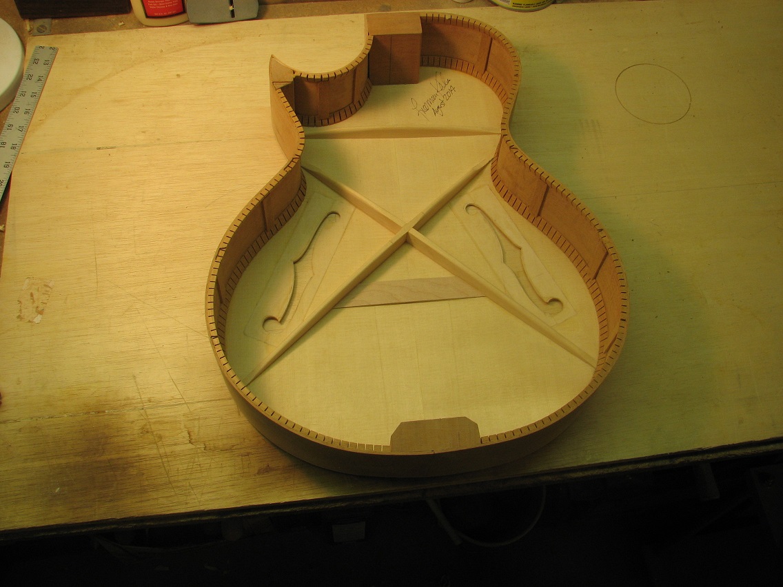

Hans, I have built two acoustic guitars sort of like what you are suggesting. The first was built from the ALS ES-173 plans but were intended to be totally acoustics so I used a single piece of spruce thicknessed to slightly less than 1/8 inch and X braced it in a 16 foot radius dish. That gives a little doming but not nearly as much as you would see on a carved topped guitar

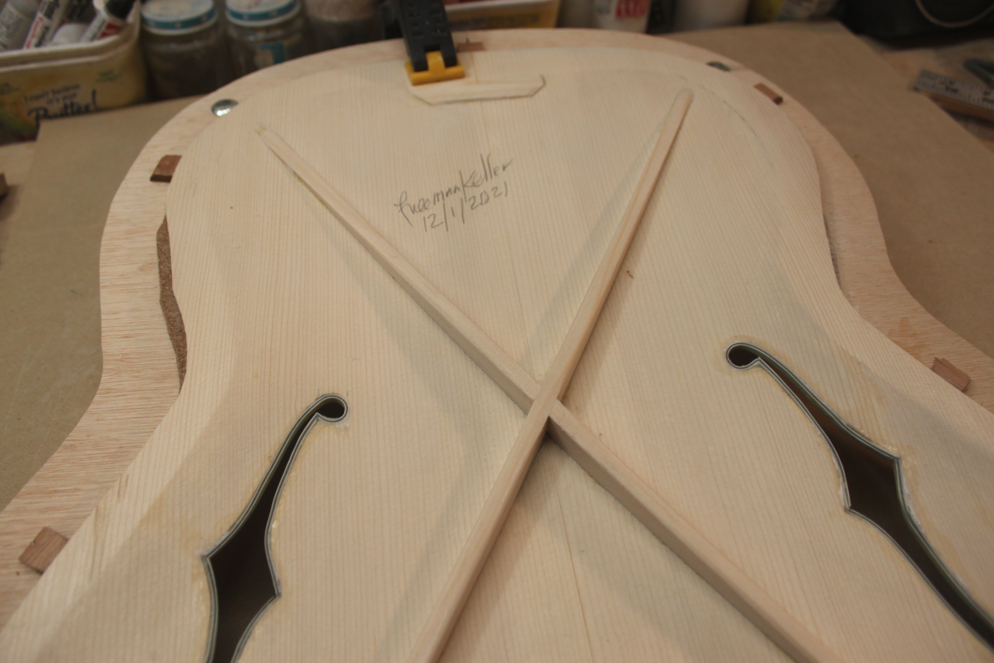

I also just completed a 16 inch acoustic archtop and used Benedetto's arching (5/8) and thicknessing (1/4 center to 1/8 recurve) with X bracing.
Both of these guitars used commercial floating bridges and tail pieces - it would have been easy to modify the bracing to mount pickups as with a 175. I do have other pictures of these if you are interested.
