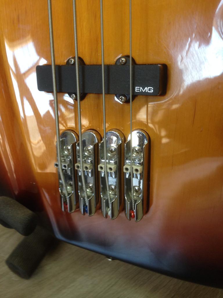

I have a Lodestone PP4-TS bass guitar and I need to find a bridge for it. Anyone out there know where to go for that?

Sorry, I don't understand. Do you want to put a one piece bridge on it, or do you need a 4 piece bridge as shown in the picture?
Re: Lodestone PP4-TS Bridge
I need the original 4-piece bridge. Thanks.

There are lots of single string bass bridges out there that would probably work, but none that I can find associated with that brand.
Ok, thanks. Those bridge pieces are somewhat unique in that they have ceramic saddles, so I would like to replace them with original parts.
My guess is that ceramic is really Graphtech "tusq'" material, which is what I use for my bass saddles. Send a photo of a saddle to the folks at Graphtech and see if they recognize it. The rest of the unit looks like a Korean single string bridge which you might see on eBay or even in the Allparts catalogue.
