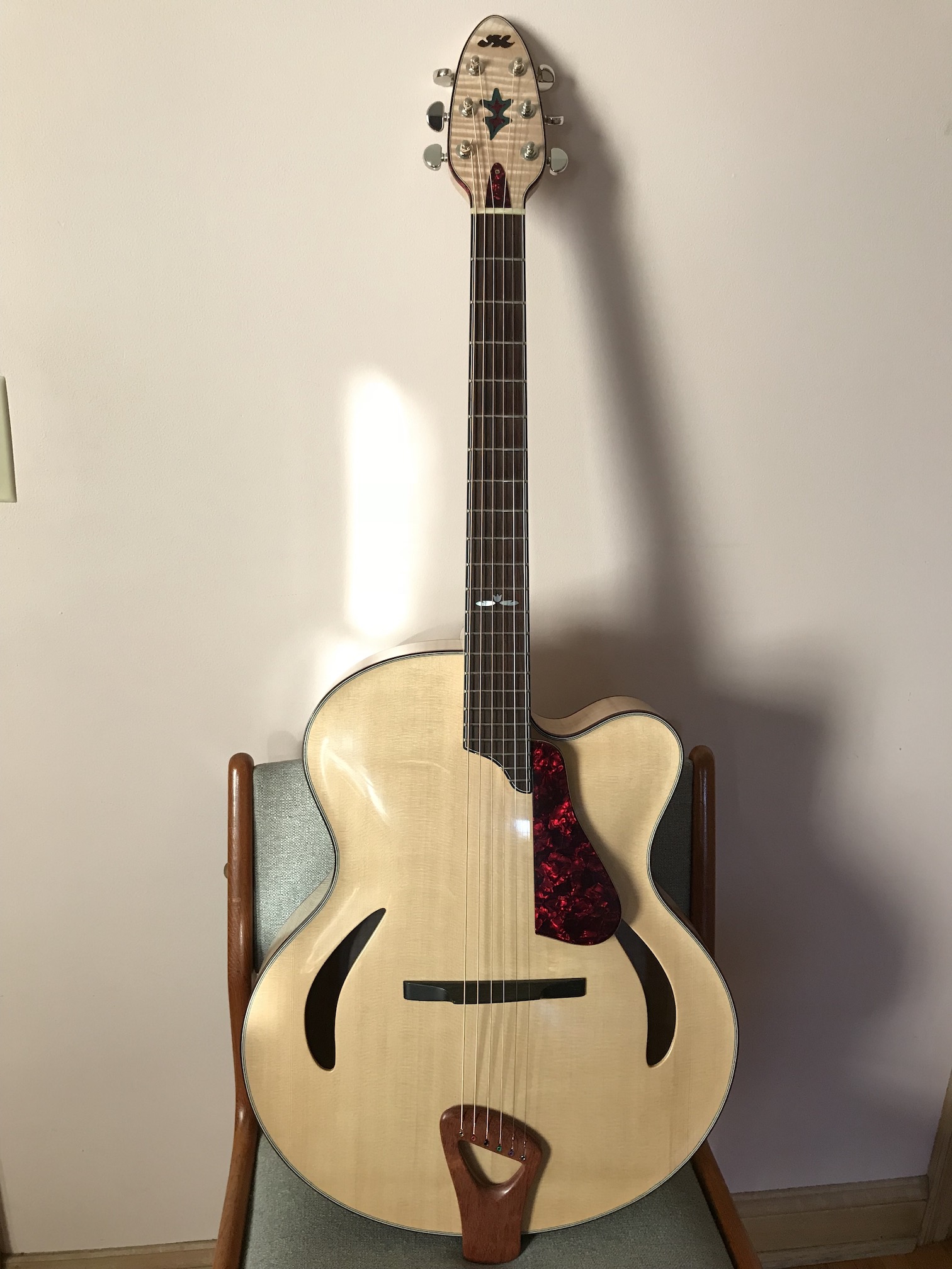

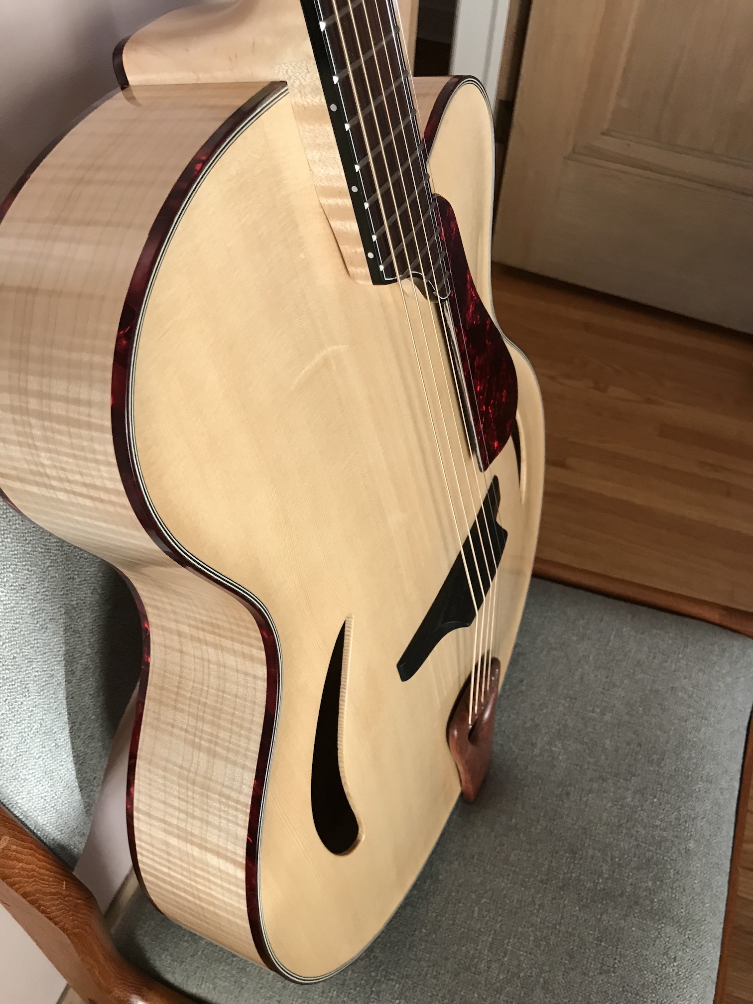

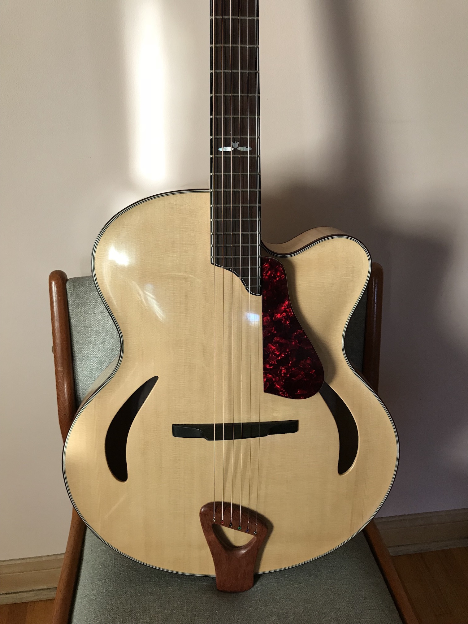

Never underestimate the importance of details at the bridge in bringing out the sound of an archtop!
I had originally made a two-piece adjustable ebony bridge for this guitar. I thought I’d done a good job with it. The strings all sounded cleanly, and the intonation was excellent. But I felt there was something lacking in the tone of the instrument. It lacked clarity and definition, and felt somewhat unresponsive. I attributed this to the sitka spruce top, and my carving and bracing work.
Then I decided to try making a one-piece bridge for it, again using ebony. When I first got it strung up with the new bridge, the action was a little high and the sound was . . . not that much different. This seemed to confirm my feelings about the top plate.
But THEN, I recut the top of the one-piece bridge to bring the action down, and I paid a LOT of attention to cutting the string slots, making sure they were angled back toward the tailpiece, and widened slightly in that direction, to ensure a clean break over the front edge of the bridge. When I brought the strings back up to tension, it sounded like a completely different instrument! Really open and “sparkly” on top with a solid, clean midrange. And significantly louder. My wife even remarked on the increased volume.
So the lesson is, the small things really matter at the bridge. It makes sense when you think about it. 100% of the sound energy of the instrument is transmitted from the tiny point at which the strings contact the bridge. The vibrations at that point are very low amplitude and very high impedance, so very small physical changes have a big impact. Also, for reasons I don't completely understand, high action seems to have a detrimental effect on tone - too bad for me, because I tend to like fairly high action.

Are the tailpiece holes drilled all the way through the tailpiece?
I like that look with the D’Addario colors exposed.
- Posts: 180
Re: Small changes make a big difference at the bridge
Sorry Eldon, I've been away for awhile. No, the holes don't go all the way through. They are just deep enough to hold the ball ends, and lined with brass tubing.
