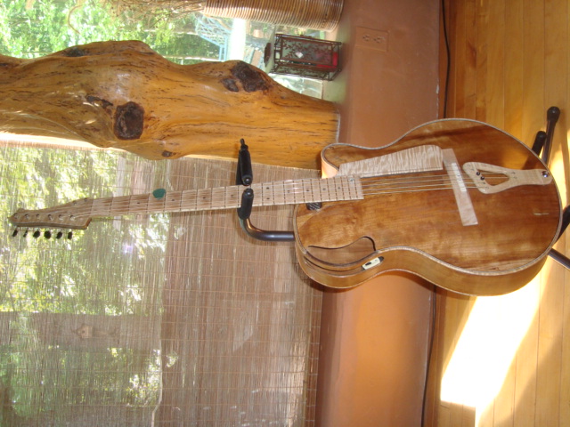

Just finished my 27 ½” scale, 8 string baritone (8 string like Taylors tuned B to B) so it fits in a standard case.
It is in the parker-sh style and has a laminated 1mm cherry/linen cloth top.
This top was my first test molded top in the vacuum bag.
It looked good so I thought I would use it on the baritone.
I’m not happy with the sound, not very loud and a bit tinny.
It does have the baritone sound I’m used to, just a bit tinny.
The sides are 2 and ¾” and has a ¾” arch both top and back. I was thinking this might provide enough air for the bass response.
The sound hole can be made larger on this guitar.
Future thoughts would be to increase the sides to 3” or use a taller arch with a shallower bridge.

.016 - .070 Elxer . these are designed for the Taylor Baritone 8. Tension is less than Taylors I think. It has been a while sense I played one.
This guitar and my previous one has a free zero fret with only enough down pressure to keep the strings from buzzing on the zero fret. Bends are softer on the fingers, because the strings will slide along the zero fret, as there is no nut at the zero fret.
I think more down pressure at the bridge would help with the volume.

How tall are your sides? I went with 2 ¾”. Do you think 3” or more is what is needed for a baritone.?
Also, I don’t think the tone wood will make a huge difference as Taylor uses both spruce and Mahanoy.
