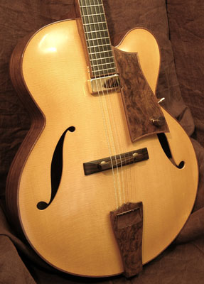

Isn't this a full sized floating humbucker?
- Attachments
- front_36.jpg (28.64 KiB) Viewed 33516 times
- Posts: 3247
Re: full size floating humbucker on archtop
No, that is a special low-profile humbucker built for an archtop.
