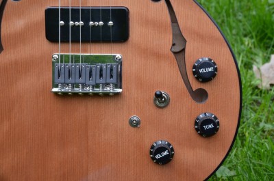

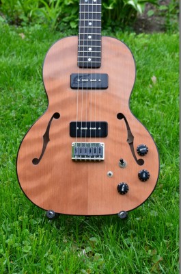

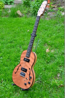

It's been a while since I posted anything new. Here's my latest build, just finished. Still a few tweaks to be made, but my initial reaction is that it plays beautifully and sounds great.
The semi-hollow body is African mahogany with a curly redwood cap. Neck is Spanish cedar. Fretboard is ebony. Bindings are African blackwood. The P-90's are from Guitar Fetish. The guitar also has a Graphtech Ghost system with piezo pickups in the saddles. The bottom volume control is for "acoustic" volume level. The mini switch selects between piezo, magnetic, or both. A stereo output jack allows the piezo and magnetic outputs to be routed independently, or plug in a mono cable to combine them together.

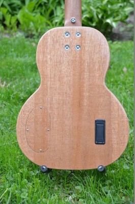

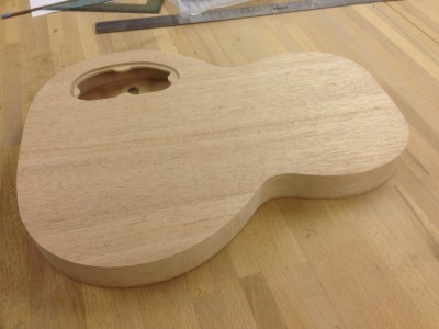

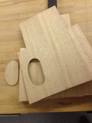

Postby Andy Bounsall » Sun May 21, 2017 10:18 pm
Bob, I sliced the back off. The cover was cut out of the back with the scroll saw. The body was hollowed out and then the back and glued on again.
