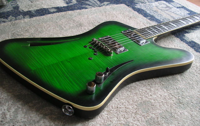

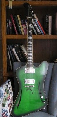

I don't see any problem, just move the bridge back by 3/4 inch and reposition the bridge pickup back a little other than that I can't see a problem at all. The string tension will be a little more but there's no need to modify the neck at all.
Here's a picture of a 25.5 scale firebird type guitar I built a while ago, also has 24 frets.
