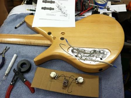

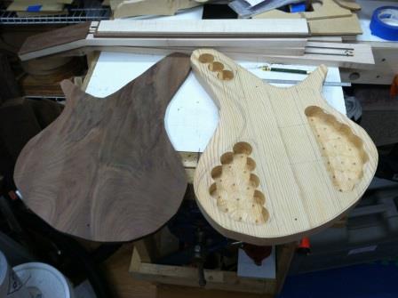

Top and back, ready for glue up. Fish glue was used throughout. I've glued up a couple bodies in a vacuum bag, and I'm happy with the results.

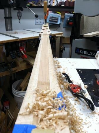

The neck has two 1/4" CF tubes and a 3/16" threaded truss rod in a shallow curved slot. This is the topic of my thread "When the truss rod doesn't do its job." My friend has been playing the bass for a few weeks now, and he's only had good things to say about it, so this may not be an issue. If it is (he lives in Minnesota, land of wildly swinging humidity), I have a plan to fix it.

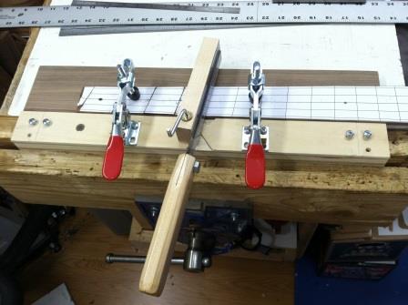

Here's a new jig that I'm rather proud of. I got the idea for this adjustable fret slotting saw in a recent thread here (that I think was linked to the ANZLF). It works really well: lightly glue on a fretfind2d template, line up the saw, lock down the clamps, saw until the depth stop hits, repeat. The guide has neo magnets to keep the blade on track. No radius on the fretboard, by the way.

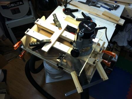

Here's another jig I love, my Myka neck pocket jig. It takes a little work to get it set up, but the resulting pocket is a perfect fit.

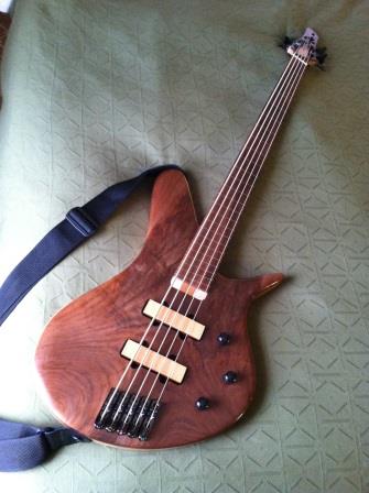

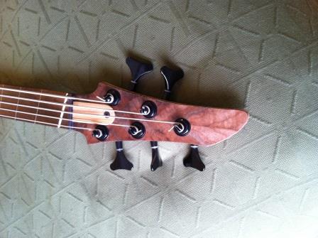

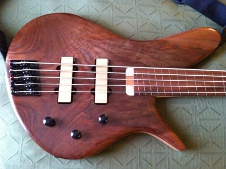

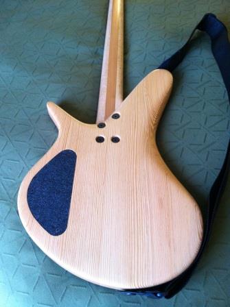

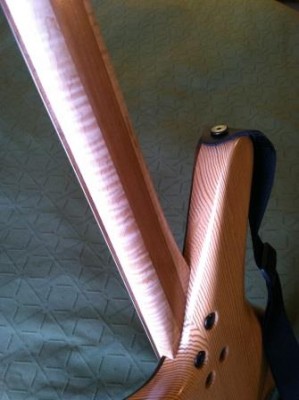

Ok, I'll skip some of the minutiae: on with the glamour shots! I didn't have time to take pictures at home, so these are taken in the hotel room, just hours before I presented it to him!
Everything was finished with a splash coat of Zinnser's sealer shellac and about 5 coats of Formby's tung oil. The fretboard got a thin CA treatment to harden it up a bit.

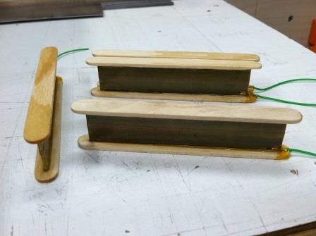

Here's a little more on the electronics, for those who are interested in pickup construction.
The cores of these pickups are made with laminate steel, taken from a softball-sized transformer. Each core has 3 layers, but that's only about 1/16"! The flatwork is just popsicle sticks glued on!

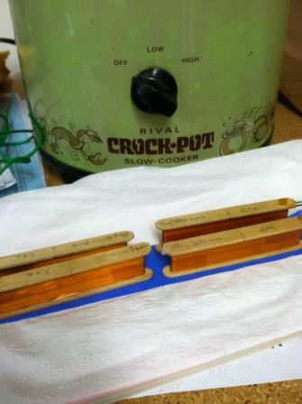

I pot coils in wax, in an old crockpot.

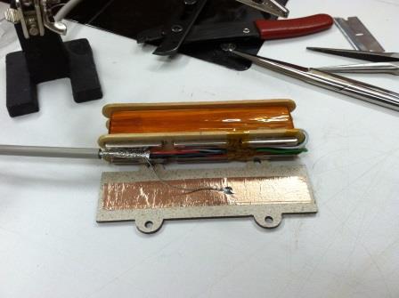

And here I'm wiring them up. If I remember correctly (don't have my notes on hand), the neck coils each got 4500 turns of 43awg, which brought it up to about 9k or so. The bridge coils each got 5000 turns of 43awg, for somewhere in the neighborhood of 10k total. Those are 1/8"x1/8"x1" neodymium magnets on the bottom of each coil. The hookup wire is USB cable. Great stuff: black, white, red, and green leads, with a foil shield and braided ground. I'm a little bummed that I didn't take any pictures of the pickup covers, because they were beautiful! Walnut boxes with Doug fir caps (the opposite of the body!).
I'm getting better at soldering! The cavity was shielded with aluminum foil tape. The control cover is 1/8" ABS sheet.

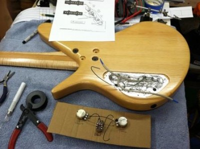

ahh yes, the control template on the cardboard. I like doing that one too :)

Yes, Eric, it means no sloppy solder falling into the cavity, or the edge of the body (don't ask me how I know this).
