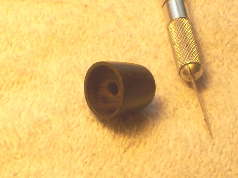

Here are a couple of knobs I made (took me a while to find the picture)-
a small knob.JPG (13.35 KiB) Viewed 11041 times

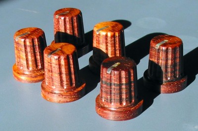

I forgot all about the counterbore, thanks for bringing that up. I can't emphasize enough how much easier all of this is on a small metal lathe.
Here's a photo of some of my recent efforts:

David King wrote:Here's a photo of some of my recent efforts:
Those are very nice David. How did you do the flutes?
Posts: 2690
Re: Wooden Knobs: How Hard Can It Be?
Thanks David,
The flutes are done with an indexer on the milling machine using a 1/8" ball nose cutter. It's a fairly slow process to end up with a wooden wirenut.
