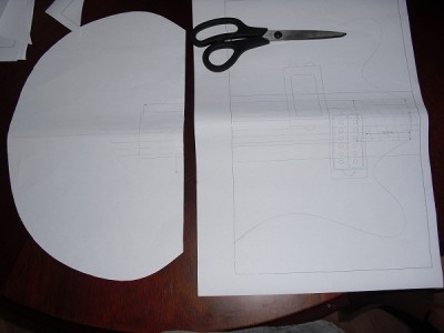

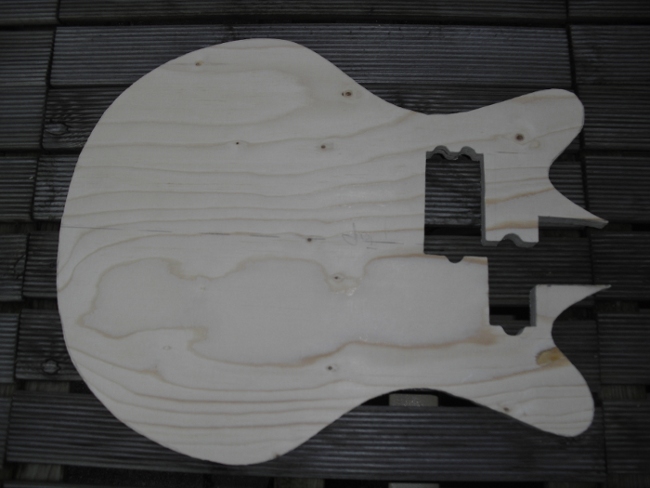

Making the body

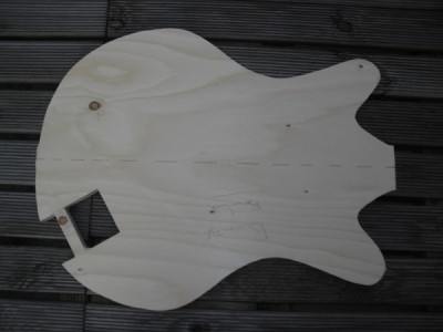

I've started out by making a drawing and printed it and cut out.
I drew the outline off the body on a piece of plywood of appr. 380 x 480 mm and sawed it with a scrollsaw set with a coarse toothed saw.
The body will be made out of 3 piece of plywood. With the first layer I sawed out the neck pocket and the cavities for the pick-ups. In the second and thirth layer I sawed out the cavity for the jack input.
Hans
Hans

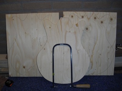

- Hans Bezemer
- Posts: 373
- Location: The Netherlands
Re: 7-string guitar: All plywood and using simple handtools

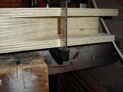

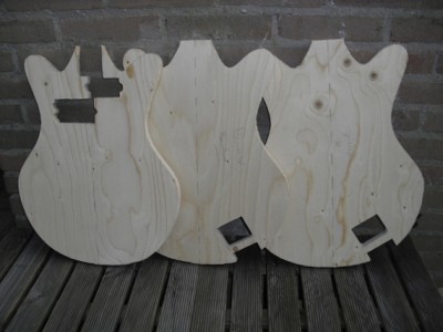

I've sawed the plates. It's a bit time consuming using a scrollsaw (I'll be using a coping saw the next time), but it has some kind of relaxing quality's also...
I was a bit afraid that the plywood would splinter, but it turned out fine.
I've made a little error by using the top plate as a template (instead of the paper template) for the other two plates, making the other plates about 0,8 mm wider, so there will be some more sanding to do.
Hans
Hans

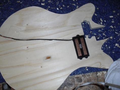

Making channels

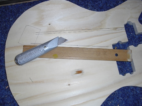

Now I've made the channels on the inside of the top plate.
The guitar will not have a tone or volume pot because I never make use of them.
There will be two separate outputs. One for the bass side and one for the treble side.
I made the two channels by scribing the groove with a Stanley knive and then chiseling the wood away with the bevel of the chisel downwards, which worked ok. This was a good warm up for making the truss rod groove!
Hans

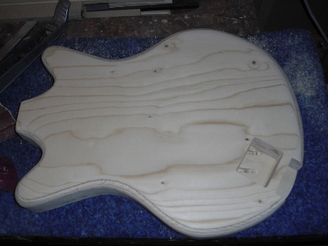

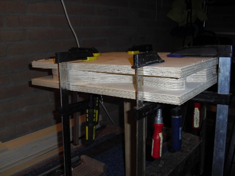

Glueing up the body
Glueing up the plates. I did this in two runs, first the middle and bottom plate and then the top.
I had some difficulty aligning the plates, but in the end it turned out ok.
I used two pieces of plywood and a bunch of clamps as a press.
Maybe next time I'll nail or screw them down while glueing. Any suggestings?
I kinda like the look of the side of the body, although there are some gaps which need to be taking care of later.
I want to use Danish Oil as a finish, maybe I use some waterdye to stain the wood...
But first things first...
Hans

- Hans Bezemer
- Posts: 373

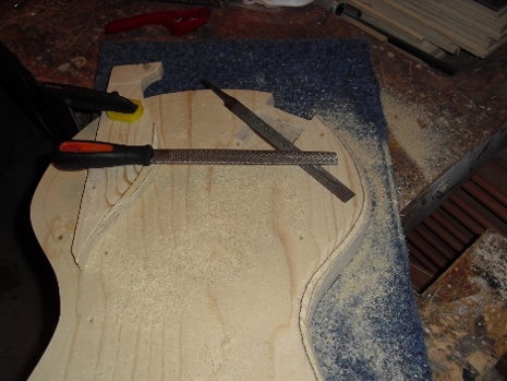

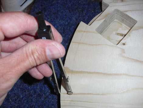

making the edges of the body round

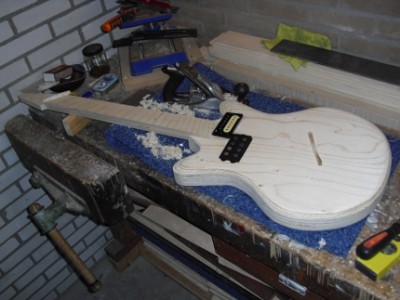

When the glue dried, I sanded the body up to 120 grit.
It took a while before the sides where nice and smooth.
As said before, I'm fond of the look of the side of the body.
I scribed a line with my compass and made the edges of the body round using a surform, rasp, files.
After that I sanded the body using 80 - 120 - 180 grit sandpaper.
I've also filled a gap in the side of the body with a piece of scrap plywood.
There are still some little gaps in the sides (about 2 mm wide), because of the knots from the pine. I'm not sure what I'm to do with them. On one hand I can fill them with sawdust and glue, on the other hand they contribute to the plywood look...
Next week I'll post some pictures of the neck.
Hans

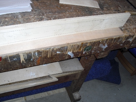

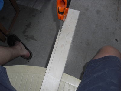

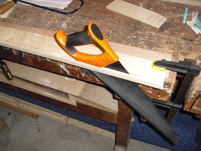

I glued to 9 mm pieces of Birch plywood together and I drawed out the neck.
I sawed the straight parts with a handsaw leaving appr. 1-2 mm wood, which I'll plane down.
I used a scrollsaw for the headstock.
The neck will have a Fenderstyle headstock, but will be rather thick (18 mm). This is no problem for the tuners, but I'm a bit worried about the string angle. I'm thinking of countersicking the tunerholes or using some kind of stringguide.
I was a bit worried about the strenght of the Birch, but after glueing the 2 pieces together it feels pretty stiff.
Hans
Hans

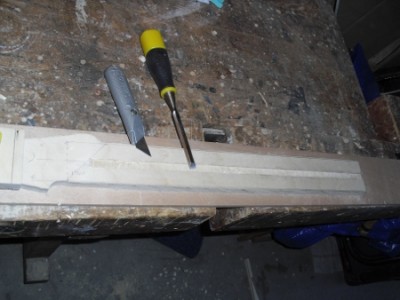

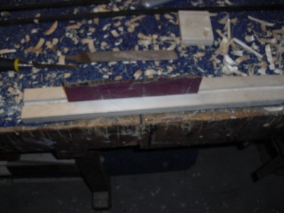

- Hans Bezemer
- Posts: 373

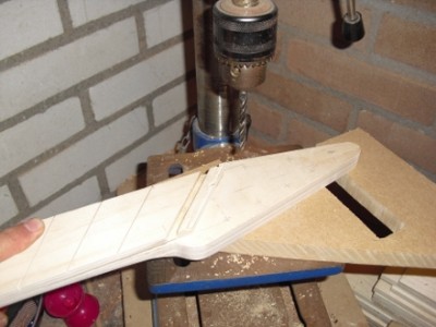

I've made the truss rod groove, by cutting the outside lines using a stanley knife and a ruler and removing the wood with a chisel. Again, I only use my chisel with the bevel downwards, this gives me a good control on the process.
Had to make appr. 8 runs of cutting and chiselling to get a 10 mm depth, but it was a pretty straight forward procedure.
I've sanded the groove using a piece of sandpaper wrapped around a big flat file (sorry for the bad picture).
For this neck I'm using a 10x10mm square steel bar as a truss rod, because I'm curious if it will work.
The bar has a nice snug fit in the groove.
Hans
Hans

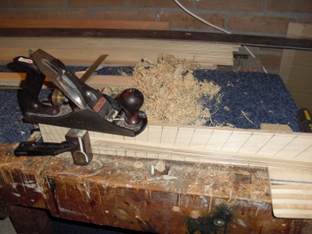

- Hans Bezemer
- Posts: 373

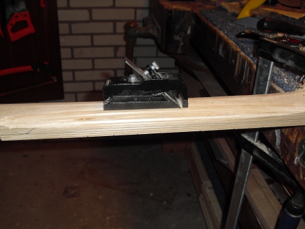

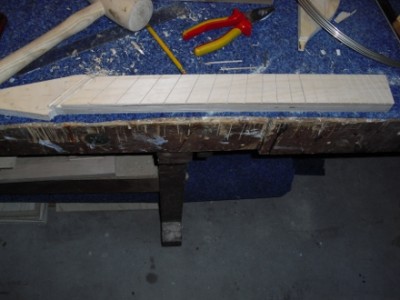

I've made the fretboard from a 9 mm piece of Birch plywood, and tapered it with a bench plane.
To avoid tearout at the ends of the fretboard (because of the cross grained inner layers of the plywood), I've left the plywood a bit longer on both sides and sawed to the right length when it was planed down to the right taper.
I made sure that my plane was sharp and that it shaved just a thin curl.
Unfortunately I've slipped one time with my plane, leaving a small bevel on one of the sides.

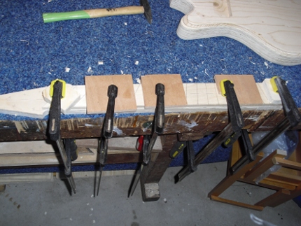

I've glued the fretboard on the neck, using two nails (one on the 1th fret and one on the 12th fret) to keep it in place. I've put some masking tape on the truss rod to protect it from the glue.
When the neck dried, I've shaped the sides of the neck using a plane and sandingblock and made it fit into the neckpocket, which was a pretty delicate job, but it fits all right now.
Next up: sawing fretslots and shaping the neck.

I've cut the fret slots using a small tenon saw. The layers of the plywood are a good guide for the depth.
Although I've used this saw with another build with good result, this time the fret slots are a little bit to wide (the frets hold on the sides but pop up in the middle), so I'm afraid I have to epoxy the frets in. Any other suggestions?
I've adjusted the saw for a future build.
Lesson learned: check twice, saw once...

Made some more progress:
I shaped the neck using rasps, files and a small nose plane (I've tried to use a spoke shave but this didn't work on the plywood because of the cross-grained layers) and sanded it up to 180 grit.
The neck is about a inch thick (27 mm).
After that I drilled the tuner holes and made the nut out of a piece of bone.
I've attached some sandpaper on a piece of plywood to create a sandingboard for shaping / sanding the nut (and also the tips of my fingers... ouch
Hans
Hans

The headstock is too close to the fingerboard. You hand will run into it when trying to play an F chord. Typically, a transition from the fingerboard to the headstock is used.
