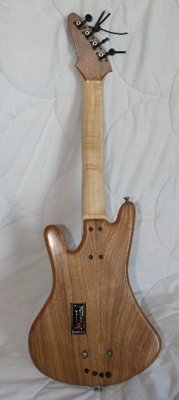

Back view of guitar
Back view of guitar

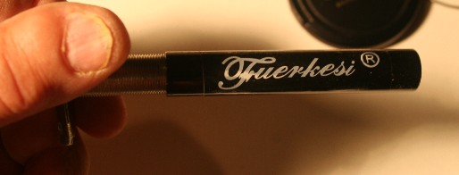

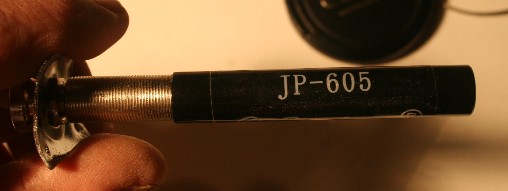

The preamp is an endjack type of preamp--
One side of label
One side of label
Small electronic view.JPG (24.82 KiB) Viewed 10074 times
Other side of label
Other side of label
Installed in Guitar
Installed in Guitar

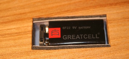

The battery box was a problem.
I decided to have this on the back side and lined it with a piece of computer mouse pad. It is snug enough to hold the battery securely, but it can be removed easily.
Battery box
Battery box

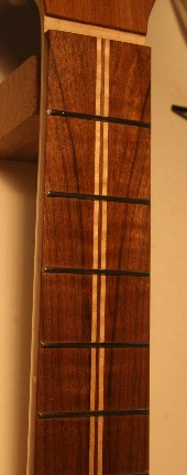

I saw a picture of a vintage ukulele which someone was repairing. I copied this somewhat.
After it was together, it was quite nice. I hated to use any position markers on the face, so I just placed dots on the side.
The open grain of the walnut had me concerned about getting dirty. I decided to put several coats of shellac on the surface. I did not porefill however. I may regret this later.
Fingerboard no strings

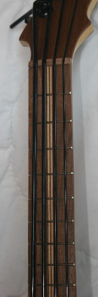

The fingerboard with strings is not quite as dramatic, as the big polyurethane strings hide a lot of the stripes.
Fingerboard with strings
