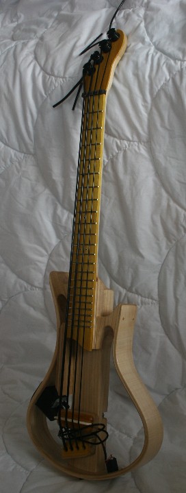

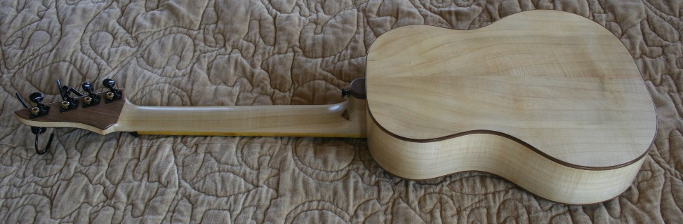

Ashbory type bass
- Posts: 673
Ashbory type bass
22 inch scale, UK-2000 pre amp.
Maple sides and neck. Osage headstock and neck veneer. Ebony nut. Bone saddle.
Neck width at nut is 1.70" Width at 12th fret is 1.095"
Nut spacing for strings is total span of 1.4" . Span at Saddle is 1.65".

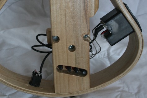

As I was working on this, I set up a board to check for the "proper" intonation. I found that the strings really did not need any intonation.
The height of the strings above the first fret (as I set it up) was .030" for the G string and .045" for the E string.
The height of the strings above the 12th fret was 11/64".
The open appearance as opposed to placing a face on instrument-- I made one with a face (which I showed a few weeks ago), and made this one open. They both have some charm.
I made the bridge "adjustable" by having three threaded screws supporting the bridge. It can easily be lowered, and the intonation can be adjusted by using the third screw as a pivot. Intonation is not much of an issue with this kind of instrument.

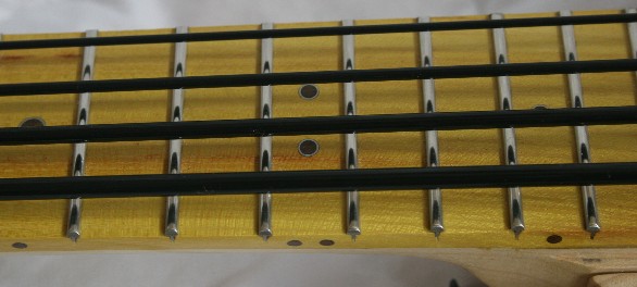

Here are more pictures--
The markers are aluminum tubing with walnut.
Finish is spray rattle can lacquer.
I did put a couple of quick coats of shellac on the fingerboard to keep it clean while doing the fret dressing. Worked quite well.

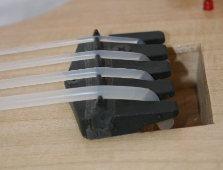

Regarding Bridges--
The first Ashbory type bass I built, I used the "Integrated pickup and bridge assembly for DeArmond and Fender Ashbory basses" that was sold on the Largesound.com website. It does not currently seem to be listed. I paid $72.00 for this piece.
I would recommend that you use something other than this item.
The pre amp and pickup combination was not very loud.
- Posts: 673
Re: Ashbory type bass
The second Ashbory type bass I built, I used a maple base, osage cap, with a piezo pickup under a bone saddle. I made the saddle the correct thickness to allow it to sit nicely on top of the piezo pickup.
The block of maple has 3 holes in the bottom of it.
The center of the guitar board has 3 matching machine thread screws. These can easily be raised or lowered to give different height adjustments.
Two of the screws are toward the front of the saddle. The third is at the back of the saddle. If you need to get a little more or less scale length, you can do this by moving the third screw.

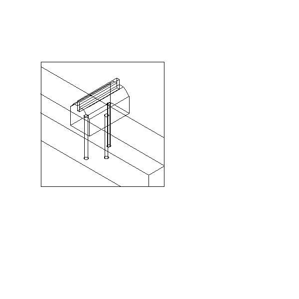

Very nice Ashbory bass, Steve. I see you went with fretted this time. I'm surprised - and pleased - to hear that you didn't have intonation issues with it. I had to have a significant angle on the bridge on my fretless if I wanted the to hear an octave at the 12th fret line marker position for all strings.
I can't quite picture how the bridge adjustment on yours works - any more details on that?
Brian.
Brian.
- Posts: 673

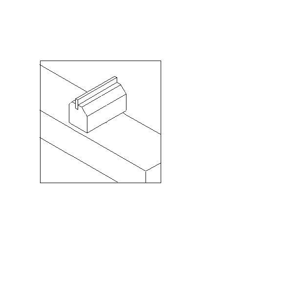

The bridge is sitting on three screws. These can be raised.
Here is a cad drawing--
Really not too complicated.
Since the frame is completely open, you can adjust the screws easily.
I plan on eventually getting to a fretless, but not quite there yet.

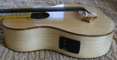

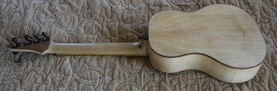

Continuing to try to figure these out, I make the Bass Uke kind of instrument.
Maple back sides and neck, osage fretboard, headstock veneer. Osage and maple bridge. Bone saddle. Undersaddle piezo. Uke 2000 pre amp.

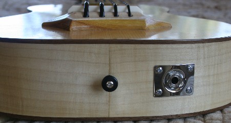

Close up of the bridge--
End view--
Built with a 22 inch scale. Baritone Ukulele size for the body.
End view--
