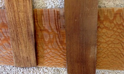

Regarding the osage orange, I already have it and thought it might complement the lacewood color. I'll try taking a pic of them juxtaposed to see how it looks (the osage oxidized and the lacewood wetted.)

Here's the pic - Honduran rosewood on the left, osage on the right. That surface probably has 8 years or more air exposure, so not sure how long a freshly cut board will take to darken - maybe use ammonia as Alan notes above.

Not a big fan of the osage, I'm sorry to say. I'd probably go rosewood on a fretboard. I like the 501 tuners, there are other higher end choices and one of the things that blings out a big guitar are custom wood knobs. For me, and it's just my opinion, if you need to have a control panel in the side of an acoustic, just buy a Takamine. I hate the control panels.

Well, I guess there's no love for osage orange here :lol: - that's fine.
Freeman, he definitely has to approve everything before construction starts. For continuity I'll be putting the lacewood on the headstock too. I thought the osage color was more consistent, at least the piece I have, though I like contrast if it works. I'm unsure about the binding, bridge pins and endpin or strap button(s). I'll figure out the rosette when everything else is pretty well set. I'll see if he's OK with open back tuners, though I like closed (my first cheapie guitar when I was young had 3 on a strip open, and they've seemed cheap ever since.) I mainly want them to work well, last long and look good.
