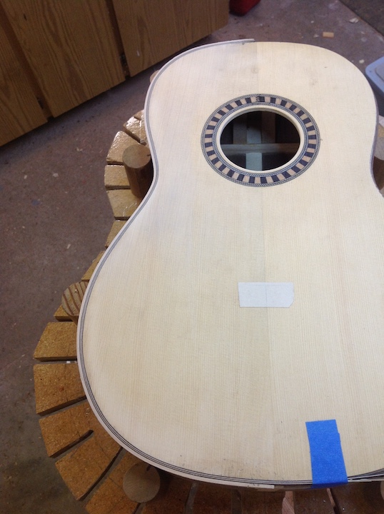

I just finished binding a body that has the back purfling and side purfling mated to the purfling of the back strip and end graft. The next one I am going to do will not have any purfling on the end graft and no center strip. I think I'll try starting at the waist and fitting the ends last. The much simpler joint should make this more doable.

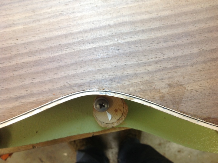

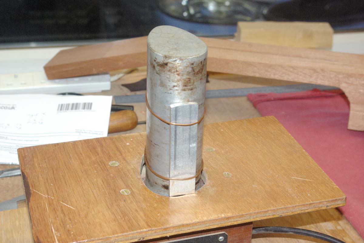

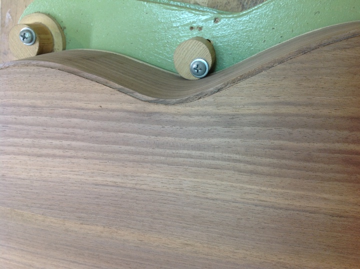

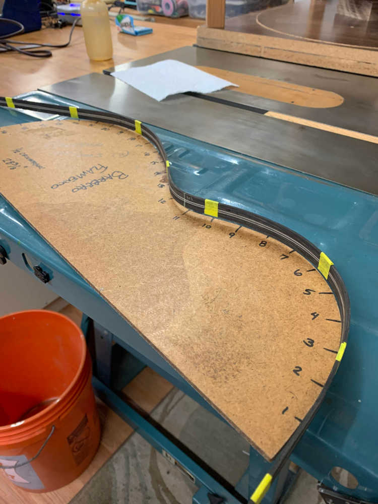

I have had by far my best results with bending the bindngs + purflings in the side bender along with the sides.

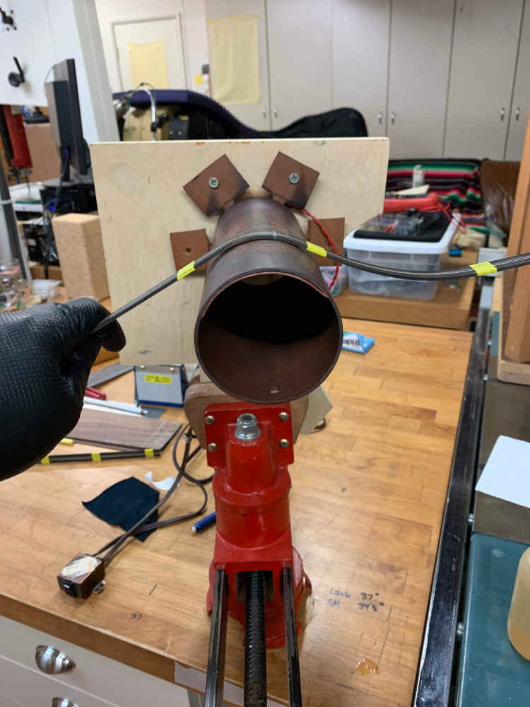

One thing that hasn't been talked about much is the vertical bend required with a highly arched back which I use. Also round the sharp cutaway. I always struggled with this, given that around a 6 mm binding really doesn't want to bend in the vertical direction.
I devised this last time I did it and it helped me a lot. Just an aluminium bar with a shallow curve on top strapped to the bending iron. You can maintain the existing waist curve while pulling the binding into it's vertical curve. Easily removed for ordinary bending use.
Cheers Dave

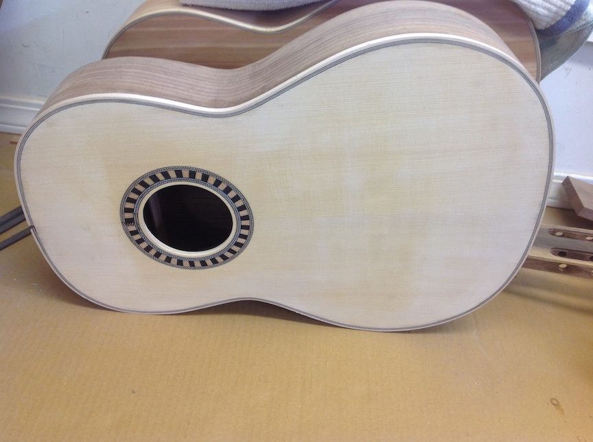

I just happened to get started on a binding job about the time Brian posted this subject, so I thought I’d take some pictures.
I needed to improve on binding the waist as I’d had some sloppy areas occur. I was using a 1 1/2 inch dowel cut in half and affixed to a bar clamp. This to press binding/purfling into the waist. So I came up with this, trying to match the curvature of the waist, not only to have the sanded cauls change shape overnight but the sides aren’t exactly the same, so a very good lesson is that if you can’t make it accurate; make it adjustable… tomorrow.

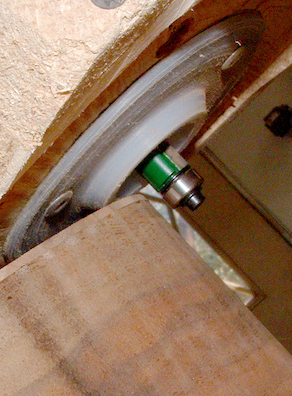

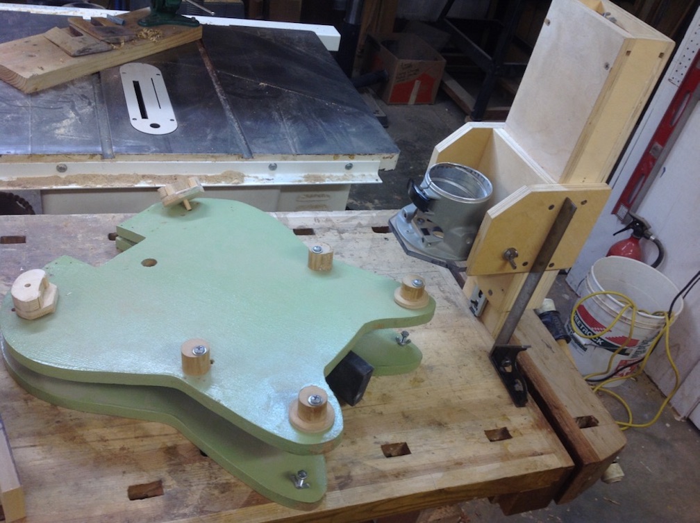

I tried this job by hand and with a hand held router. A bearing guided router bit on a stand is the way to go for me. I have springs inside to provide the lift for the router. Made one with a counter weight but this one is easier to store.
I scribe the purfling line first. I cut with a climb cut and don’t change directions and you’ll get some runout with that method. I’ll usually have to clean up this line with an exacto knife where the router has cut short of the line. Better than tear out. Probably takes me an hour to dry fit and neaten up the router cut.
binding cutting jig 3.JPG (179.63 KiB) Viewed 26679 times

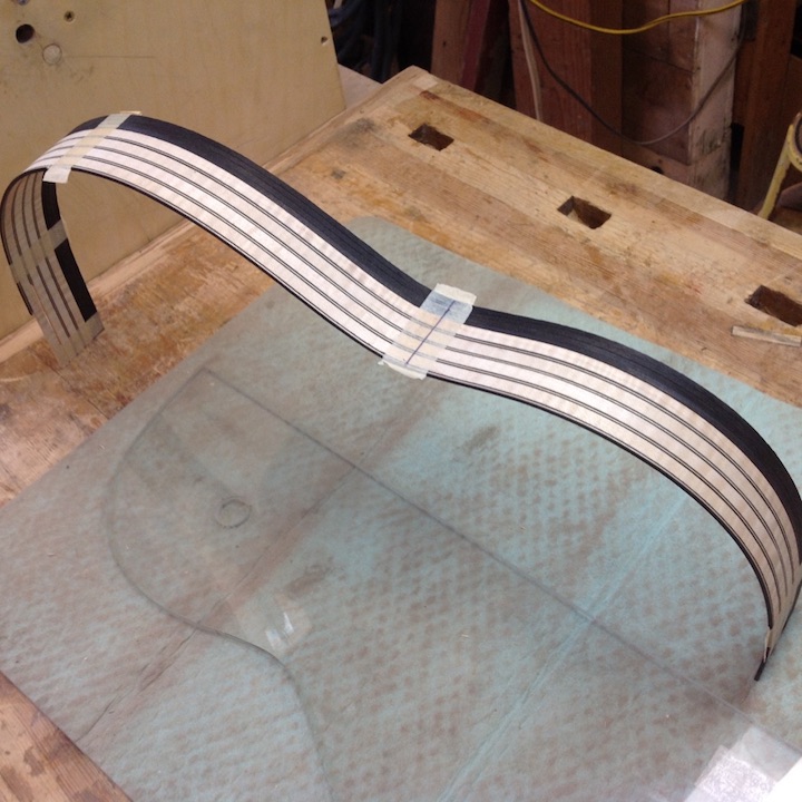

I don’t like CA for this application. I’ve had bleeding of black dyed purflings and rosewood and ebony even after shellac.
So I went to Titebond. But considering that I pre-form my bindings and purflings and still find places where the fit is off… Titebond is hard to fix. Here is a set of purfling and bindings from an earlier guitar that I bent on the Fox side bender. They still have the occaisional kink.
So I went to HHG for this job. I used it once before on linings and the advantages are that 1) it grips in just a few minutes. 2) you can heat it up and redo it as needed (well, within limits). 3) clean up is easy; it doesn’t mar the wood like just about any of the others. 4) it doesn’t cause colors to run.

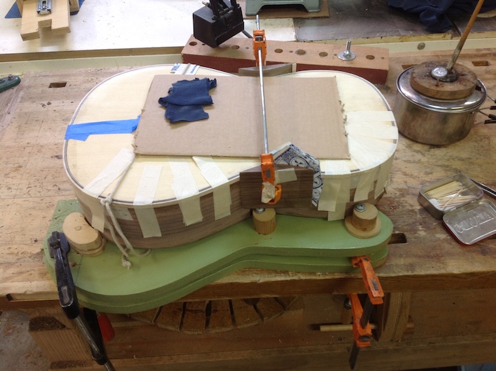

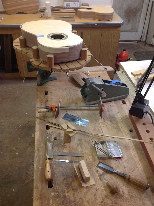

These are most of the tools I use for bindings. There are toothpicks and several dental tools in there. The chisels have mirrored surface for miters. That's a. little hand held miter box in the middle.
When previewed these pictures are arranged in reverse order. They should be self explanatory. If not let me know.

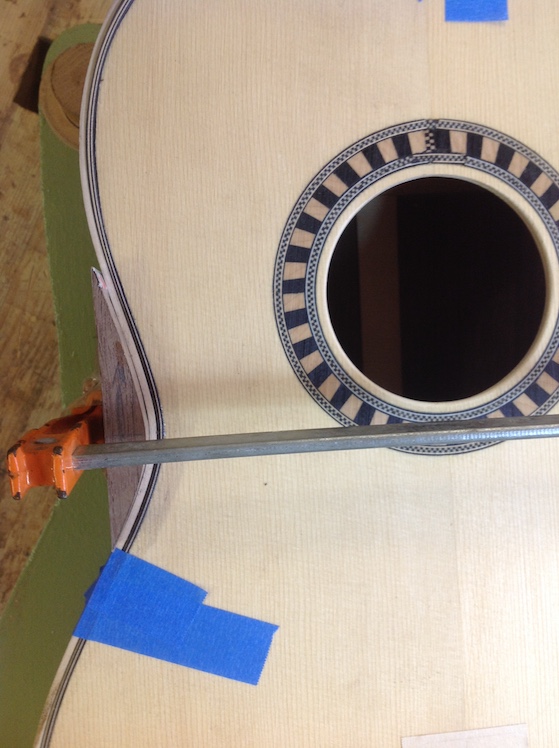

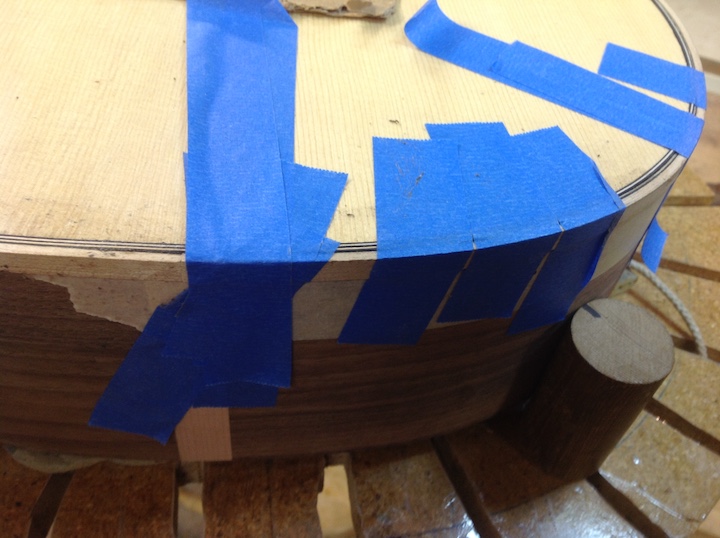

I get one side on then glue up the flatter part of the tail, say 3 inches from the joint, to prevent pulling it apart when tightening it around the lower bout.

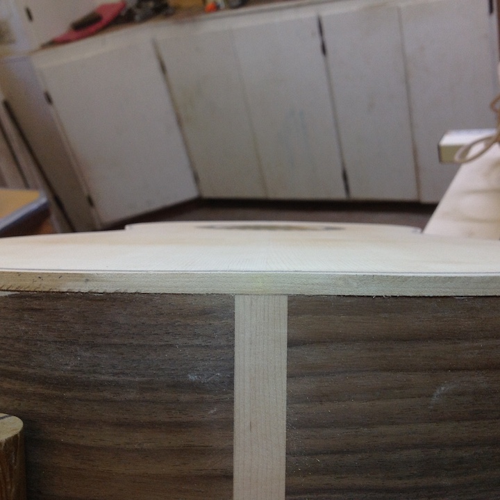

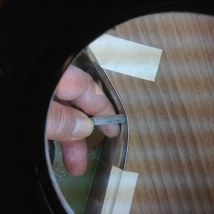

Here you see the type of clean up that seems to take forever.
You can see the ledge in the pic through the magnifier. The problem I think can be traced back to my side sanding technique. I'm putting too much pressure on the edges when sanding the sides and that creates a slight sloping - enough to cause a gap when using a follower bearing 1/2 inch below the cut.
