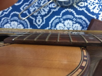

I reduced the x brace to 1/4 x 1/2 at the x. and then quickly thinned to 1/4x 3/8 ". Other areas built lighter also. Bridge 5/16 high.
I realized what I was doing last week as I finished a second parlor sound box.
Notice the gap as the fb/neck meets the body.
Letting it settle in for a week and then I will lower the action a 1/32" or so.
