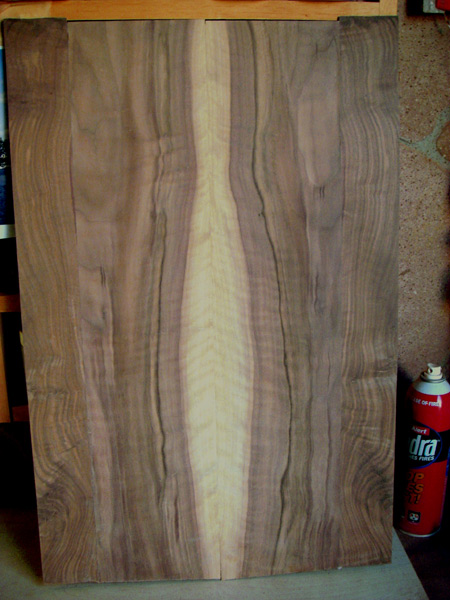

I put my challenge listing in the wrong place, so I am moving it here where it belongs. I plan to make two instruments for this challenge. This one is going to be an OM with a California redwood soundboard, and walnut back and sides. The neck will be a laminate of walnut, and oak. I am using walnut for the fretboard, and bridge as well. Here is a shot of some of my materials.

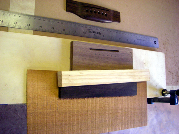

I started with the bridge. I read with interest the thread on using walnut for a bridge in the flat top guitar section of this forum and made my bridge deeper for a better footprint. I think this is a good idea because of the redwood soundboard as well. I think I will dowel the bridge as well. Here I set up a stop to route the saddle slot.

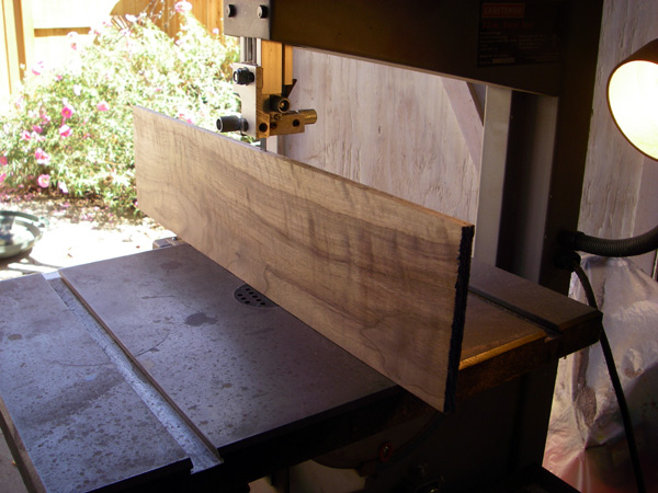

Postby Patrick DeGreve » Sat Apr 07, 2012 10:58 pm
I had a chance to get back to the challenge instruments yesterday. I re-sawed the walnut for the back and sides. I cut the sides about 1/8", and then planed them to .090". I cut the backs a little thicker, so I could plane them down to 1/8".

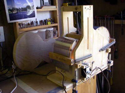

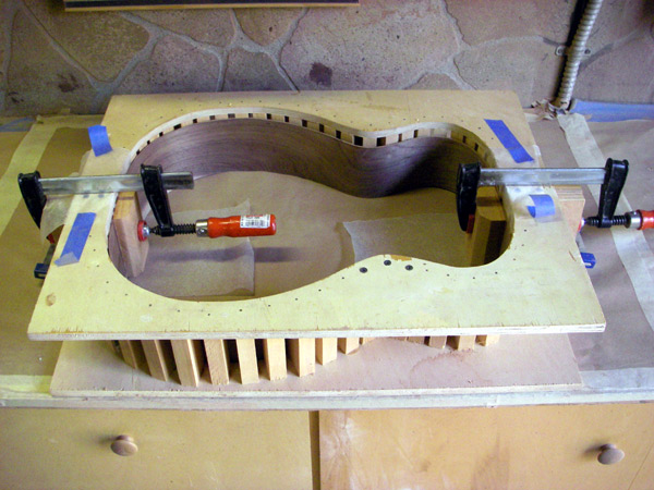

Postby Patrick DeGreve » Sat Apr 07, 2012 11:01 pm
After trimming the sides to their profile shape, I bent them in my fox style bender.

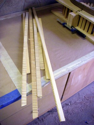

Postby Patrick DeGreve » Sat Apr 07, 2012 11:46 pm
I made some kerfing from a piece of hard pine I pulled out of the trash at work. I work in TV a production shop in Hollywood, and the carpenters throw out pine cut offs all the time. I ripped it down to 1/4" X 3/4 ", routed one side with a round over bit, and cut the kerfing with a stop on my band saw.

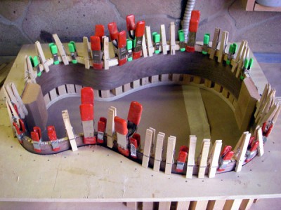

Postby Patrick DeGreve » Sat Apr 07, 2012 11:51 pm
Here I glued on the kerfing. I bought some small spring clamps for this purpose, clothes pins alone just don't have strength.

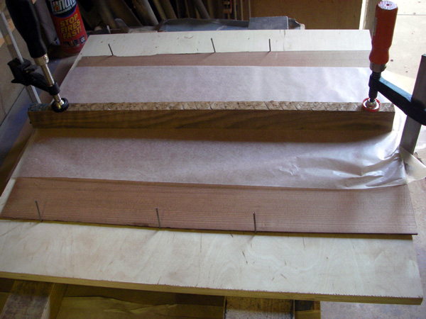

Postby Patrick DeGreve » Sun Apr 08, 2012 9:44 pm
Here I am thicknessing the soundboard. I double faced taped the soundboard to a plywood sled, ran it through the thickness planner. I thicknessed the soundboard to .130". This is just a bit more than spruce would be, because of the redwood.

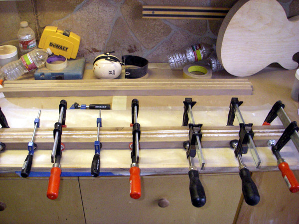

Postby Patrick DeGreve » Sun Apr 08, 2012 10:02 pm
Gluing the soundboard pieces together.

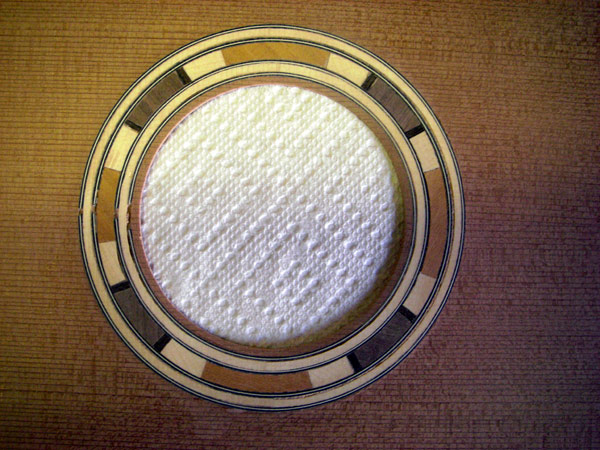

Postby Patrick DeGreve » Sun Apr 08, 2012 10:15 pm
Using Stew-mac's precision routing base, I routed four rings for the purfling strips. I also routed the same rings in pine, walnut, and redwood. I will use the ridges between the rings for inlay material.
Patrick DeGreve
Posts: 308
Re: $100 Local Materials Challenge, California redwood, walnut OM
Postby Patrick DeGreve » Sun Apr 08, 2012 10:18 pm
Here is the finished rosette.

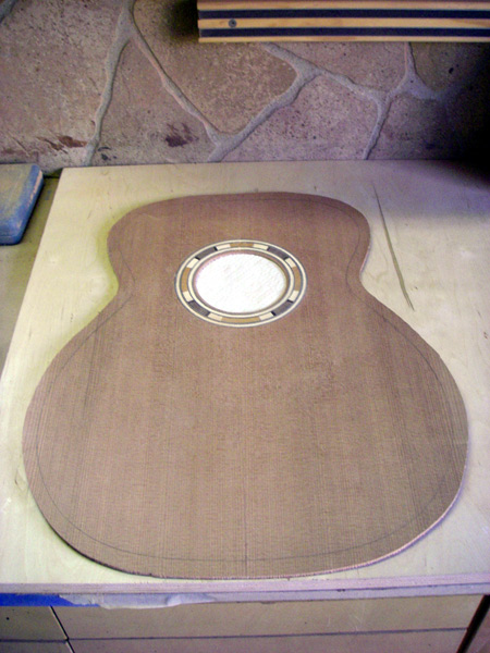

Postby Patrick DeGreve » Sun Apr 08, 2012 10:25 pm
I cut out the soundboard, leaving about 1/2" outside the line.

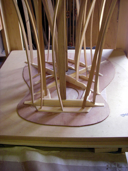

Postby Patrick DeGreve » Sat Apr 14, 2012 11:19 pm
I decided to use the spruce bracing wood that I had, instead of the pine that I was going to use. I just thought that the pine was not stiff enough for the redwood soundboard. I pre-shaped the braces to a 15' radius with a plane, and scraper, and sanded them smooth. Then glued them in place on a radius disk.
Patrick DeGreve
