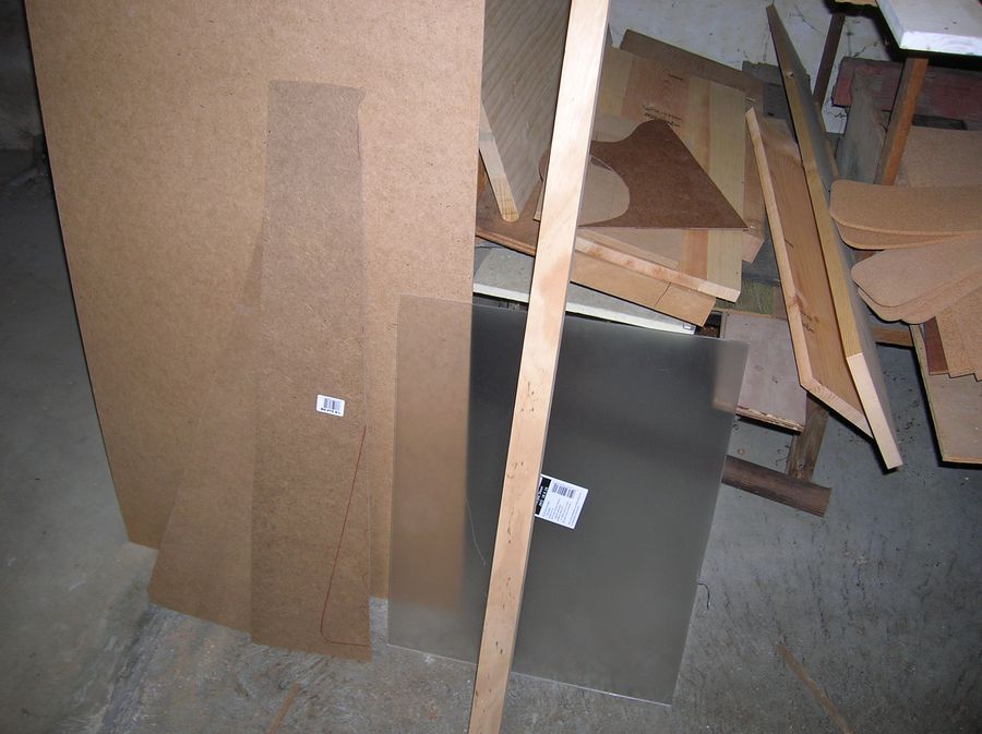

For this challenge I'm going to build a lap steel in the time honered Red Bank NJ style (Danelectro). Since I'm still rercovering from the medical issue that kept me away from the last challenge and I still haven't been cleared to drive, all my materials will come from my pile of stuff here at home.
I have a poplar 1x2, some masonite scraps from a previous build, a sheet of acrylic, and all the guitar parts from will come from my stash.
masonite scraps, poplar, and plastic

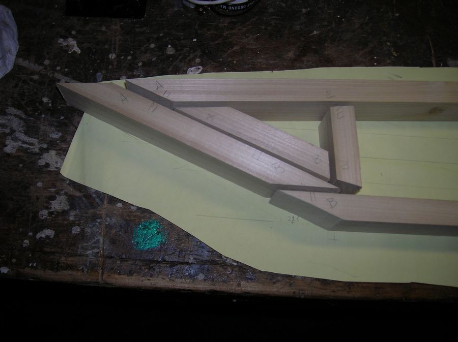

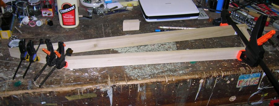

I got started last night and after sketching a plan cut the parts out for the frameand glued it together.
headstock section parts

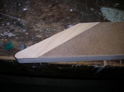

Postby david frassetto » Mon Apr 02, 2012 2:55 pm
Then I glued the puzzle together.

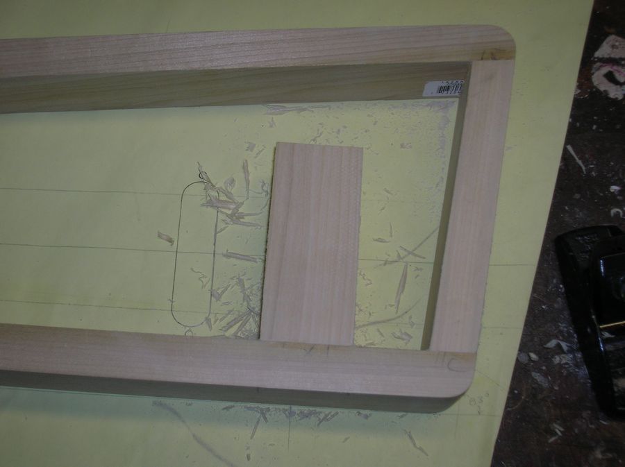

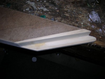

Postby david frassetto » Mon Apr 02, 2012 3:00 pm

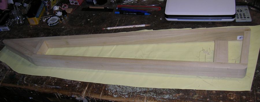

This morning I glued on a block for the bridge to anchor to and cut the excess off and rounded the corners to finish the frame.
finished frame

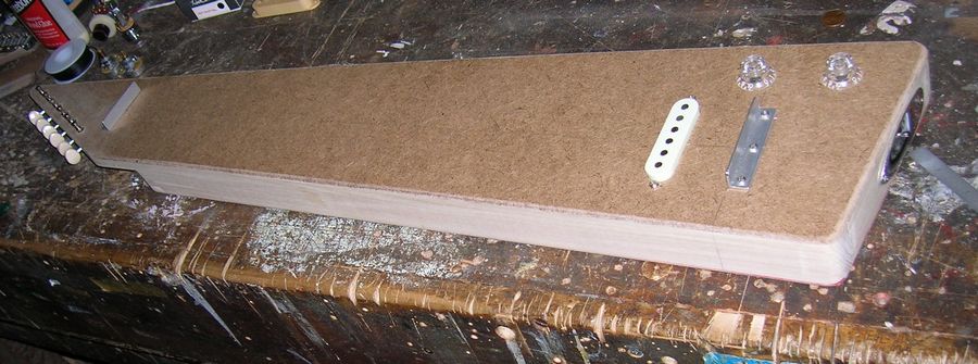

Postby david frassetto » Tue Apr 03, 2012 3:41 pm

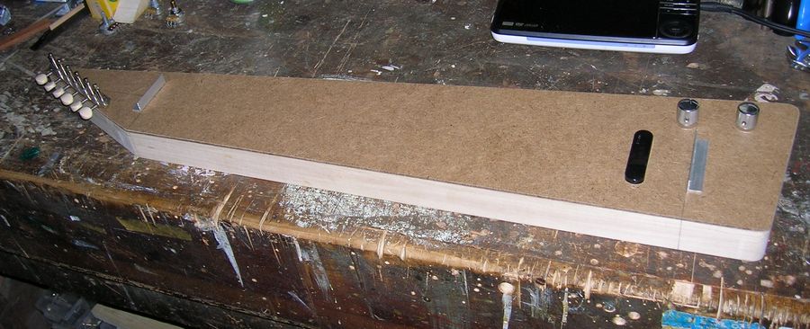

The top plate was glued on yesterday. Then I used a flush trim bit in the router to clean up the edge. I cut the hole for the pickup and drilled the holes for the controls.

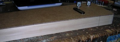

Postby david frassetto » Tue Apr 03, 2012 3:44 pm
I also made the nut and bridge out of 1//2" aluminum angle stock (seen in picture above).

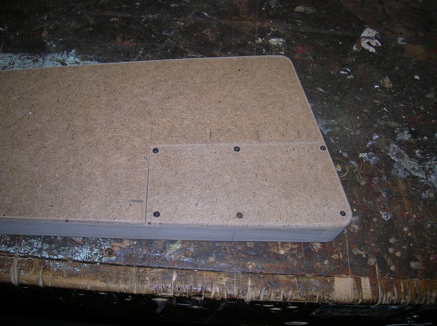

Postby david frassetto » Fri Apr 06, 2012 11:20 pm

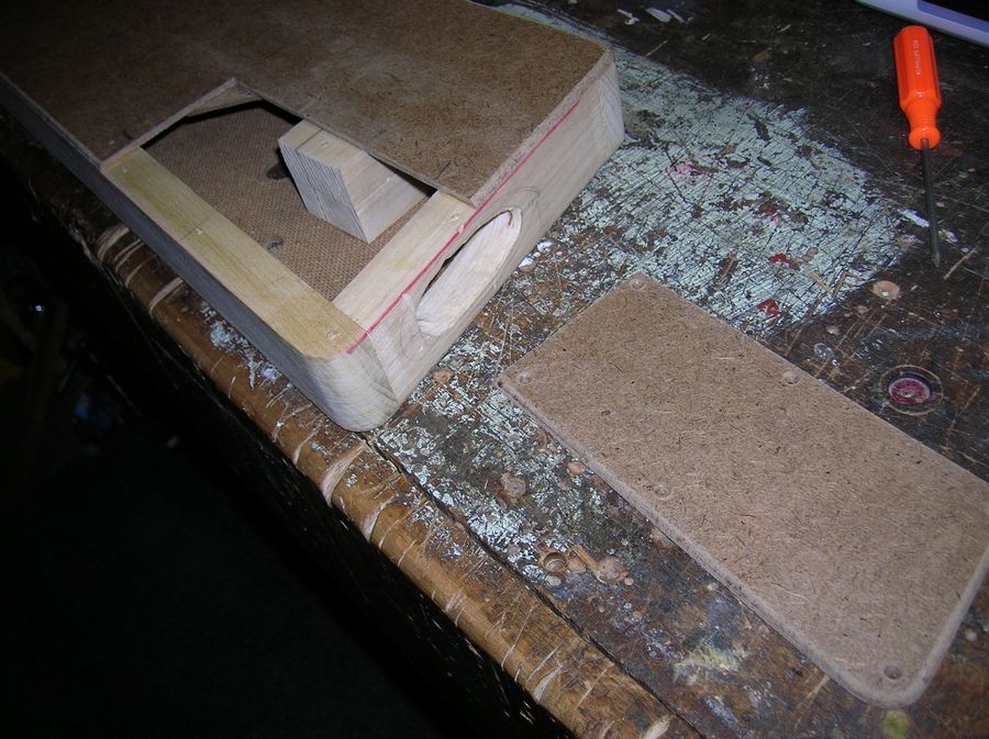

I got the back on and the control cover made. I also cut a hole for a Strat style output jack.
gover on
control cavity, cover off

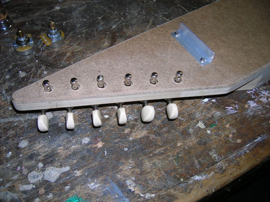

Postby david frassetto » Fri Apr 06, 2012 11:28 pm
And then the first disaster. The fence slipped whuile routing the recess for the tuning machines. So I cleaned it up and routed it down so I could splice in a piece of poplar. After it dried I trimed it flush and reset the fence ( checking it 3 times ) and finished the tuner routing.
poplar patch
finished route

Postby david frassetto » Sat Apr 07, 2012 2:05 pm

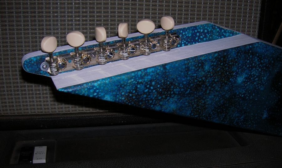

This morning I drilled out the tuning machine holes and the nut and bridge pieces. Checked the fit and alignment. Now it's time for the finish!
tuners
parts test fit

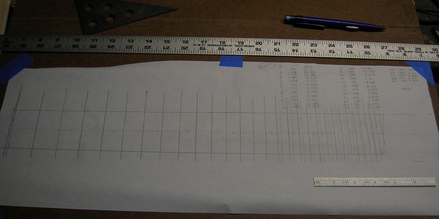

Postby david frassetto » Fri Apr 13, 2012 11:59 pm

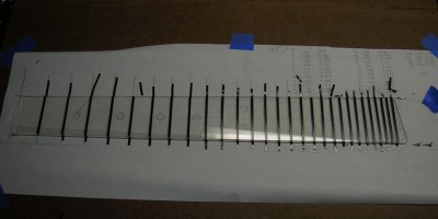

The fingerboard is made out of .090" thick acrylic plastic. After cutting it to shape and smoothing the edges I tape it on top of the plans. I used 3/32" wide pinstripe tape from the auto supply store to create the fret lines. I pull it tight and line it up with the plans visible thgough the board. Then press down and you get a nice straight line. After smoothing it out with with a glass slide I trim off the long ends with an exacto knife. The position markers are dots punched out of the extra piece in the pinstripe kit.
fretboard plans
pin stripe tape frets
Trimmed fingerboad

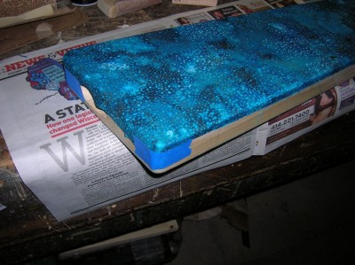

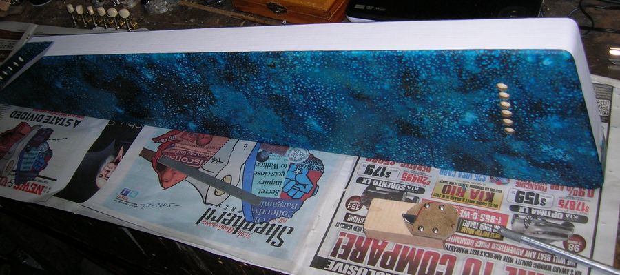

Postby david frassetto » Sat Apr 14, 2012 12:10 am

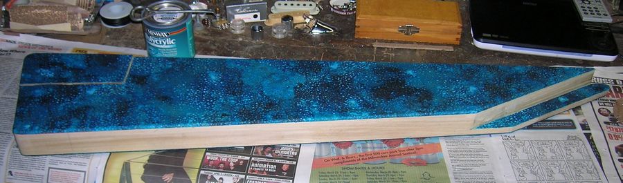

I'm doing another fabric finish on this one. I start by cutting a piece slightly bigger than the face I'm doing. Then I spray both the fabric and the body with a spray adhesive (Duro or 3M super 70)and press the fabric onto the body repositioning it and smoothing out any wrinkles. Tape is sometimes needed to keep the corners tight until the glue dries. Then I set it aside to dry a few hours.
Lap steel fanatic
david frassetto
Posts: 78
Location: Milwaukee WI
Re: $100 local materials challenge, David Frassetto's lapsteel
Postby david frassetto » Sat Apr 14, 2012 12:15 am
After the adhesive dries I give it a good coat of Minwax water based polyurethane. This is left to harden for a few hours. Then the excess is trimmed and a second coat of poly is applied with extra attention paid to sealing the edges. When this dries all the holes are trimmed with an exacto knife and a third coat of polt ic applied.

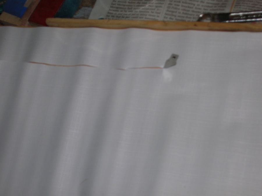

Postby david frassetto » Sat Apr 14, 2012 12:27 am
The body binding is made from a window shade. I've used the same shade I bought for a challenge two years ago (24X60"). I made a slitting jig out of a 1x8 and a strip of trim to use as a fence. I stick an Exacto blade into the 1x8 the distance from the fence to match the width I need and slide the shade along cutting it into strips.
Then I use Loctite Stick and Seal adhesive to glue the strips onto the body. after the glue starts toset up I trim the excesss binding material off and clean up any excess glue. Its water nbased so it cleans off easily.

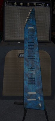

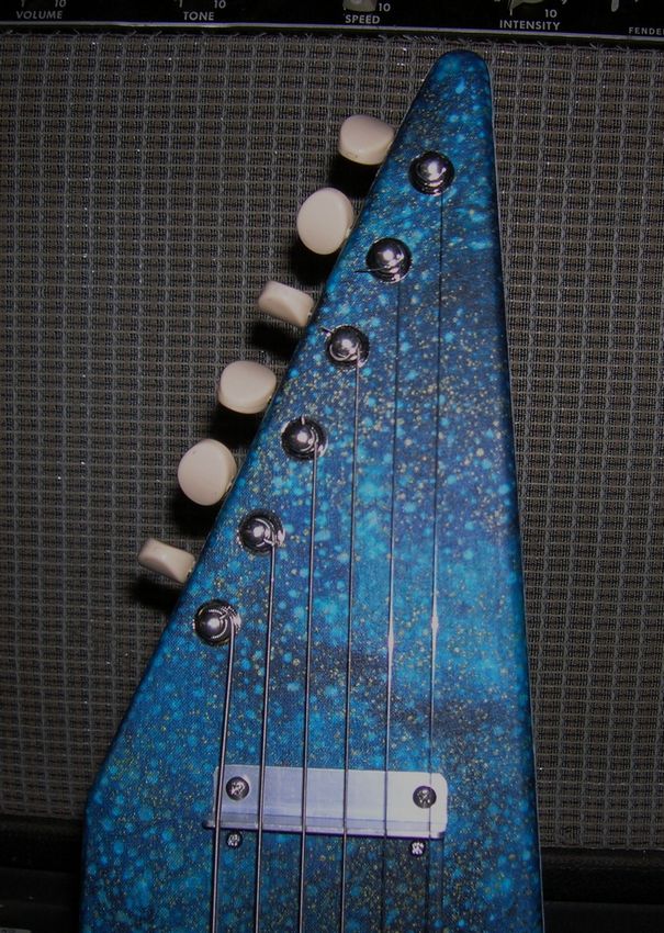

Postby david frassetto » Sat Apr 14, 2012 12:34 am

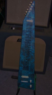

I'm gonna stick a fork in this one cause it's done!
Lap steel fanatic
david frassetto
Posts: 78
Postby david frassetto » Sat Apr 14, 2012 12:37 am

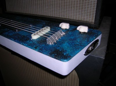

A few more shots
Lap steel fanatic
