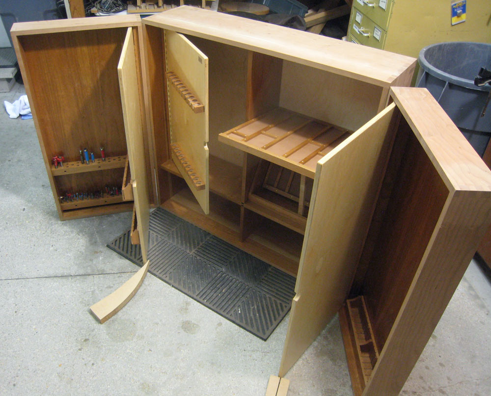

After 10 years of digging through boxes for hours to find where the heck I put a tool, I happened to see a couple articles for building tool cabinets, and decided that was the solution.
I’ve a good friend who is a retired home builder who did all his own cabinetry etc. that has taken me under his wing on this project. Only problem is he thinks things like the dovetails should be hand cut. I gave up after a day of trying and used a jig.

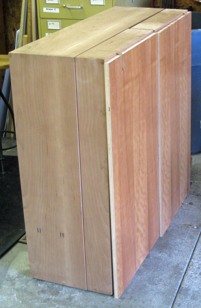

First built a mock up with ½ inch Styrofoam sheet and duct tape. Then built a box, and cut the front off for doors.

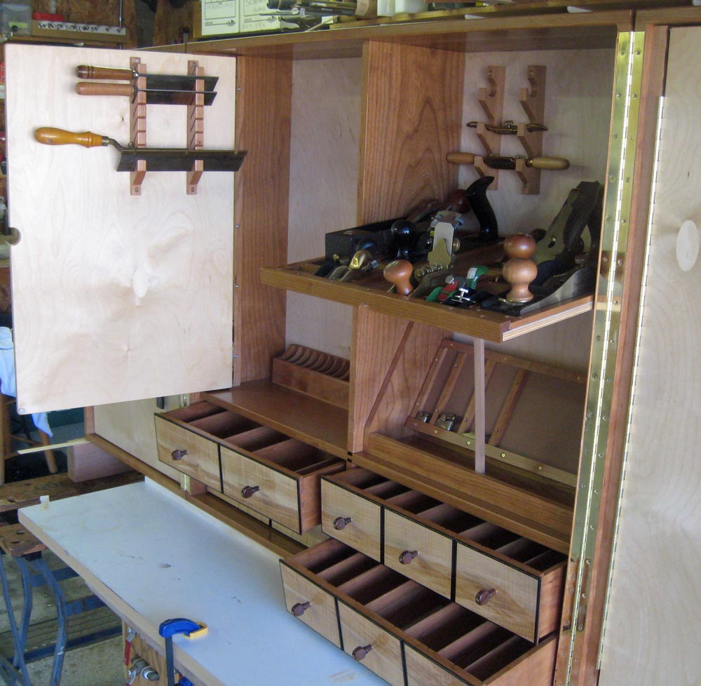

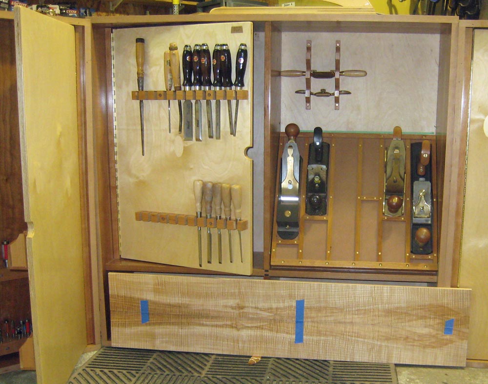

Then started sticking stuff on to get storage space.

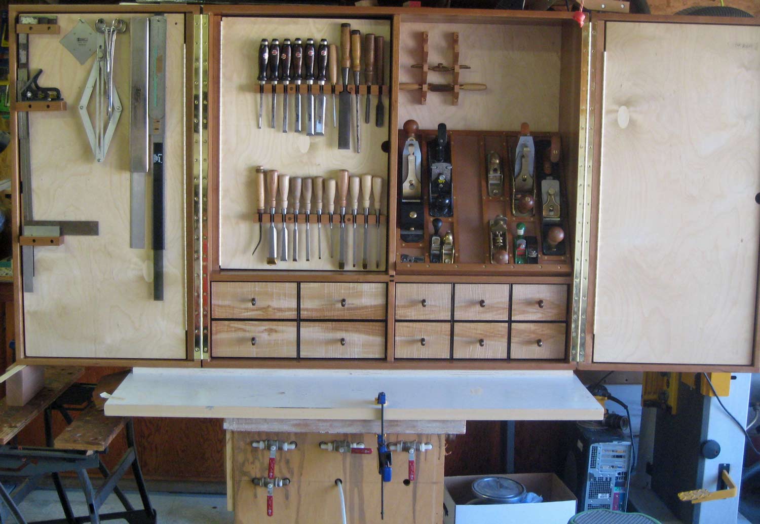

Decided I needed drawers on the bottom.
- Posts: 466
Re: Tool Cabinet – or How to not build a guitar for a year.
And one year later, it’s dawning on me I’ll never be finished with this thing, so I figured if I didn’t post it now I never would. I will be sticking stuff on this thing for ever I think.

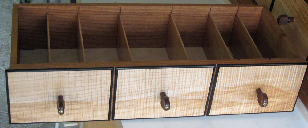

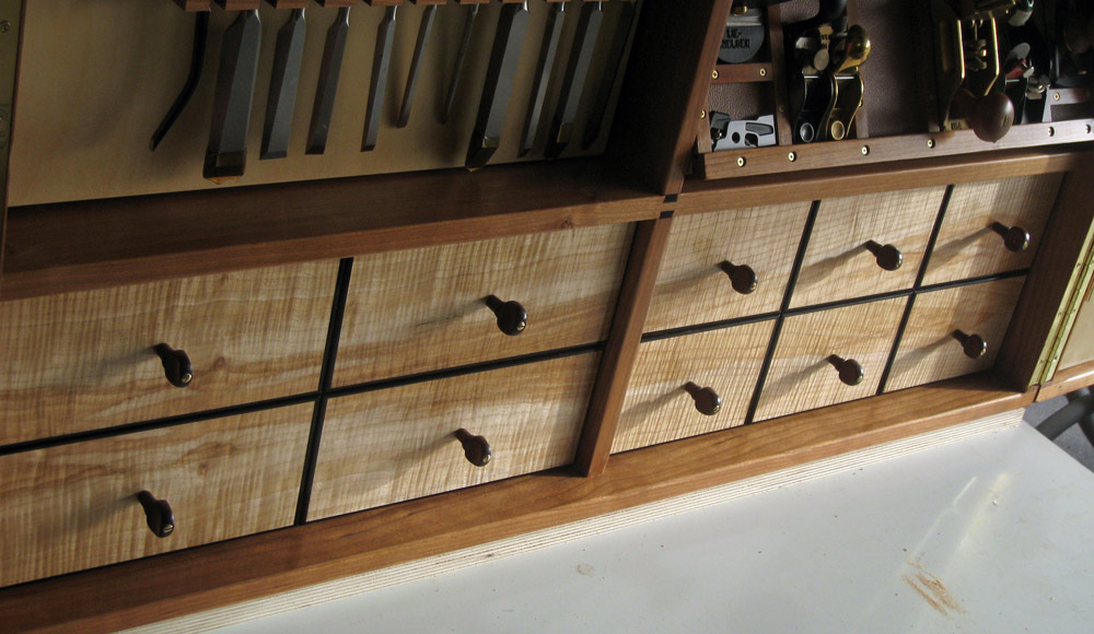

The drawers have dividers to allow different sized spaces. They turned out a little skewed, but by shimming ½ inch aluminum angle iron for holding the drawers I was able to make the fronts line up straight .
- Posts: 466

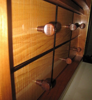

The drawer pulls are old Brazilian rosewood violin tuning pegs. So it won’t be able to leave the country, but at 140 lbs empty, it’s not going anywhere anyway.

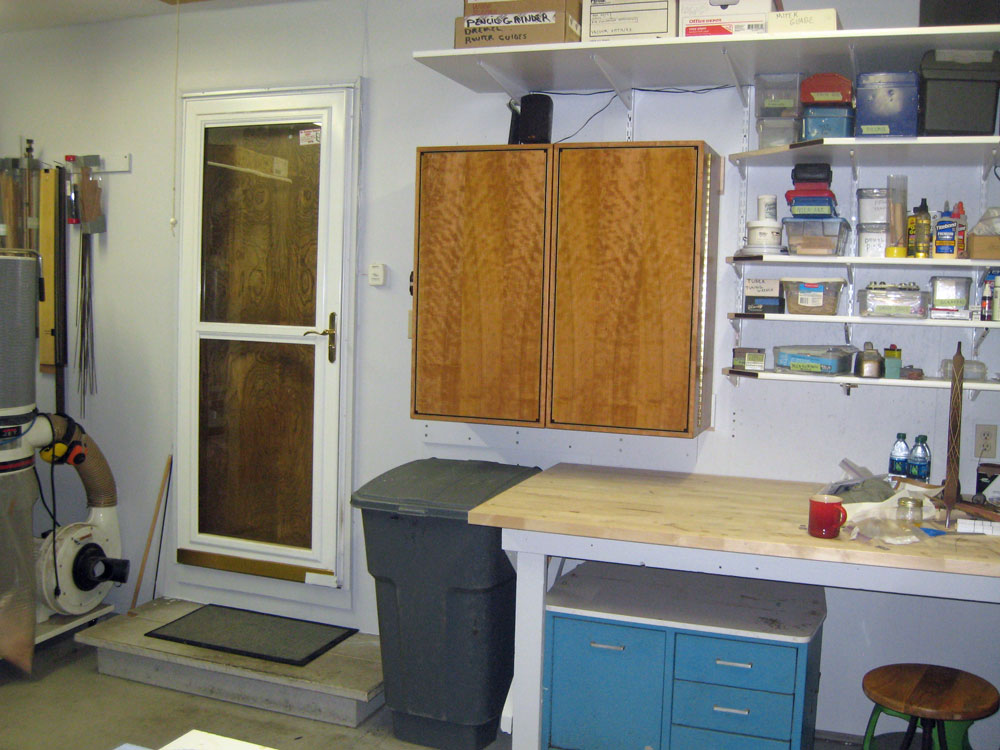

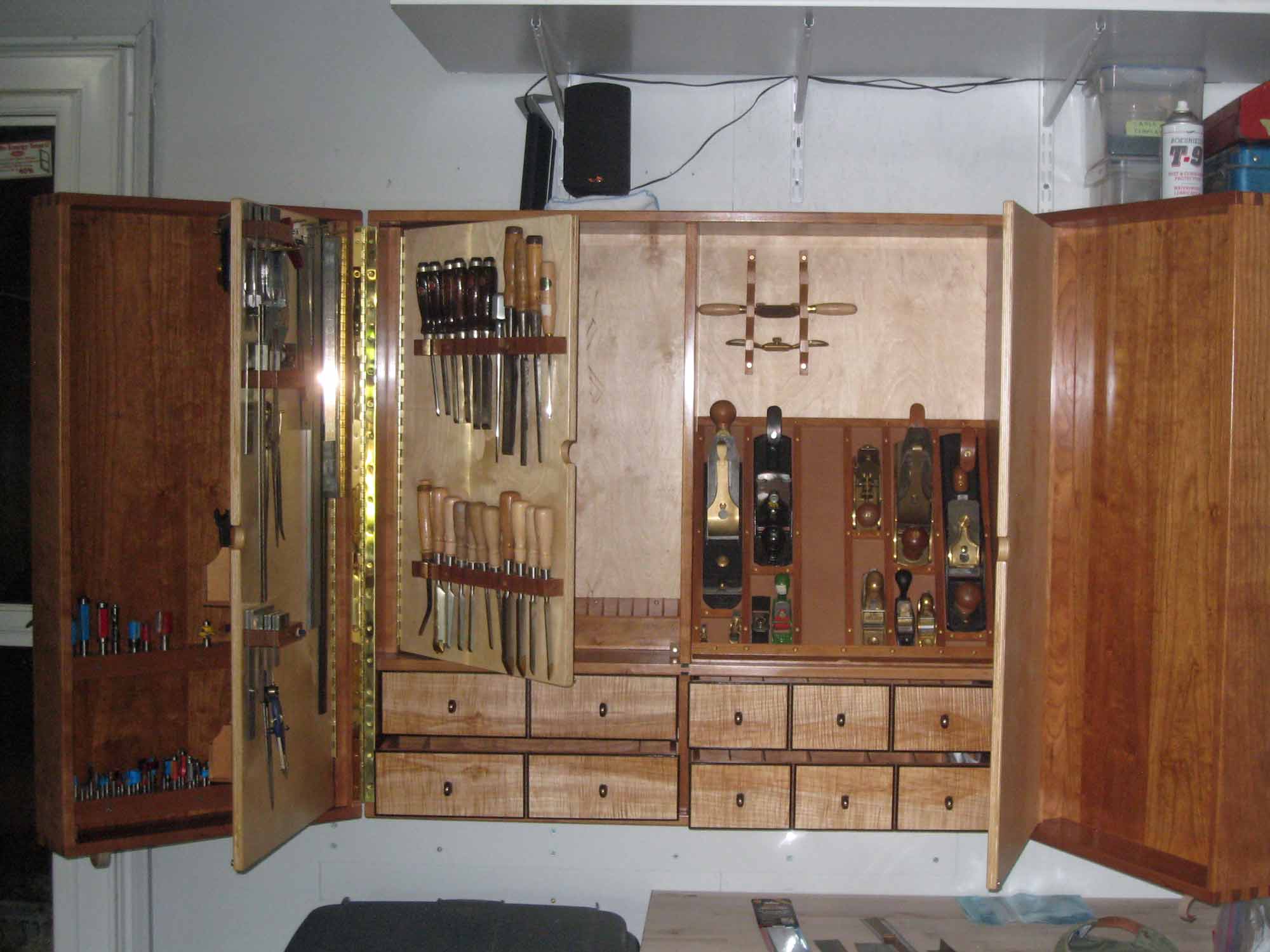

doors finally finished and got the whole thing hung on the wall with French cleats.

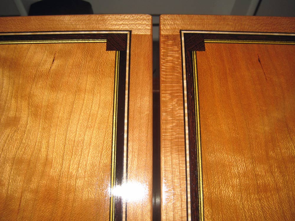

Of course any wooden surface should have a little inlay for good measure...

Now to start searching boxes for tools I haven't seen in a year or more and start loading her up.
