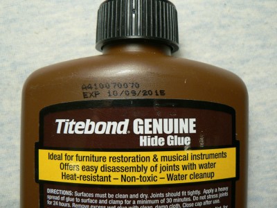

Postby Dave Higham » Thu Dec 21, 2017 2:05 pm
A ‘friend’ asked me to repair this mostrosity for him (an oud, it fell off the wall). I didn’t want to but he insisted, even though I told him it certainly wouldn’t look like new again. In fact, even when new, the workmanship is pretty rough including wood filler where the inlays didn’t fit. The ribs (?) are about .080” thick, butt jointed and the whole of the inside seems to have been painted with a mixture of glue and sawdust to help hold it all together. There are cracks all over the place and, as I don’t use hot hide glue, I thought I’d try to glue one crack at a time using Titebond liquid hide glue so I ordered some on Ebay and it came from Germany (I’m in France). I even received two bottles when I’d only ordered one as Franklin had sold it as a 2-bottle pack. The bottles have a date printed on the back and although it’s not very clear, it looks to me like 2015! So I don’t think I’ll be using it.
I’m now thinking about using fish glue which I’ve used for some time. Any opinions?
If you click on the photos you’ll get a much bigger image.
Dave Higham
Posts: 96
Re: Titebond liquid hide glue
Postby Clay Schaeffer » Thu Dec 21, 2017 6:21 pm
Fish glue sounds reasonable.
I would glue the body cracks first, then glue some small cross braces (as is done for the rose) across the inlay openings to keep them from falling into the bowl.Most of the ouds I've seen are kind of crude, and have very thin tops.
