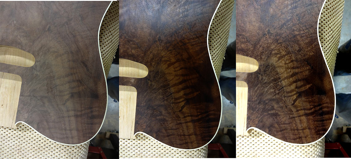

I've made a couple of walnut tops. I noticed when I cleaned with naphtha that when wet, the color was fairly dark and low contrast, as I assume it will be when sprayed with lacquer. However, as the naphtha evaporated, the engrain portions of the figure stayed dark (wet) as the flatgrain portion dried first and lightened up. Is there a way I can incorporate this into the finish, say by sanding back the first lacquer coat, and then applying another coat of a finish that isn't absorbed as well to keep the wood lighter, or possibly bleaching before applying subsequent coats of lacquer? I realize whatever I do will have to be on scrap first.
The pics show dry, wet, and partially evaporated surfaces.

If you have some scrap wood for tests you could try a weak mix of light brown trans tint dye. It will probably darken more anywhere that is end grained. Dye can enhance the figure of some woods without changing the color very much if you can find a good match.

Using dark brown tinted pore filler really brings up the contrast of the grain.

This is my schedule on Walnut:
After sanding up to 150 grit fill the grain with a dark filler. Sand up 320, reapply filler and sand until everything is level. Dye the whole surface with a bright yellow or orange dye. This will neutralize the sapwood and pops the grain later in the process. I use the Transtint water base dye. Dry for a few hours and sand gently w/320 leaving the dye in the curl. Follow with a coat of amber shellac and smooth w/0000 steel wool or grey scrub pad. Apply a dark brown gel stain/glaze and immediately wipe off starting in the center before it dries. Dry overnight. Top coat. Practice this on scrap.

Thanks for your suggestions. The problem is that the dark part of the figure is very dark already (almost black), so I don't think dyeing the wood will help. I need to make the light parts of the figure lighter to increase the contrast. So far I've tried Tru oil, clear and amber shellac, Z-poxy and lacquer. The best so far (marginally) is lacquer - sanding back and re-coating seems to help a little, though I can't explain why - maybe placebo effect. I've still to try polyurethane or a wiping varnish.

That is simply not possible. You can bleach the wood but that will make everything lighter. Any dye, stain, or finish you use will darken the wood overall. You will have to live with the darkness, but most people think walnut is a beautiful wood regardless.Peter Wilcox wrote:The problem is that the dark part of the figure is very dark already (almost black), so I don't think dyeing the wood will help. I need to make the light parts of the figure lighter to increase the contrast.

Unfortunately, I think you are right, Barry. I tried stuff I have on hand - polyurethane, Minwax "tung oil finish" (not tung oil, I know - apparently a wiping varnish), KTM9 after dark dye and sanding back, to see if waterbase would leave it lighter, and even soaked it in 3% H2O2 overnight - really no difference in any of them regarding contrast.
So I guess it's going to be grain fill with Zpoxy and spray nitrocellulose lacquer clear coats as the easiest way with the best result I know of - it will look nice anyway, even if dark. They're not ready for finish yet anyway, and I'll have to wait for spring weather since I have to do it outside. Thanks for everybody's suggestions.

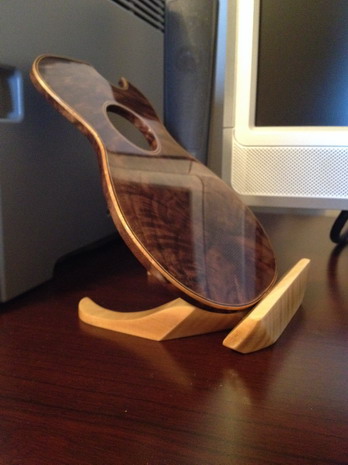

I'll apologize in advance for this not being a guitar, but it's guitar shaped...
This is Walnut crotch finished in Nitrocellulose lacquer but the wood was scraped, not sanded. There is no dye or stain. I think the contrast is pretty decent on this although it shows up better in person than these photos indicate. I just made this a couple of months ago.

That is a lovely finish. I guess I'll go out and scrape some scrap to see if that helps.

Scraping gave me the same results as sanding. I just have very dark wood.David Falkner wrote:This is Walnut crotch finished in Nitrocellulose lacquer but the wood was scraped, not sanded.
